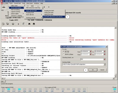

Very probably you could recover the NV-Ram from SA. Please try to use donor's board and launch "Nv-ram adjustment" command with default values.
See my screenshot attached.

No tanks. i solved problem to read NVR from SA. Thank you the same. Bye :)
