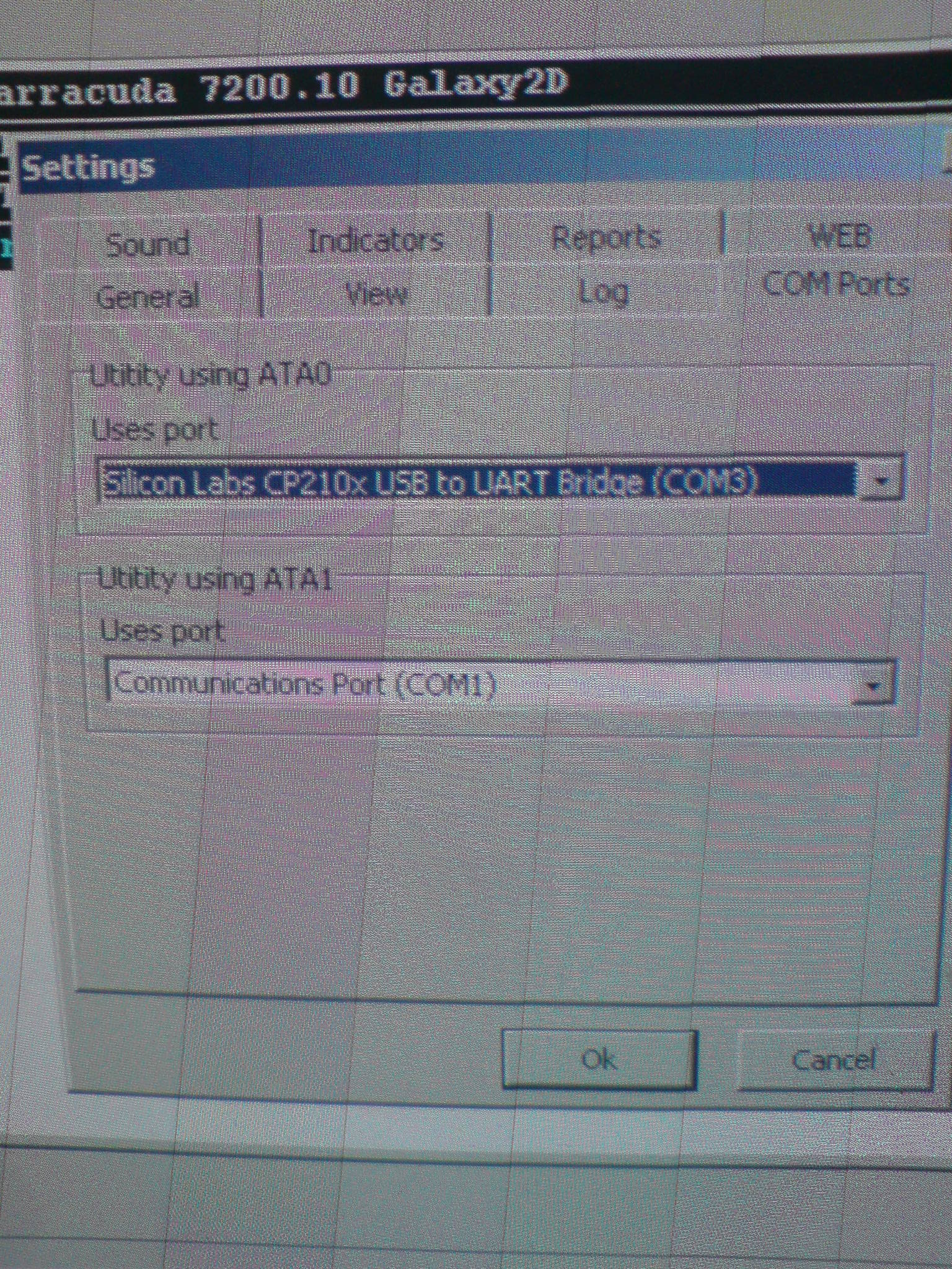

my seting :

You should set CP210 to both ATA0 and ATA1. If other utility that use terminal is open on other channel, like samsung or seagate, terminal will not work. Try other disk also to be sure.

Thanks for your reply AJ, but I do not know what that is damaged from the terminal card or from the software.i test results were the same use another hdd
