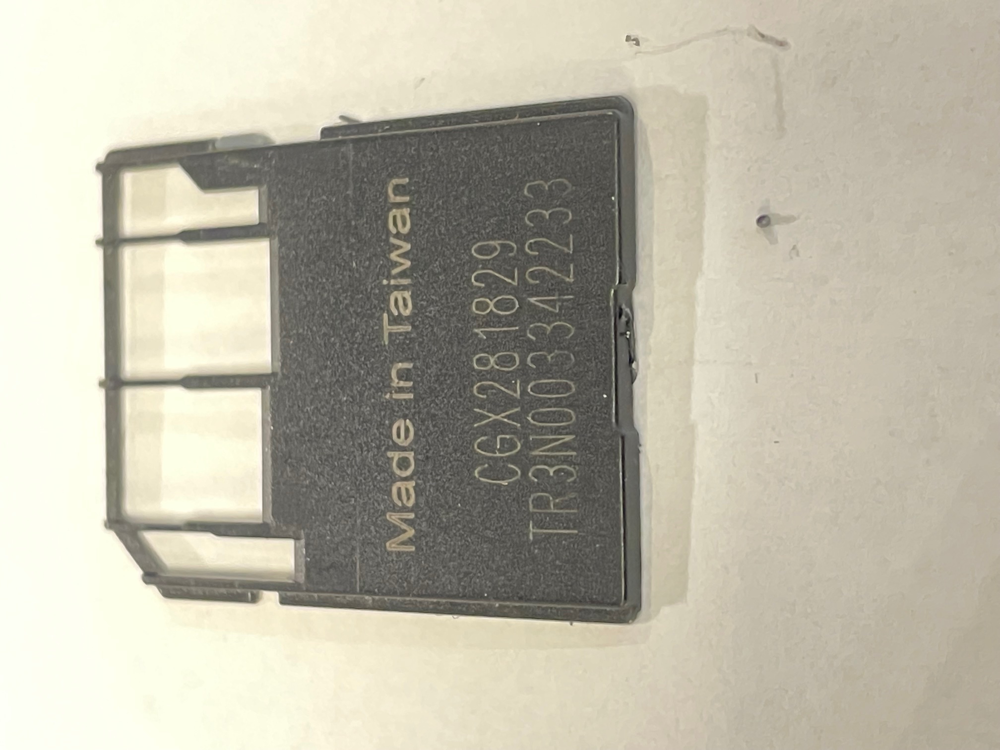

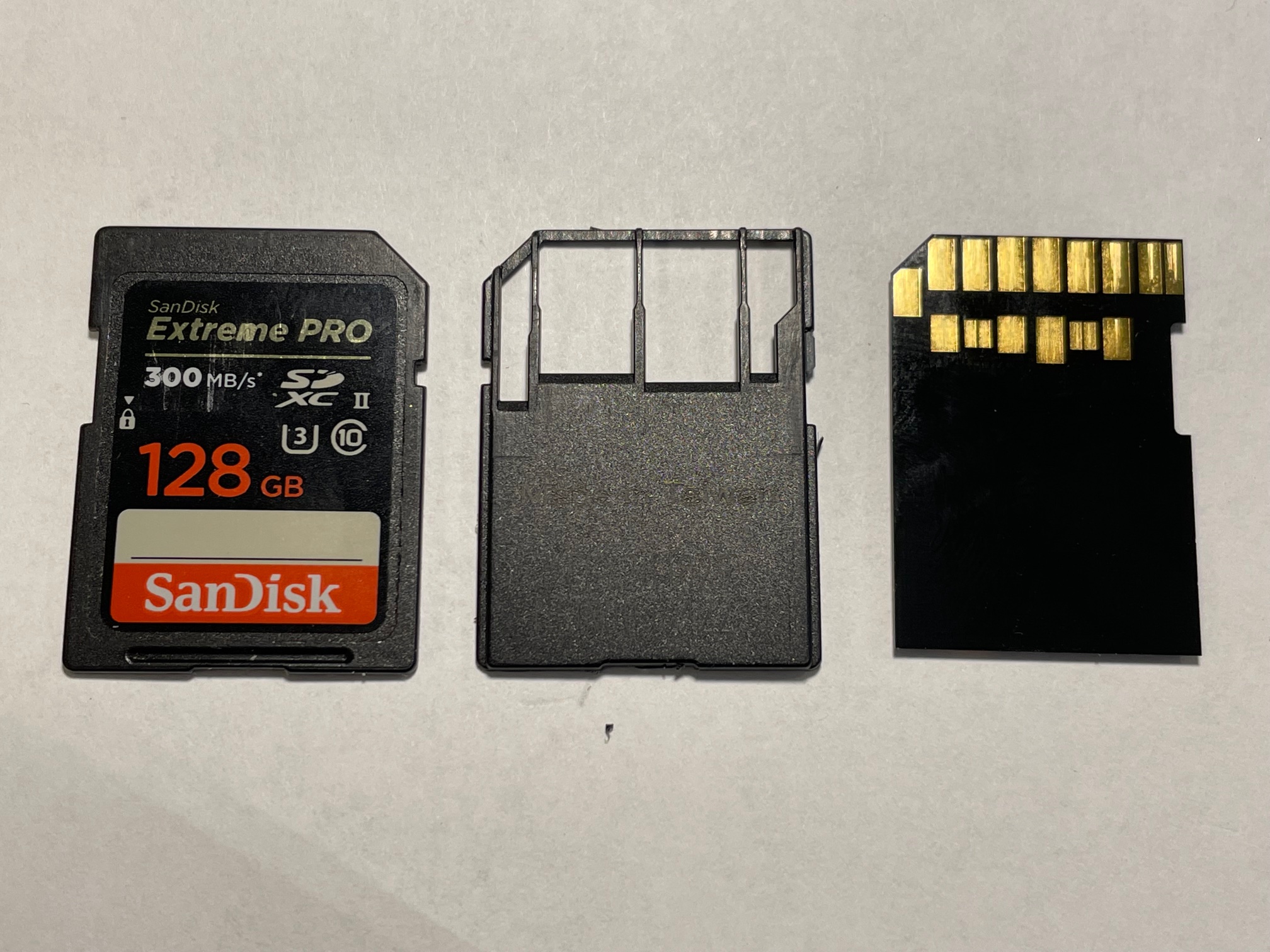

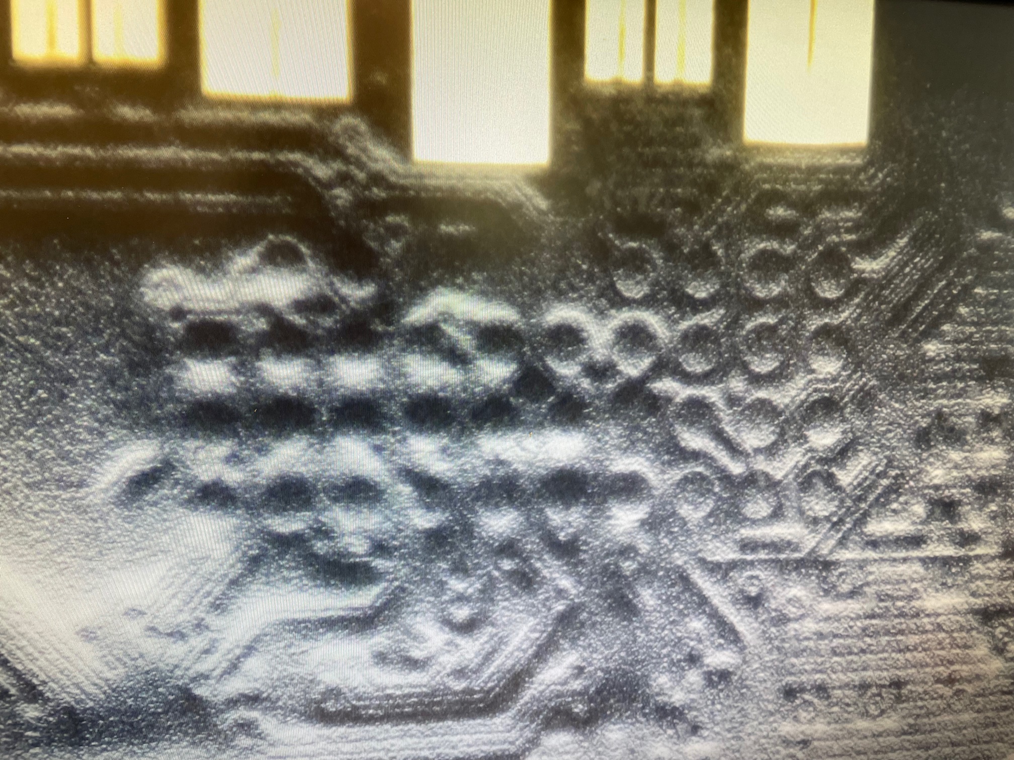

Does anyone know pinout for a Sandisk Extreme Pro SDXC II 128 GB. Unfortunately it is not supported by PC-3000.
Also, if someone does; do you also know the internal structure - if it can be solved in PC3K after dump is read.
Attached is some pictures. I have not sanded the card yet (in case I can't proceed with the card), but the connectors can be seen through the coating.

Thanks. Do you know pinout, and if it can be solved with PC3K?
-Espen
arvika
Posts: 84
Joined: 14.10.09
Re: Pinout Sandisk Extreme Pro SDXC II 128 GB
Postby arvika » 18.08.21, 20:09
Yes I have. I do not know if it possible solve by PC3K.
Multi-COM
Posts: 26
Joined: 19.04.17
Reputation: 1 / (14)
Postby Multi-COM » 18.08.21, 21:52
This pinout is supported by MR SP09 adapter - https://multi-recovery.com/subpages/MRSP09.php
