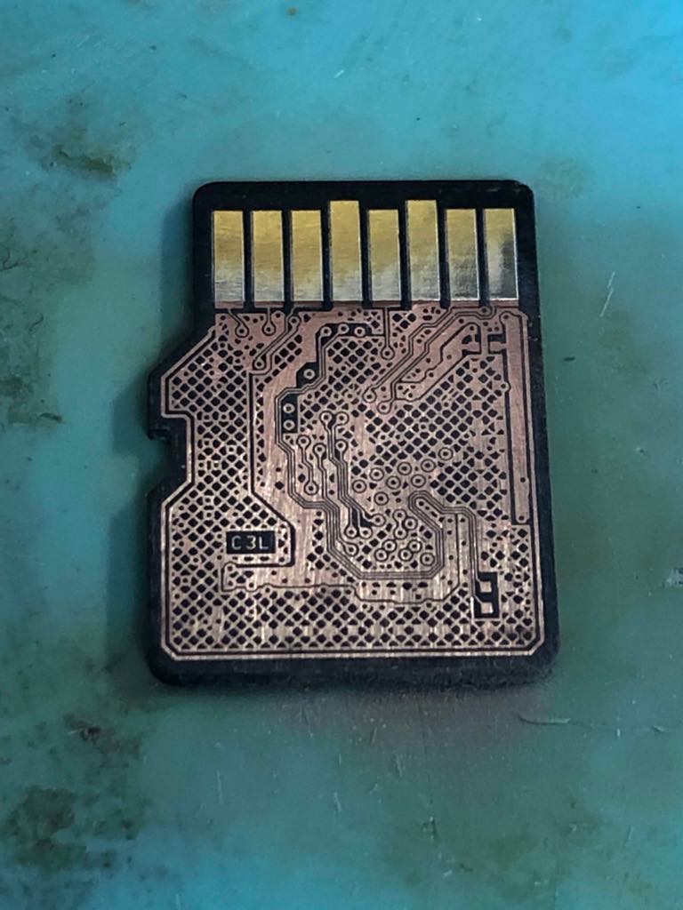

I can't find the points of this samsung 32gb

We have this pinout, but recovery of this mSD is impossible due the adaptive XOR. Even if you will read it, complete recovery will be impossible.

can I have it? I want to do cross-tests with other tools

Nobody can beat this adaptive XOR, even other tools ;) But you can PM me, I will reply you in next Monday.

@codice pin: Those Samsung cards uses a cipher with a rotating key which is based on LBA so as Roman write you will not recover data from it unless you will get correct key from Samsung.

I trust what you tell me, I still wanted to dump and try, but I can't find the right points and apparently nobody has them

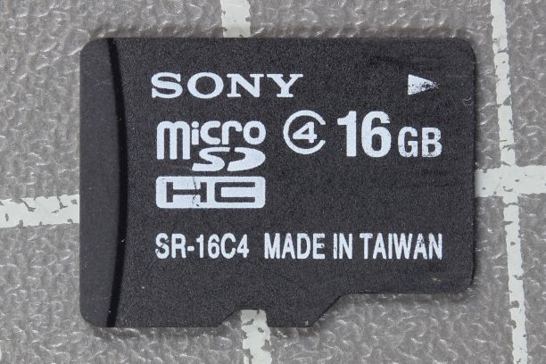

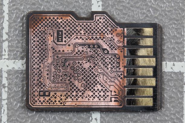

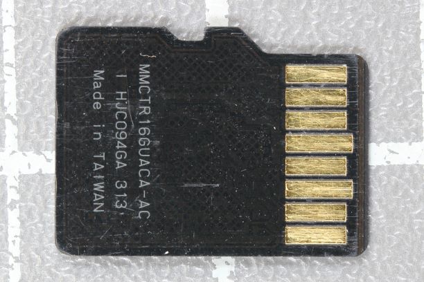

I got a Sony mSD with the same layout. Do you know if they also use an adaptive XOR, or could a recovery be possible?
