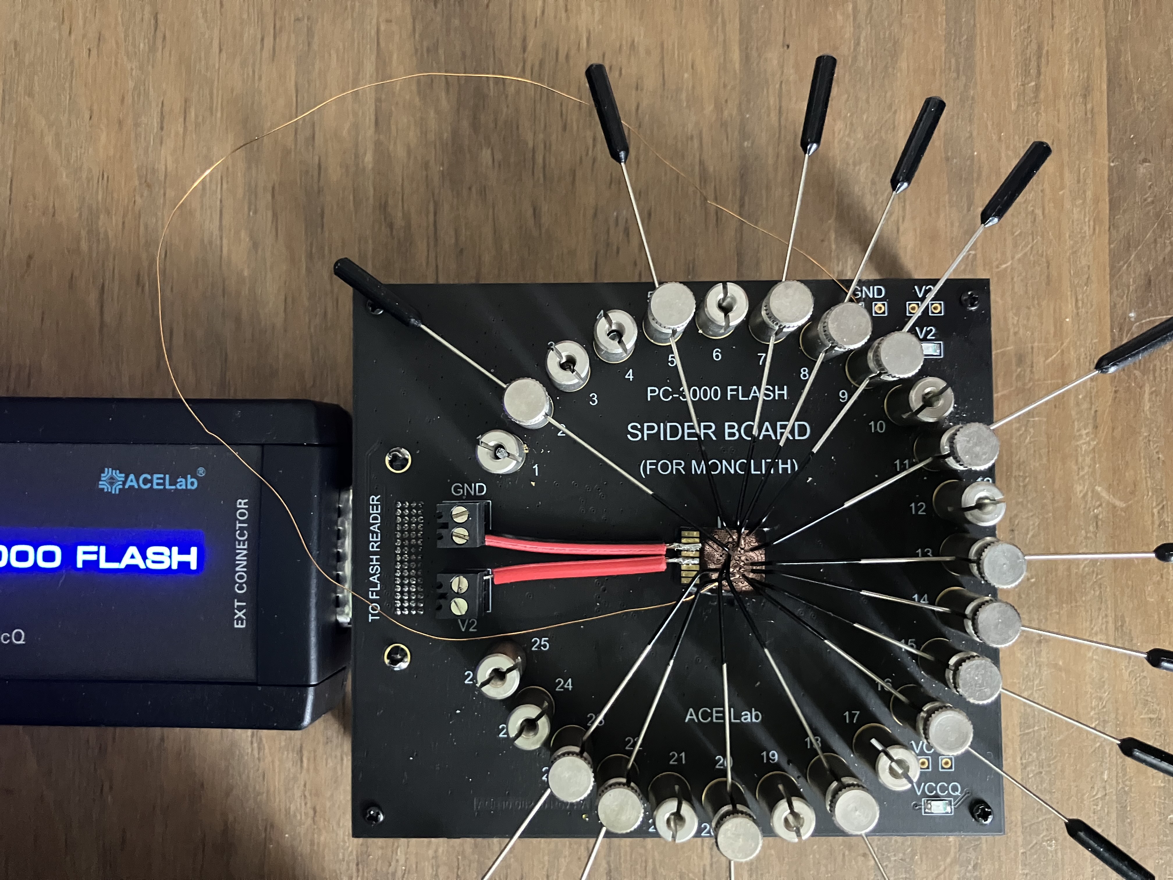

Hi All...
At the "Read Chip ID" stage, I had the same "R/B Fail" error on a SanDisk 2GB mSD (type 4 monolith) - This was my very first attempt at monolith recovery...!!
...I tried what Roman suggested, soldering 0.2mm wire from GND on spider to pin A1.... and it worked!!
