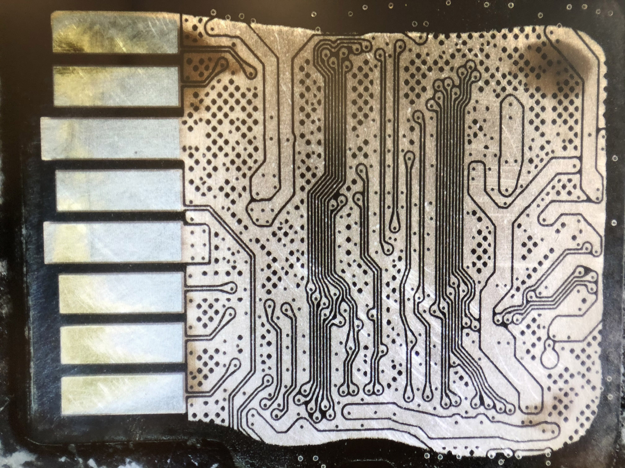

Anyone know type and pinout for this card?

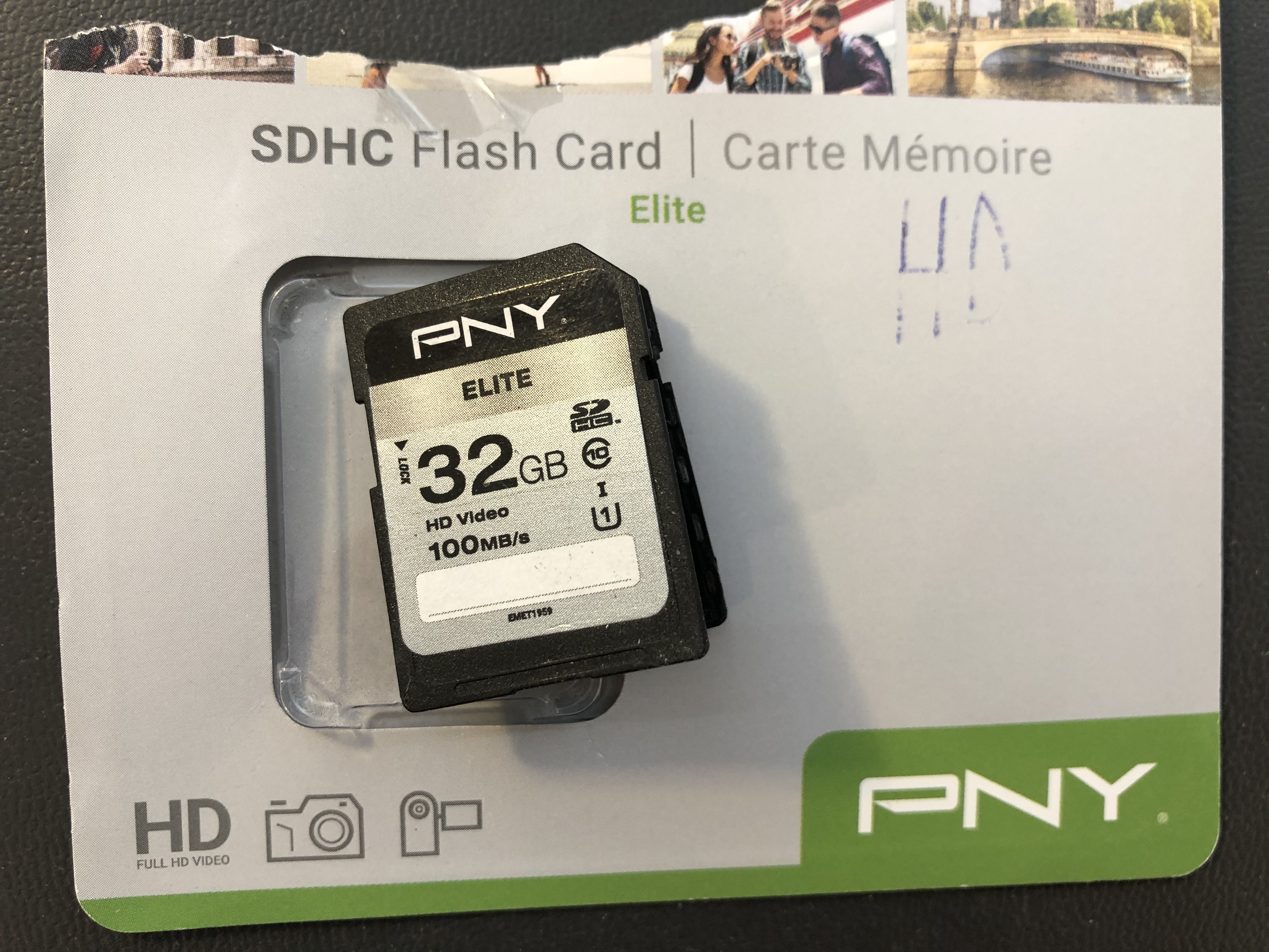

It's a micro SD card inside a 32 GB PNY SDHC SD card.
Couldn't find it in the monolith database
-Espen

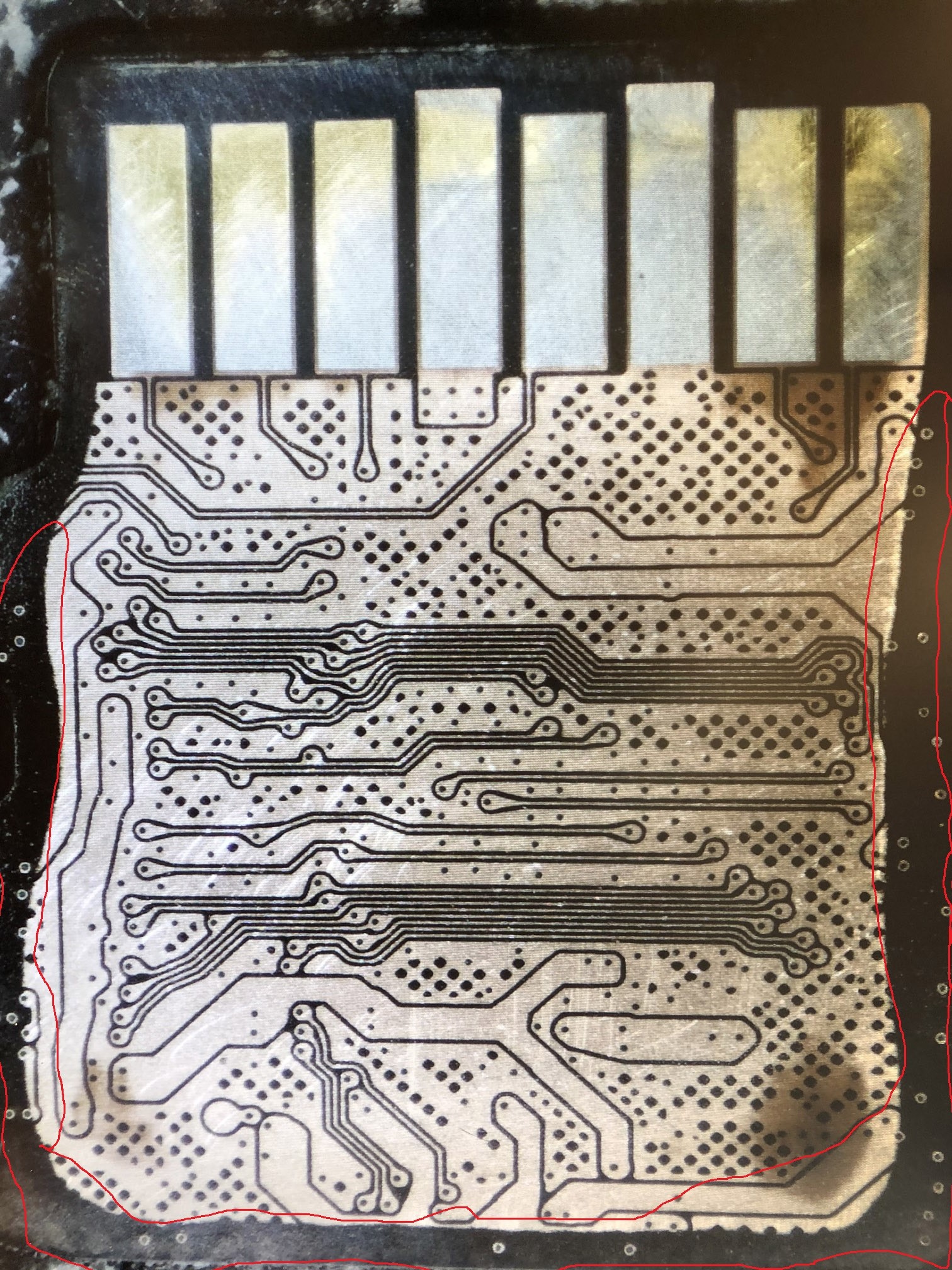

Did you see how damaged the traces are? I doubt that correct pinout will help here. Card needs to be fixed first.

@SGdata Please explain, where do you see damaged traces?

here

@SGdata Ok, I just haven't sanded all the way out before taking the picture.

Looks like you sanded too much :)

SGdata wrote:Source of the post here
As the OP says, this is just where the conformal coating has not been removed.

Doubt it, look at the pins. But it would be good for the data that i was wrong.

http://odzyskiwanie-danych.com.pl/image ... arvika.jpg
SGdata, there is no important signals.
edbrandt, we have pinout if you want outsource the case.

@arvika I was thinking you might have :) I'll send you a PM. Thanks

@edbrandt: This card is very popular ... we got adpater for it - check at https://multi-recovery.com/subpages/MRV04.php
