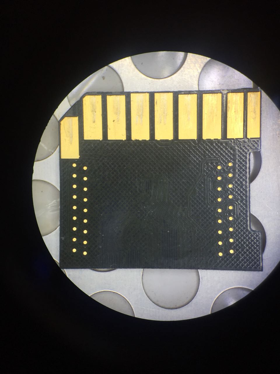

Can you pls tell me which layout i need to take in pc3000 solution center i guess type 2 but my card 9 pins a row .
Pavan

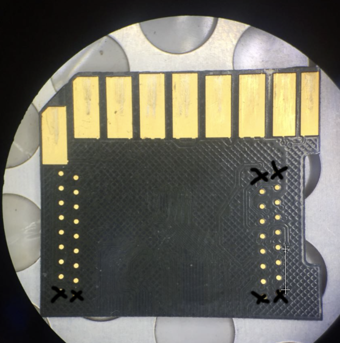

I think on left column : forget the last 2 pins:count from above 8
on right column: forget the first and last 2 pins: count starts from second line
alternate, when this not work I can send you an alternate pin layout
good luck
