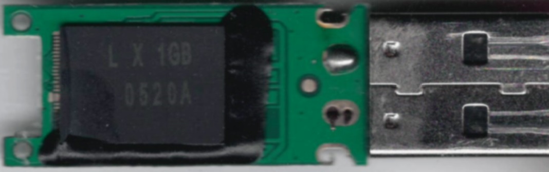

Hello Guys,
Does anyone have tips to unsoldered this memory nand ?
Many thanks
Alain

I would rather solder it from the controller side.

Flash wrote:Source of the post
Hello Guys,
Can you show a good quality picture of the other side of the PCB.

It could be eMMC with switched off internal
Better to check the controller name and try to use Spider to read the NAND via controller pads:
https://blog.acelab.eu.com/pc-3000-flas ... emory.html

Thanks guy and Roman,
The controler is CHIPBANK CBM2098S
Many thanks
