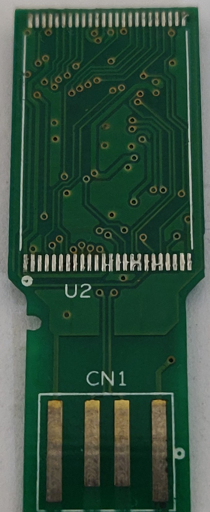

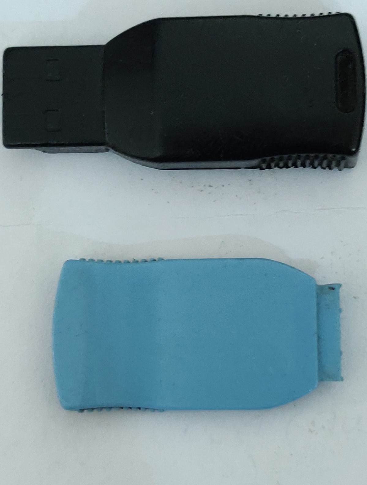

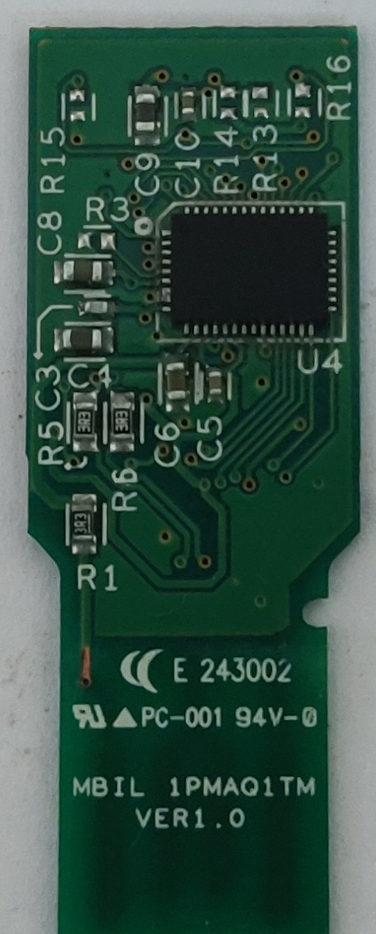

I have This Exact Case Now in My Hand ,Would Share Photos And Dump If You Guys Wanna Check This Out ,These Are The Details
MCU : MB GL825CL
PCB : MBIL 1PMAQ1TM Ver 1.0
NAND : Dynet D27UCG8T2ATR 64GB
NAND Details : 1x1 ADDE94DA 74C4ADDE, part size=8192Mb, page size=8832 bytes, block size=256 pages
Re: WHICH CONTROLLER MATCHES -SONY8GB
Postby Amarbir[CDR-Labs] » 23.06.21, 10:09
Roman ,
I will be adding some pictures i took to this thread today
CDRLabs Datarecovery - MB GL825CL Genesis Logic MCU 8GB Pendrive Photo Outer Side.jpg
CDRLabs Datarecovery - MB GL825CL Genesis Logic MCU 8GB Pendrive Photo Outer Side.jpg (256.1 KiB) Viewed 160275 times
CDRLabs Datarecovery - MB GL825CL Genesis Logic MCU 8GB Pendrive Photo NAND Side.jpg
CDRLabs Datarecovery - MB GL825CL Genesis Logic MCU 8GB Pendrive Photo NAND Side.jpg (220.98 KiB) Viewed 160275 times
CDRLabs Datarecovery - MB GL825CL Genesis Logic MCU 8GB Pendrive Photo.jpg (154.28 KiB) Viewed 160275 times
