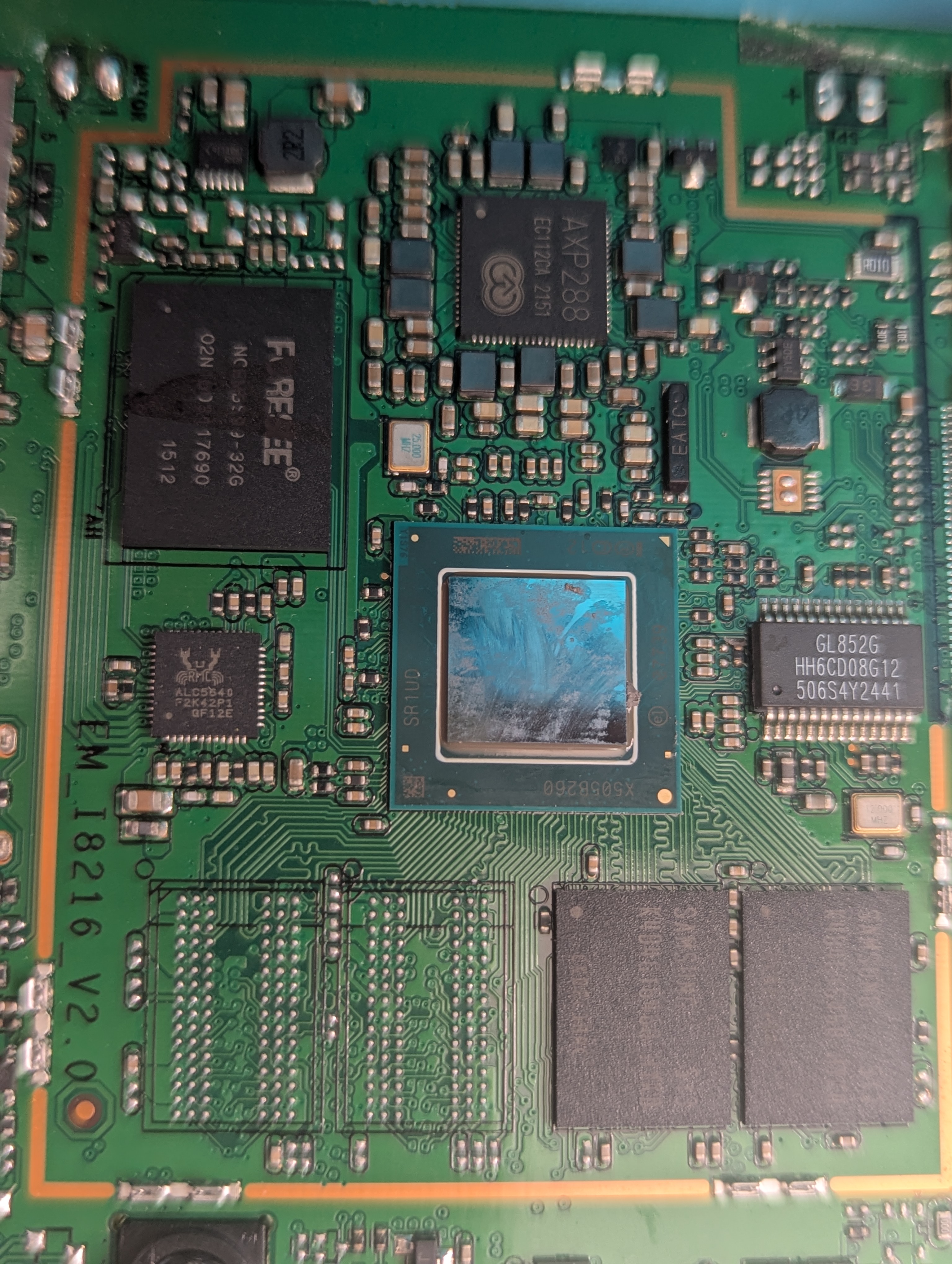

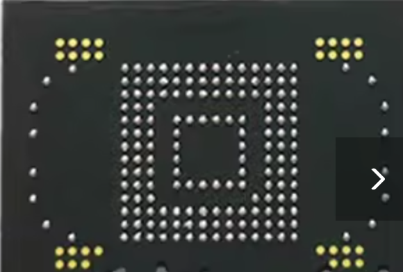

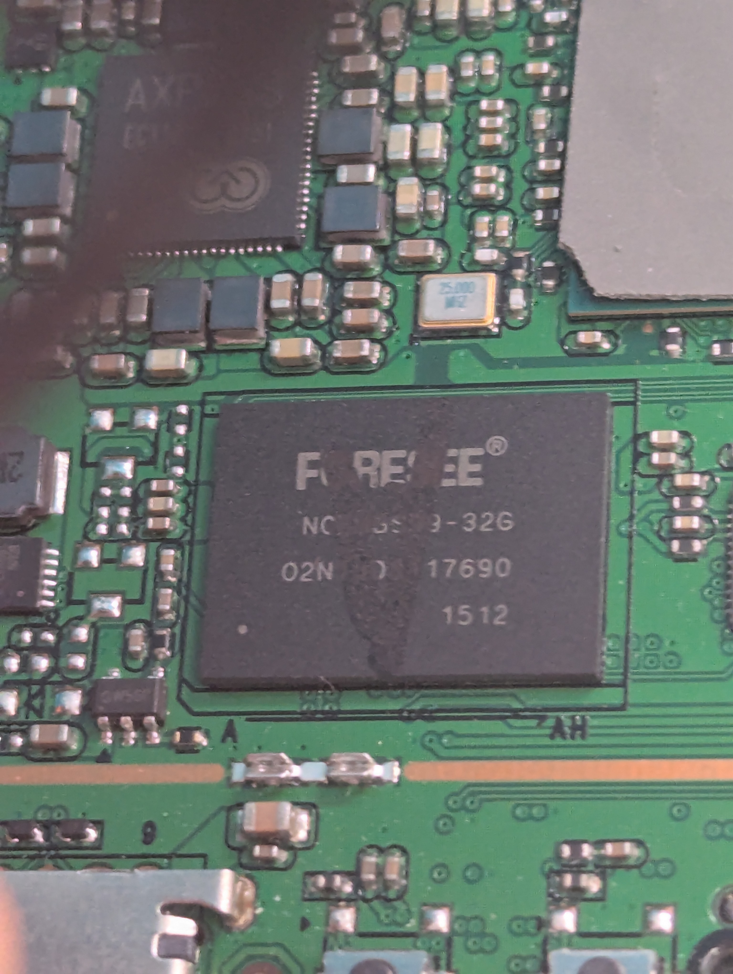

We have a NAND:
Foresee ncembs99-32g
02n1503117690
Which is an eMMC BGA chip. The controller is from an Intel Atom based processor which is built-in.
Is there any support with PC-3000 Flash for this NAND? (I have pictures attached).
Thank you

Pc-3000 flash dont have reader emmc bga

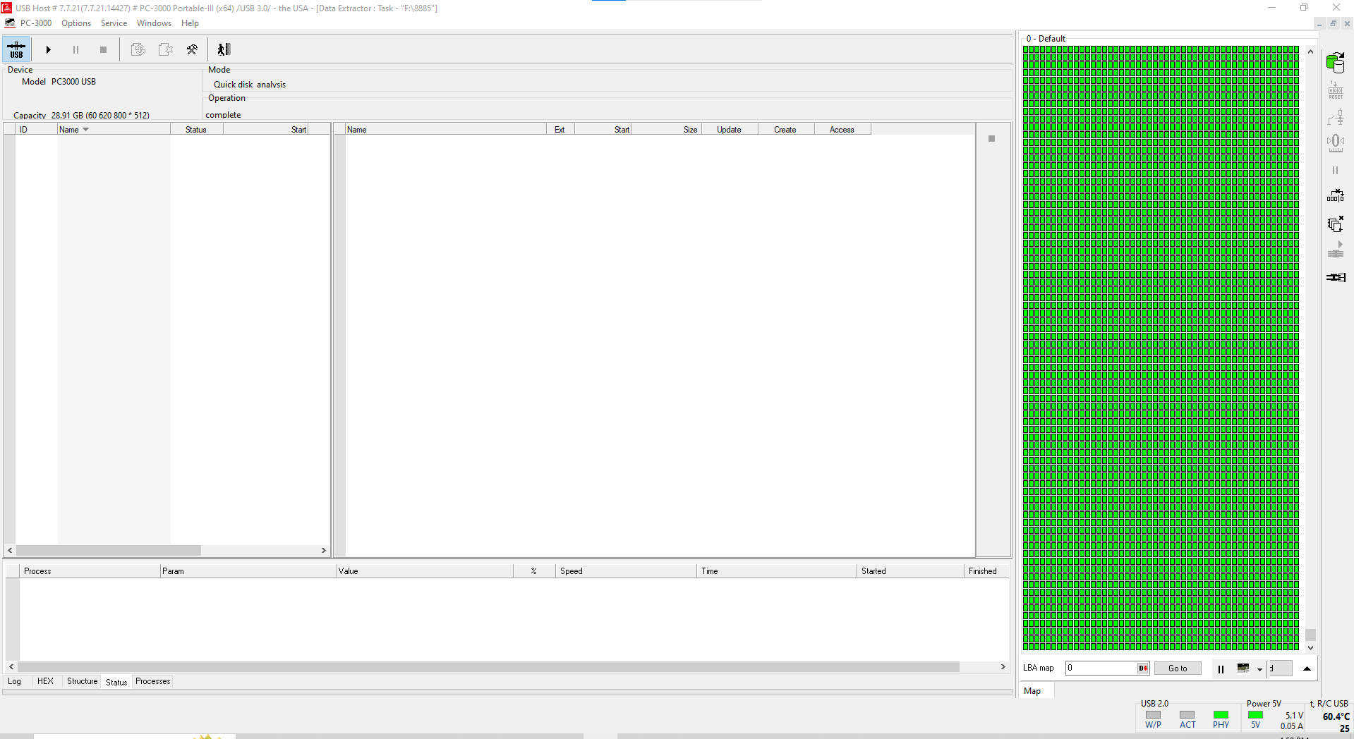

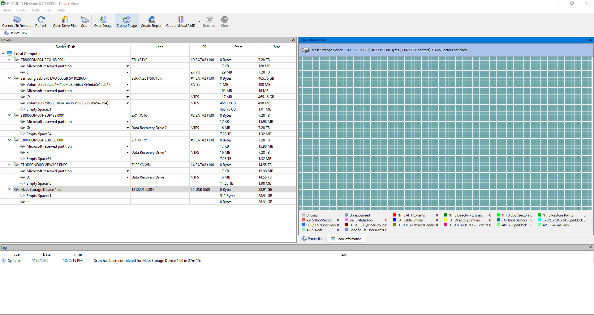

I did get a reader. It does read as 32GB but shows as a RAW format. I tried R-Studio and UFS explorer and it will only run scans showing sectors as "Unrecognized"
I tried using PC-3000 with Disk analysis and it showed green sectors during the scan but still nothing. Same goes with RAW recovery. I assume the NAND has failed. Is there any other suggestion to try?
