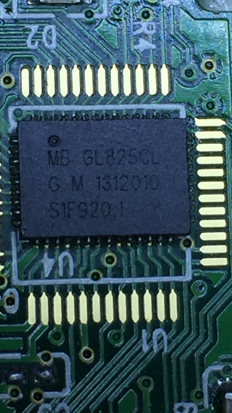

i have sony 8gb flash i cant identify matching controller any one help i search in web its broadway make.
chip id -(ID EXT= 0xADDE94EB 7444ADDE)
controller - MB GL825CL
Pavan

Hi Roman ,
I have This Exact Case Now in My Hand ,Would Share Photos And Dump If You Guys Wanna Check This Out ,These Are The Details
MCU : MB GL825CL
PCB : MBIL 1PMAQ1TM Ver 1.0
NAND : Dynet D27UCG8T2ATR 64GB
NAND Details : 1x1 ADDE94DA 74C4ADDE, part size=8192Mb, page size=8832 bytes, block size=256 pages
MCU : MB GL825CL

Roman ,
I will be adding some pictures i took to this thread today
PS : So if Anyone Has Working Pendrive of This Type Please Send Me a PM
