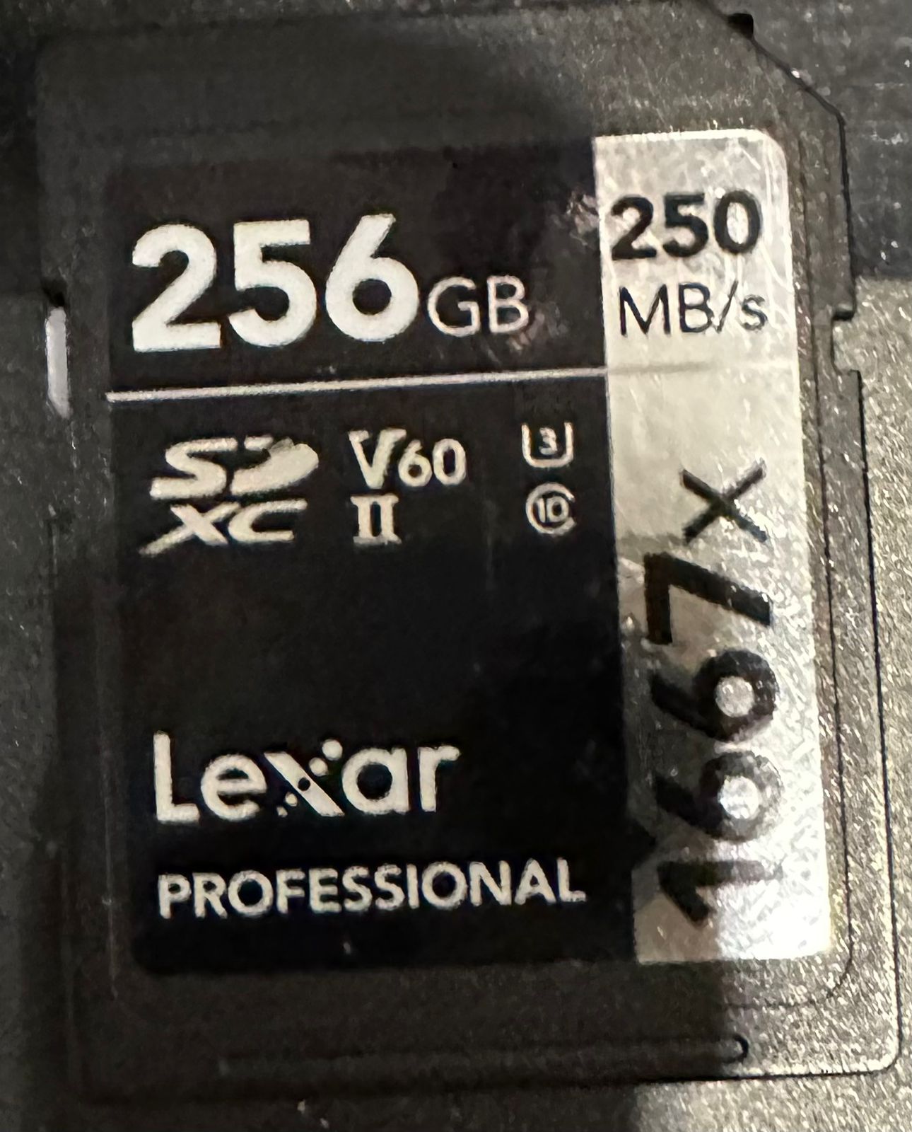

Lexar SD 256gb Not initialized give cmd8 no answer in sd card adapter

Hello. It must be SM2704-based SD card with BGA-132/BGA-152 inside. We recommend you to do a chip off. For such cards we even have a good translator which will allow us to build a good image with File Structure.

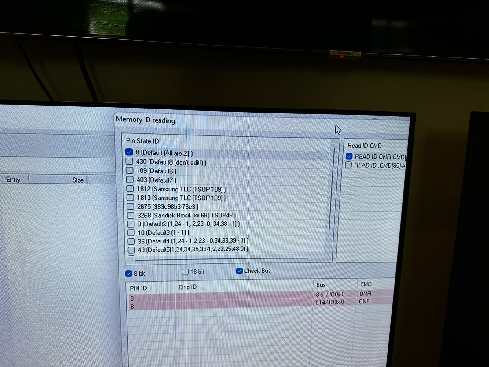

can you guide me what to select from these as it is give me error i make chip off and inserted in adapter 152

d_d_recovery
Posts: 202
Joined: 20.03.19
Reputation: 4 / (38)
Re: help to recover data frm sd card 256gb
Postby d_d_recovery » 02.07.24, 18:30
Could be the wrong adapter, a bad chip, or its not been cleaned enough.
We need a lot more information to be able to help you.

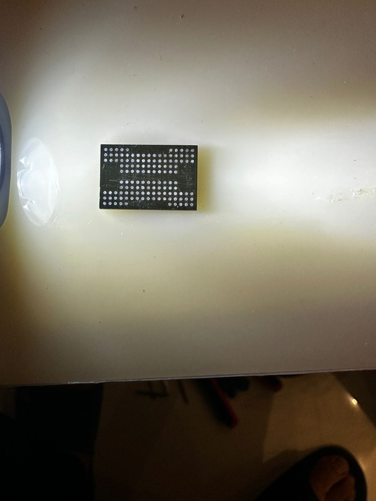

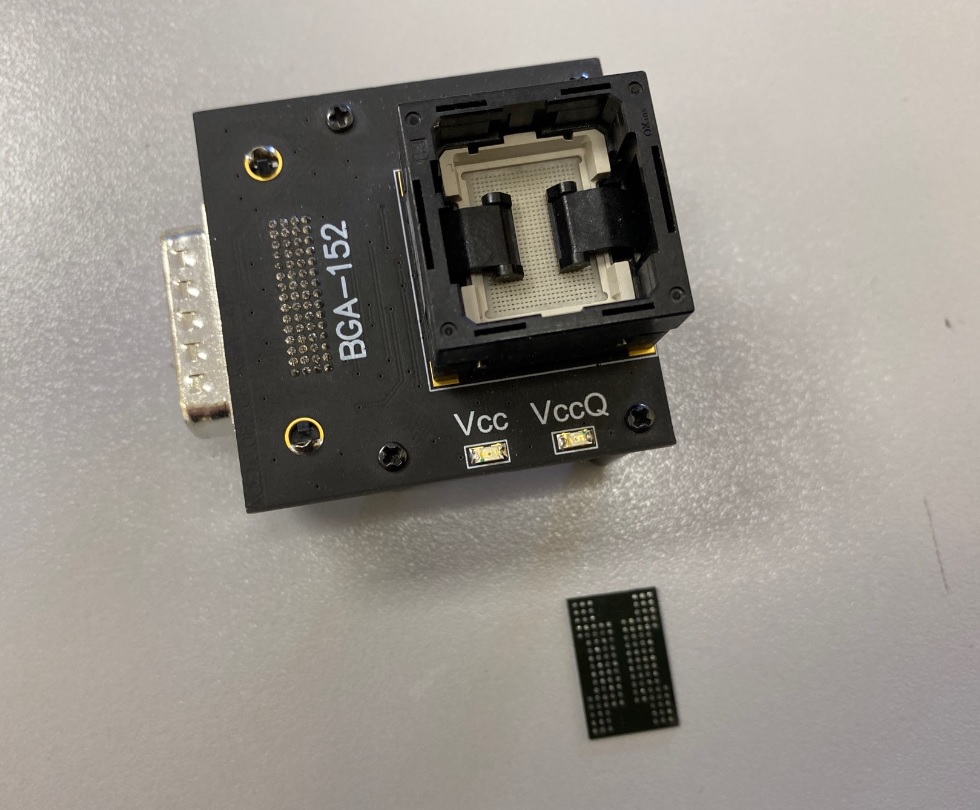

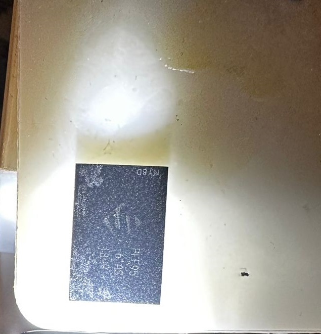

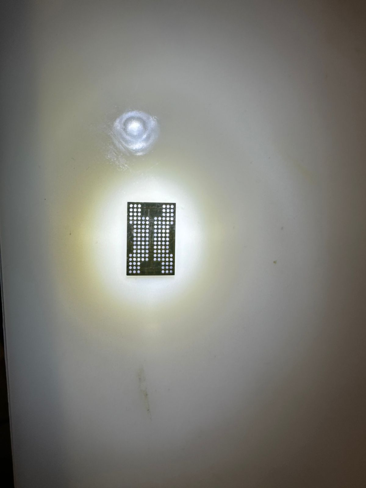

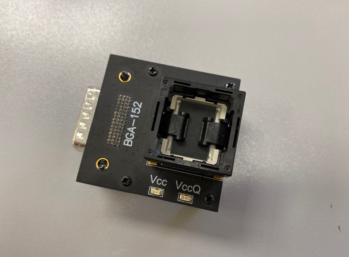

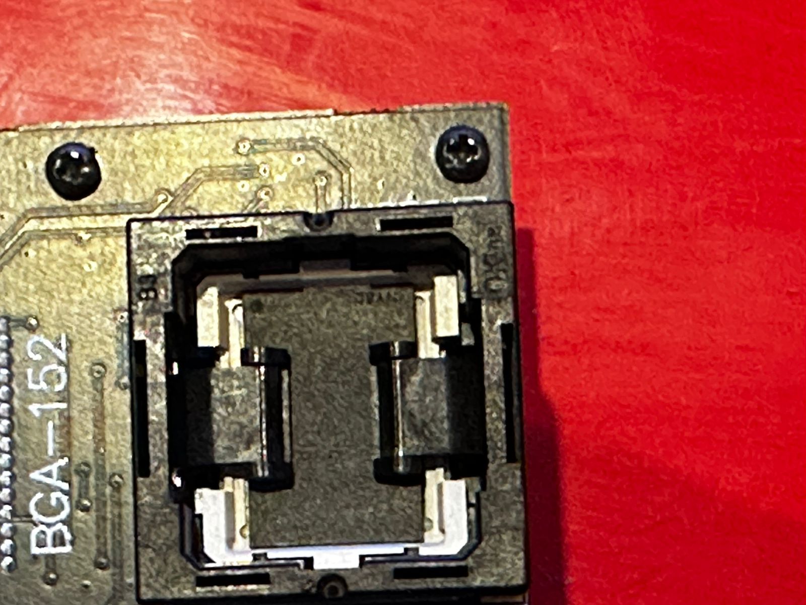

these adapter i used and shape of chip after desoldering and cleaning kindly have alook and advise

d_d_recovery
Posts: 202
Joined: 20.03.19
Postby d_d_recovery » 02.07.24, 19:51
You might want to smooth those pads a little more.
And move the chip in the reader slightly each time you try to read it as these are not automatically centered.
Postby Roman_TS » 03.07.24, 09:44
This NAND is BGA-132, which is thinner than BGA-152, so you should place it directly in the middle of the adapter, it's important for a good contacts. In case of any troubles - please contact ACE Lab TS dpt. We will guide you with recovery steps: ts.acelab.eu.com

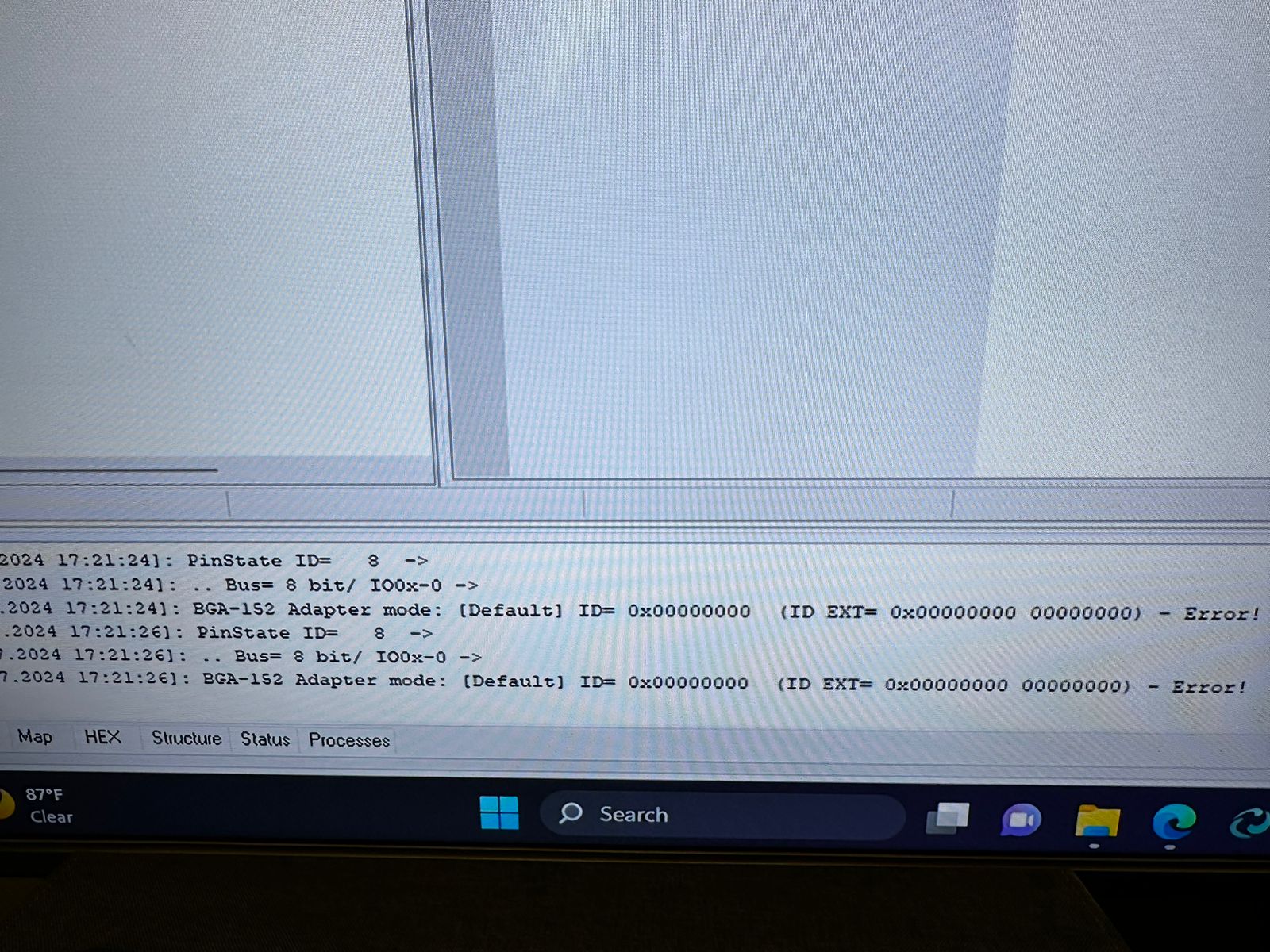

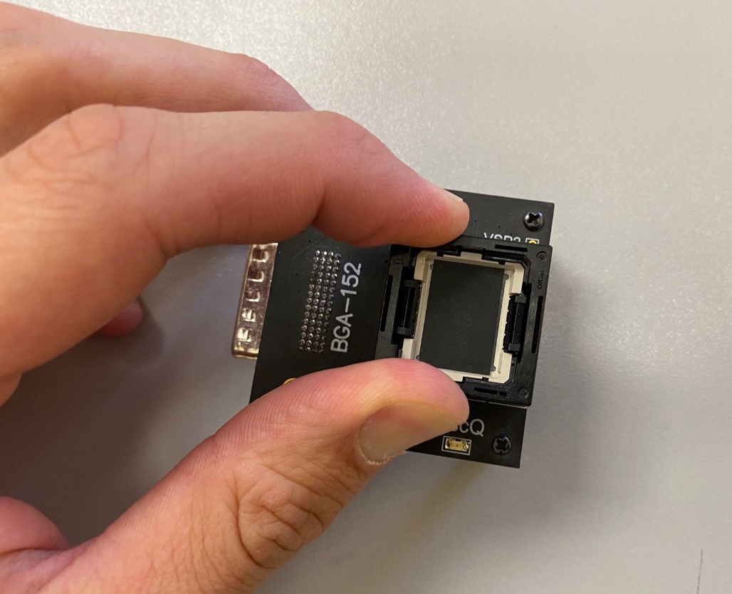

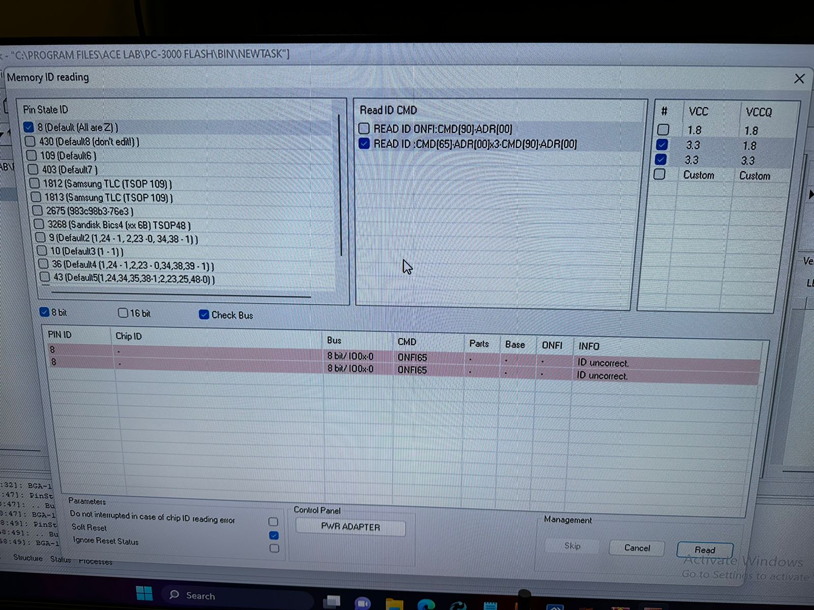

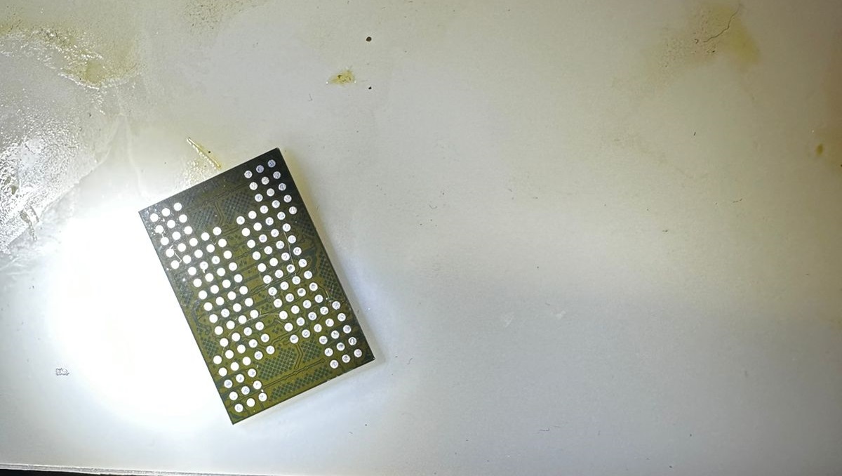

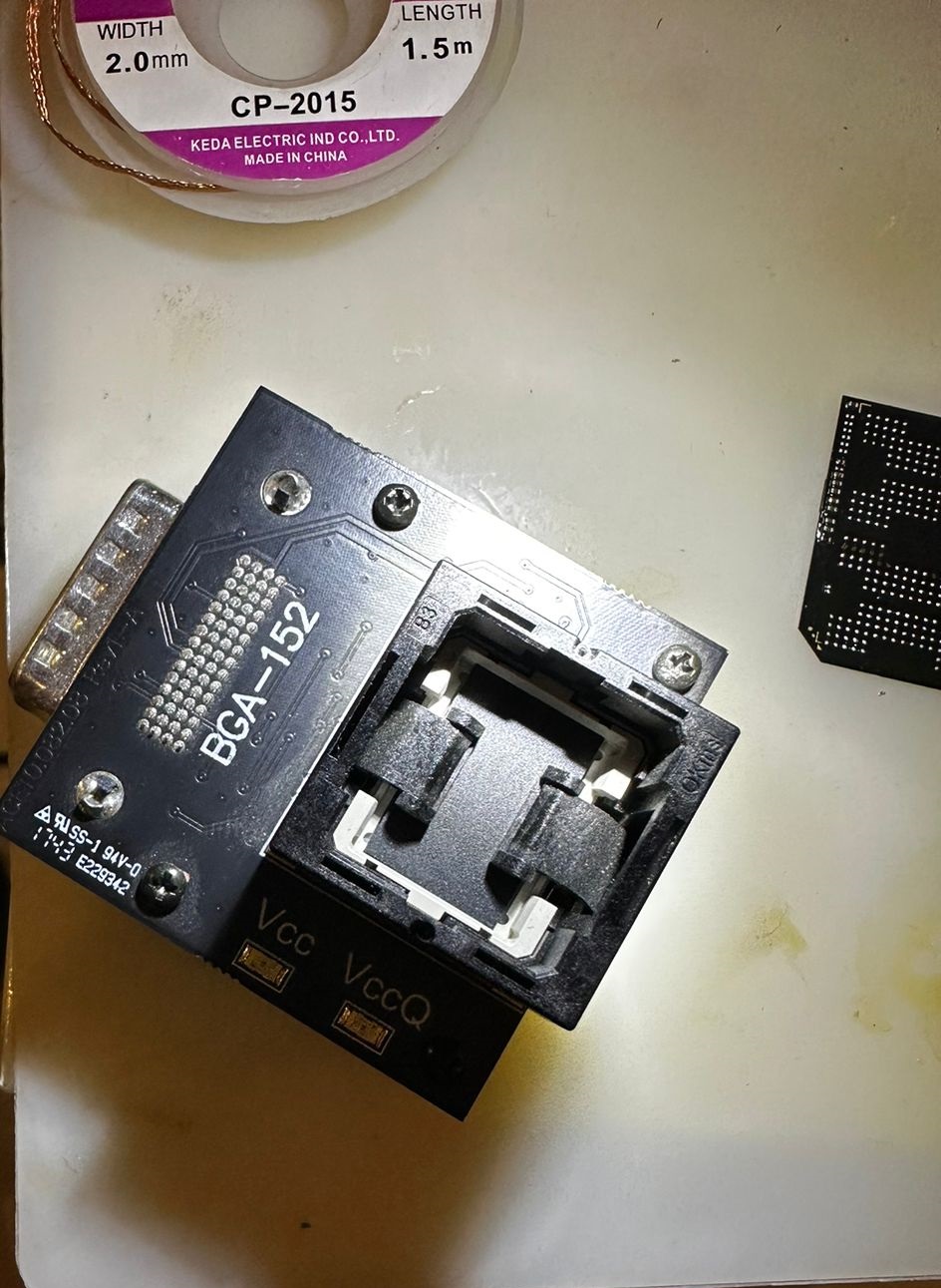

Dear Check i tried smoothing pad and centered chip in adapter but give me error as attached kindly advise smoothing pad ok or you still doubt about something
Postby Roman_TS » 03.07.24, 16:54
Please make a ticket, our engineers will guide you.
Postby Roman_TS » 03.07.24, 17:41
It's reading now. New generation of Micron NAND with 2.45V VCC and 1.8V VCCq
Controller is SM2704
Postby Roman_TS » 09.07.24, 10:01
Case was solved in PC-3000 Flash 9.0.21
