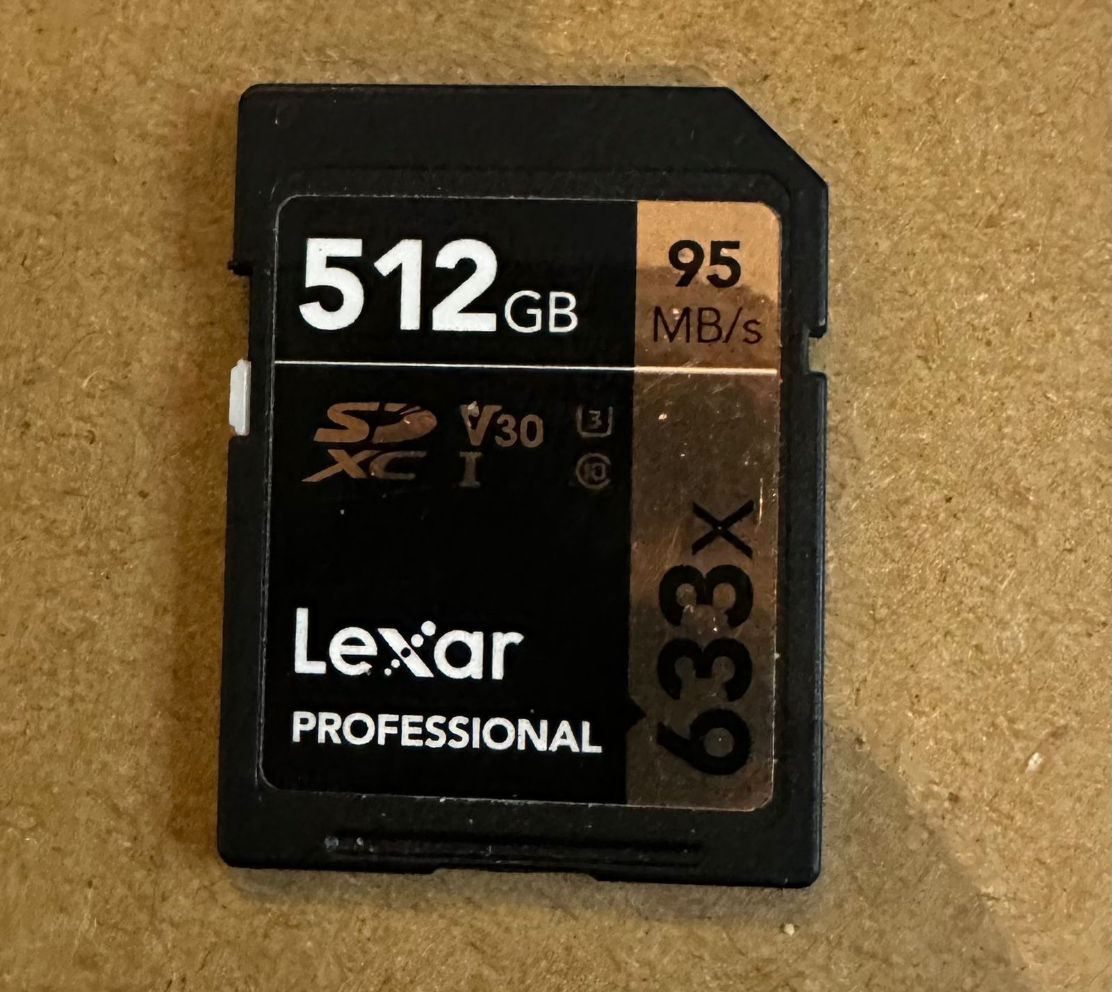

Help in recover Lexar 512 as seen not detected over any reader or over pc3000 flash sd card adapter

Hello. You need to remove the plastic cover. Most likely it's based on two BGA-132 + SM2704

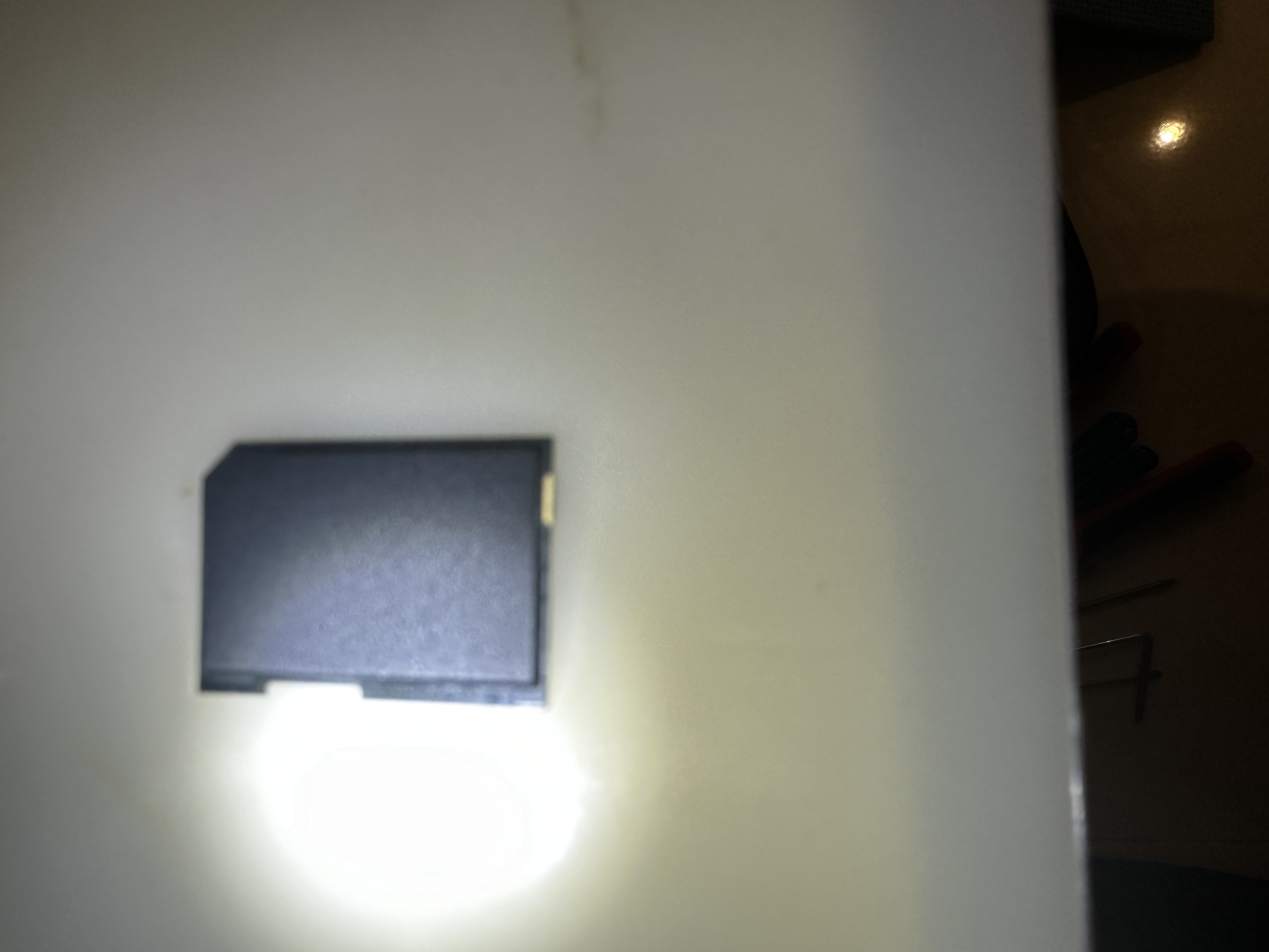

It’s like that like there is sealed or protective no chip appeared

In such case any solution to remove protective cover or in this case using spider board ?

You should grind the bottom side of the monolith and try to find the target layout.
