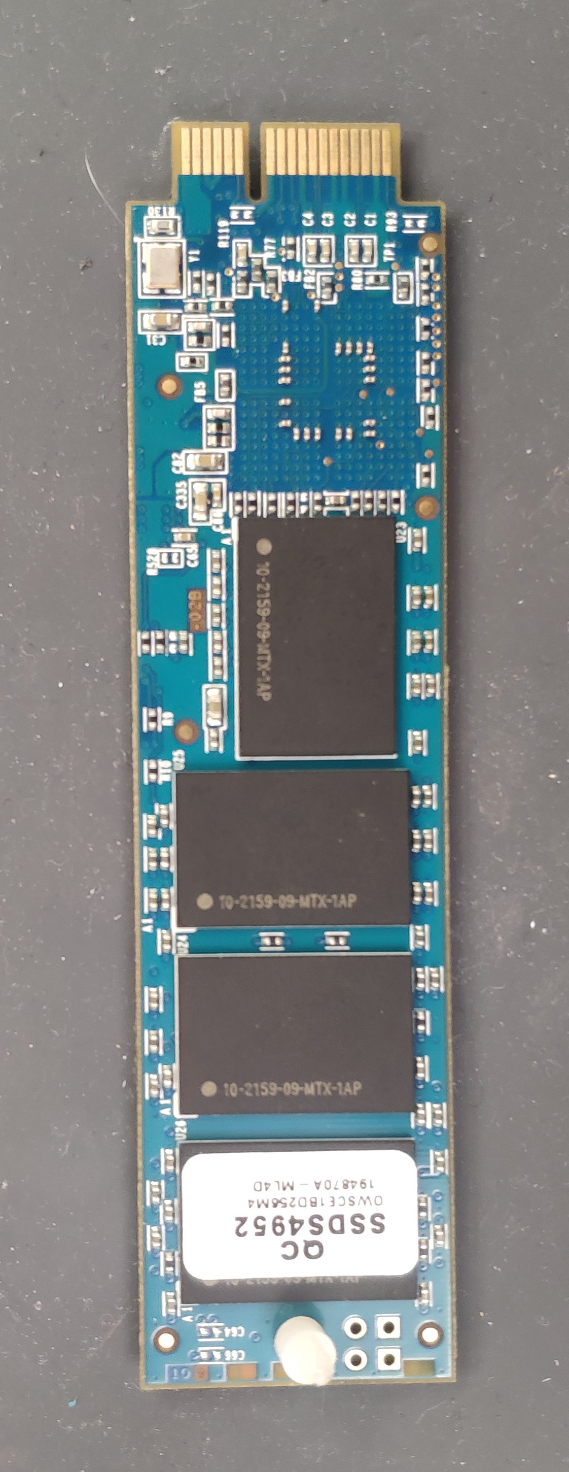

Good evening everyone, I'm practically new in pc3k and in the forum.

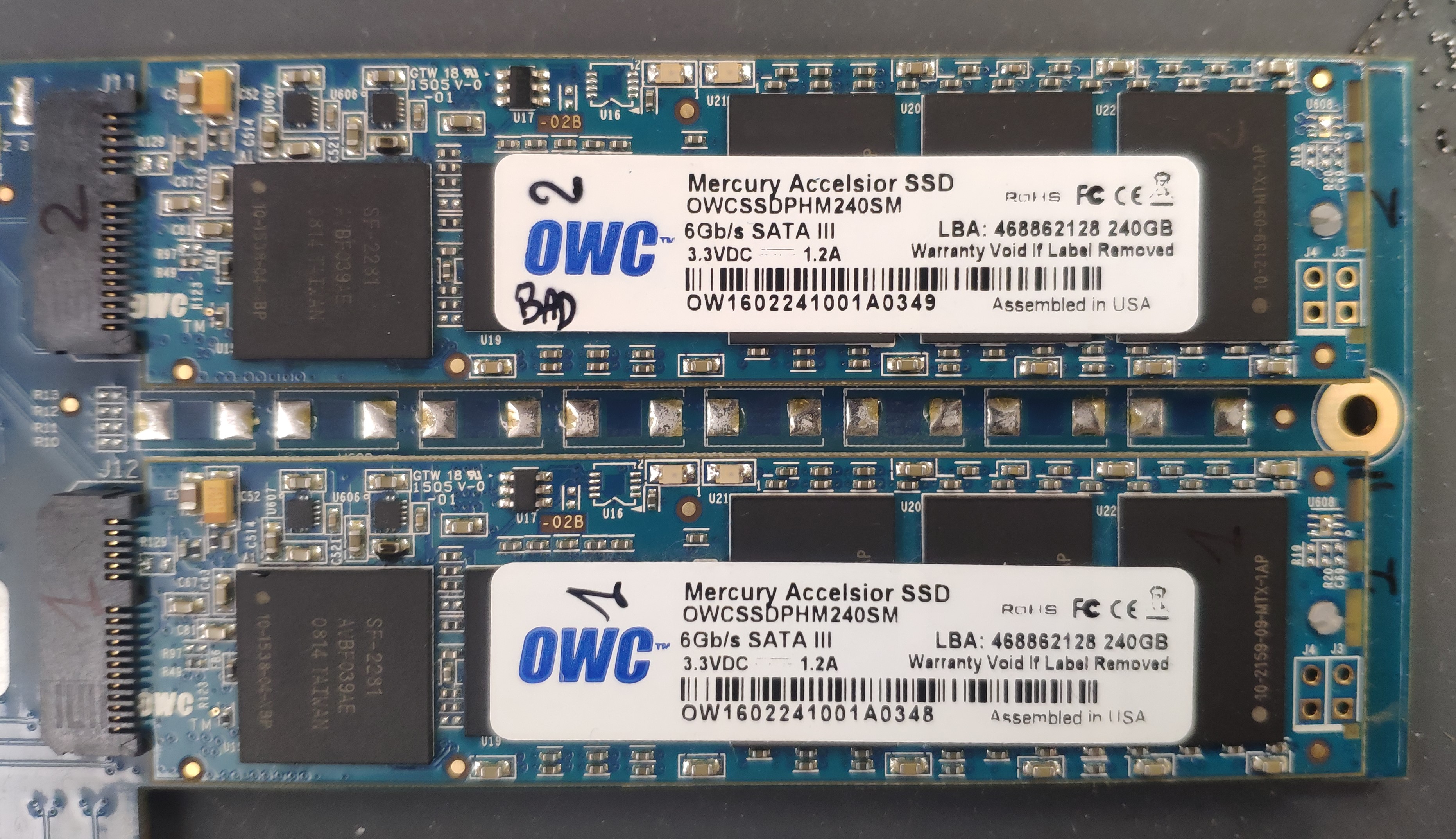

I have a PCI-SSD adapter (2x240gb Raid 0 modules) one of which seems to have gone ko.
I tried to swap it out of slots and it is actually only 1 that is not recognized, the other is online.
How is it possible to carry out an analysis with PC3000 SSD? I believe the interface is proprietary because no adapter in my possession is able to physically connect it.
I attach some photos
Antonio

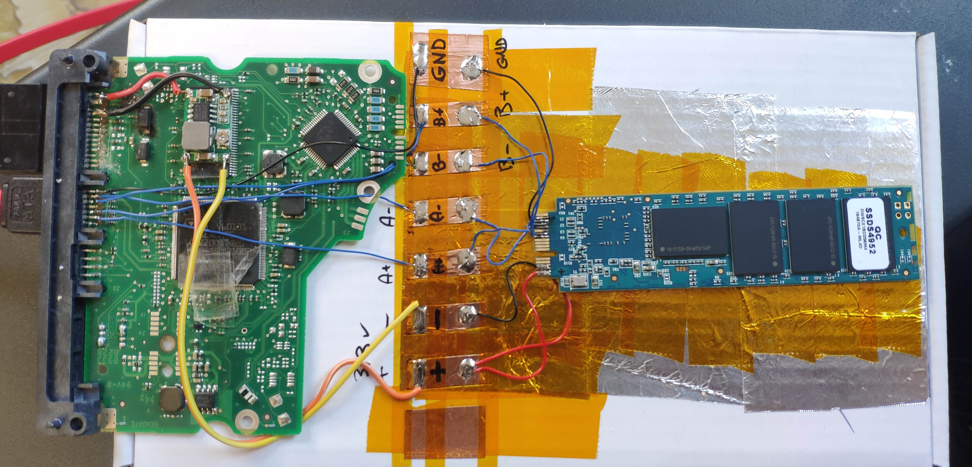

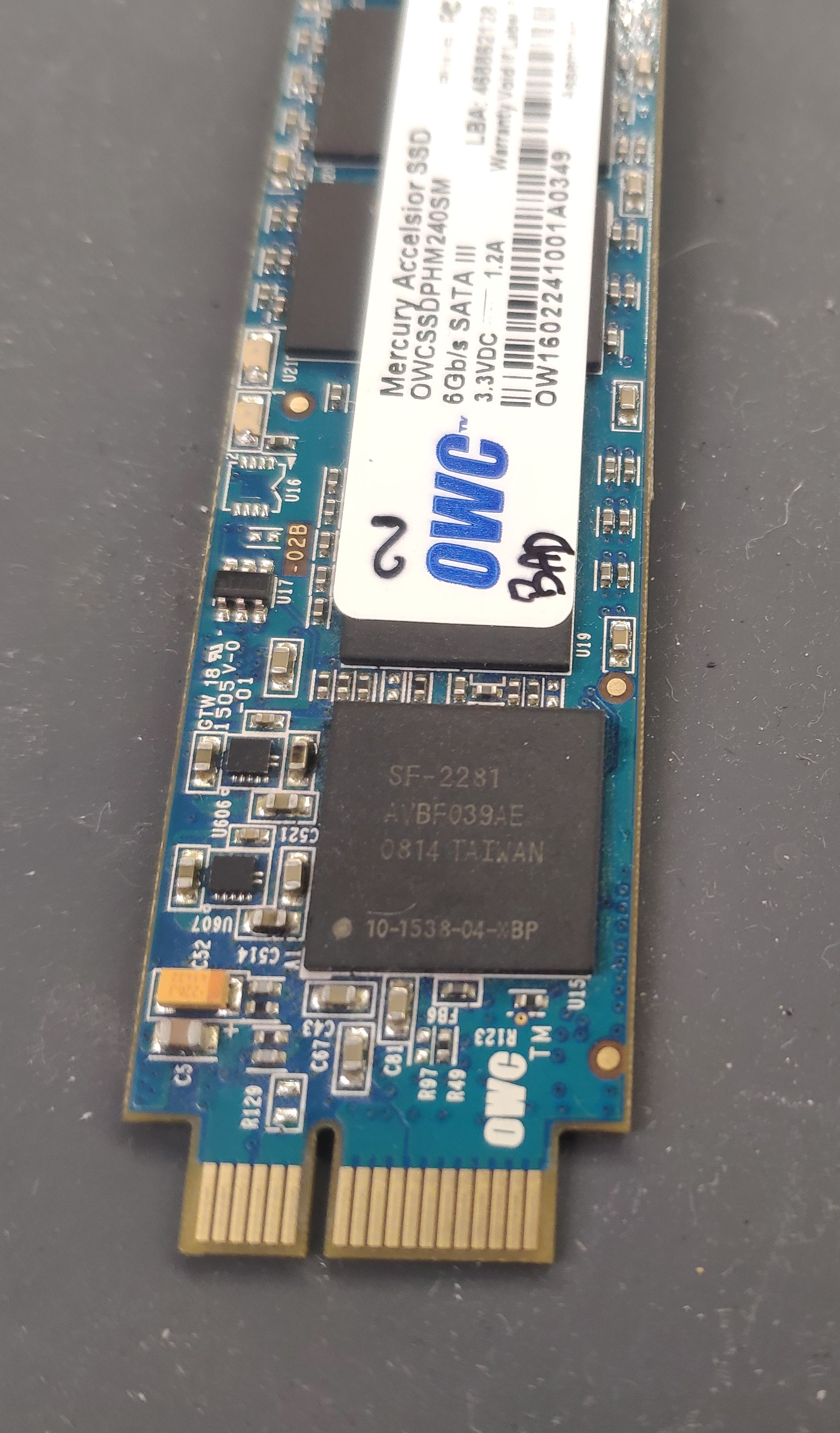

Postby digitalsupport » 03.04.20, 10:46
Had one of these ACCELSIOR E2 in for recovery last year. Drives where SATA.
Soldered SATA and power directly to the drive, if i remember right, SATA lines where tapped at 4 caps C1,C2,C3 and C4
Both drives where working fine in my case, was a simple stripe set.

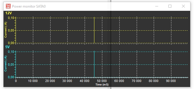

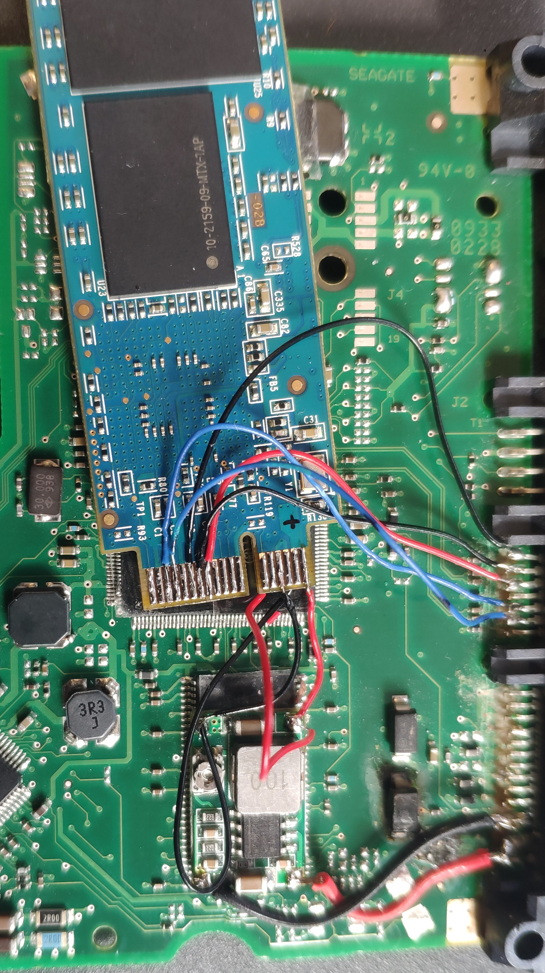

I tried the sata connection but although there is 3.3v power supply on the board there is no absorption and the board is not detected .. Did I make some mistakes?
C1, C2, C3, C4 are connected as channels A- A + B- B +, on the power connector I detected 3.3v on the pci card so I applied the same voltage by step-down
2020-04-04 16_28_47-datarecovery2 - Connessione Desktop remoto.jpg (107.86 KiB) Viewed 9108 times
2020-04-04 16_29_01-datarecovery2 - Connessione Desktop remoto.jpg (40.64 KiB) Viewed 9108 times
test performed with the disk working

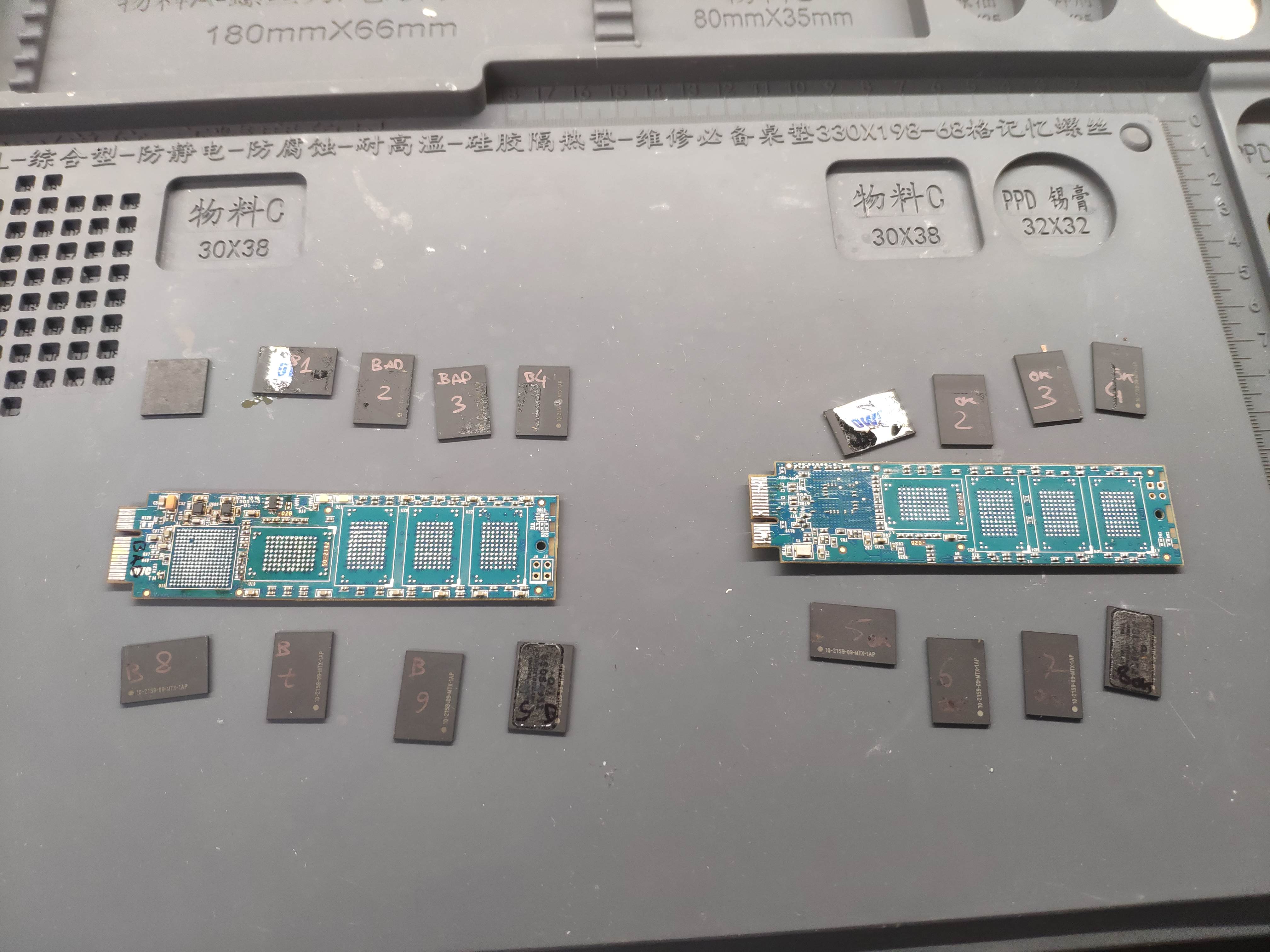

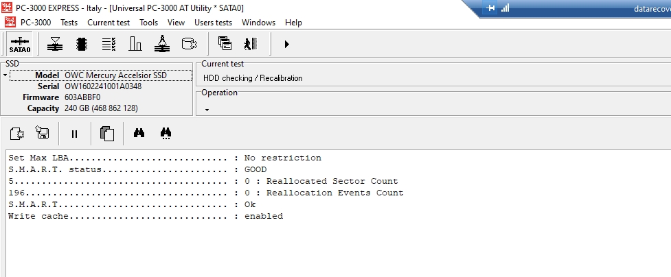

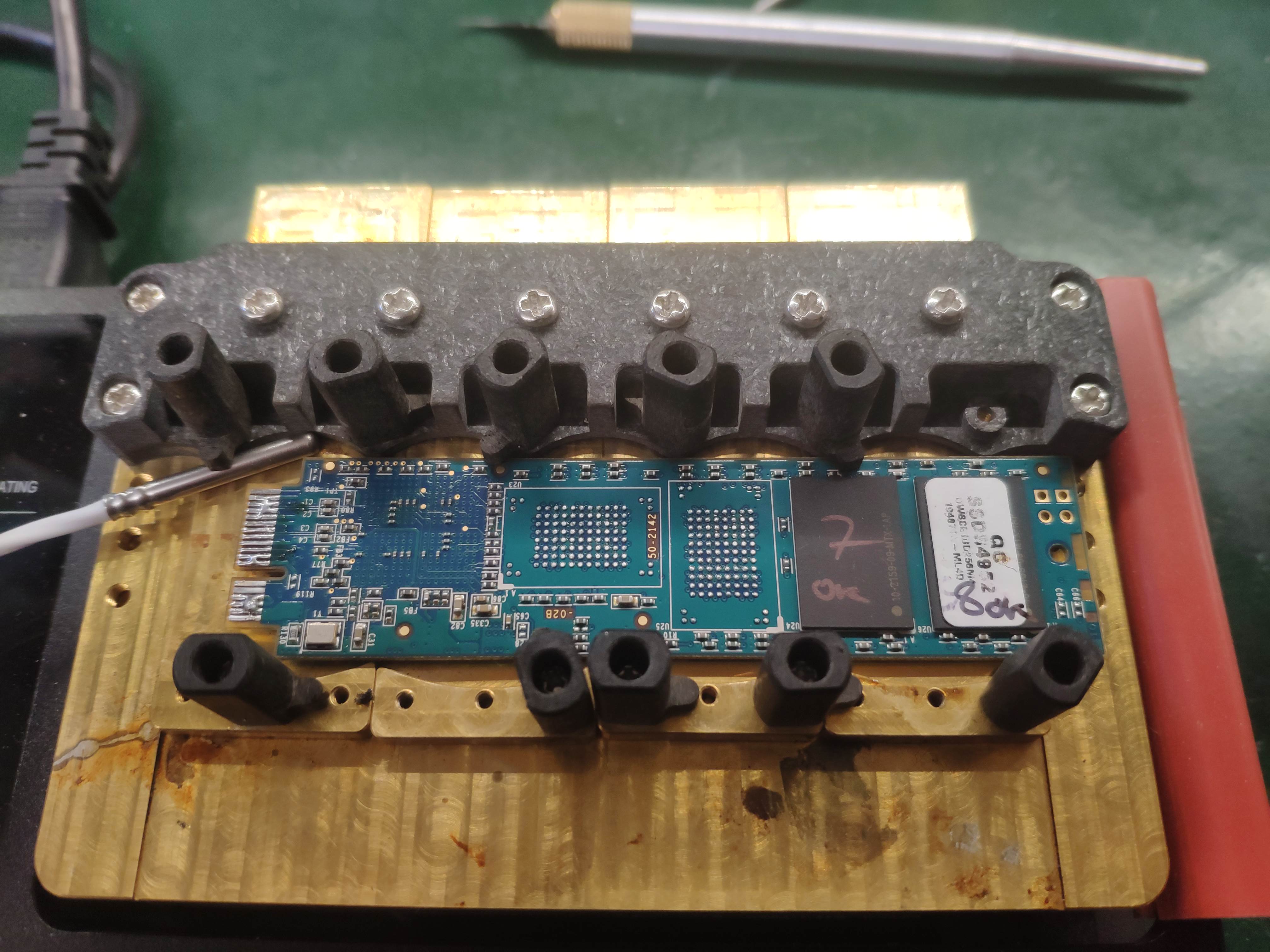

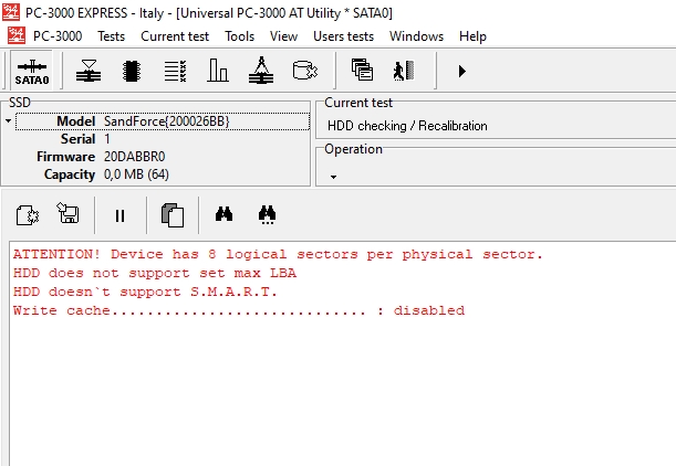

I managed to find the pinout, to read the healthy form while the bad one was not detected.
I then removed the bga sanforce and replaced it with that of the working module, it is immediately detected by pc3000 but only the controller and not the memory.
Memory good
2020-04-07 19_06_31-datarecovery2 - Connessione Desktop remoto.jpg (151.64 KiB) Viewed 9069 times
bad memory after bga replacement
2020-04-08 15_35_08-datarecovery2 - Connessione Desktop remoto.jpg (113.06 KiB) Viewed 9069 times
Do I have to give up recovery or is there any other attempt I can make?

Drive is in SAFE MODE - means that translator from NAND chips was not uploaded correctly. Check the NAND contacts. If everything is ok, then the problem is in FW corruption...

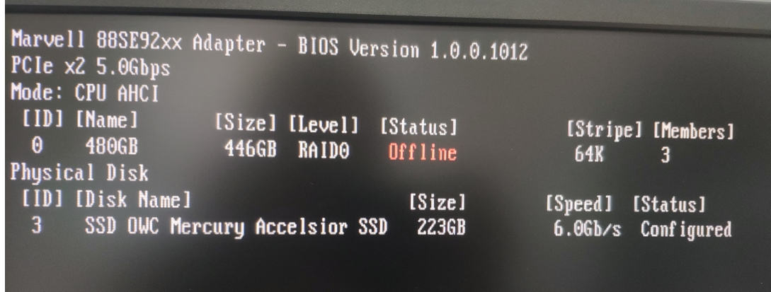

I made an extreme attempt, moving all the memory modules from the failed card to the working one. I got the same result, safe mode
2020-04-13 13_58_18-datarecovery2 - Connessione Desktop remoto.jpg (57 KiB) Viewed 9003 times
