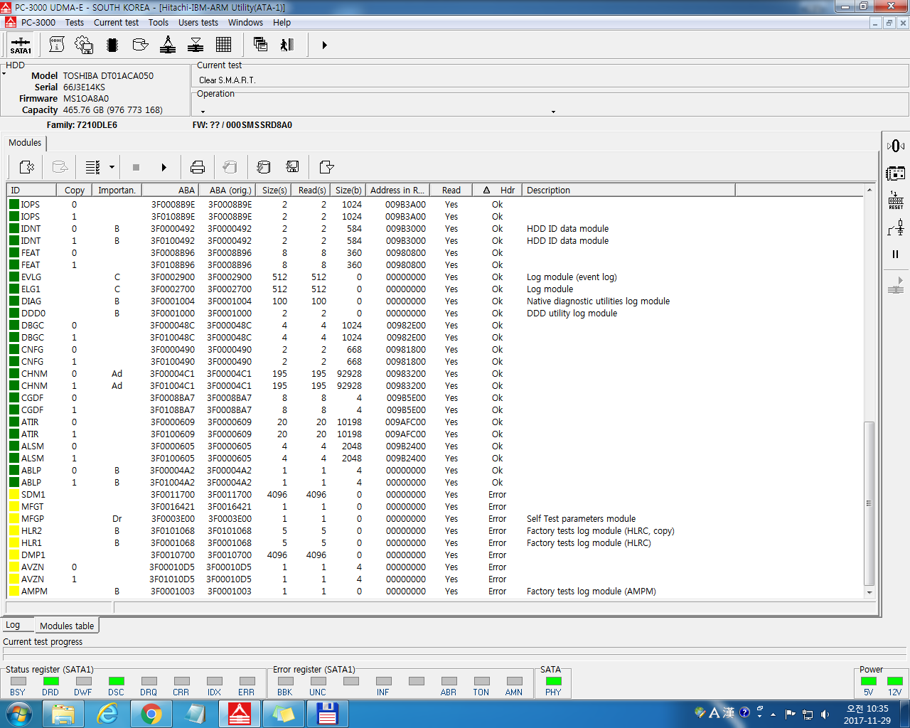

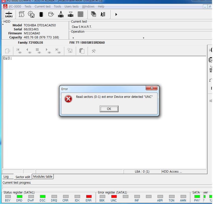

I had HDD DT01ACA050 MS1OA8A0.
This HDD recognized PC3000.
capacity size and sectors is very good.
I could read succeed modulus and SA.
but I can't read data area.
I tryed changed RDMT, PSHD and "Initialize Translator in RAM".
Could you some adviced for me?.

gmdata, did you check SA modules? You can attach log here, I will take a look :wink:

Thank you. Sergey_TS and Data medics.
I send log data. I think that modules is good.
I tryed to write RDMD, PSHD from Another HDD' RDMT, PSHD.
But HDD was same. Can't read Data area.

gmdata, SA looks OK here.
gmdata wrote:Source of the post I tryed to write RDMD, PSHD from Another HDD' RDMT, PSHD
It was a bad idea, because these modules are unique for every drive. Hope you backuped them. :shockable:
Please write them back!
Please check if all critical modules were uploaded into RAM (Sercvice Objects --> RAM) :!:
Is your drive with single head :?:

gmdata, Most probably it's head degradation in your case, but did you check content of RAM as I mentioned before?
