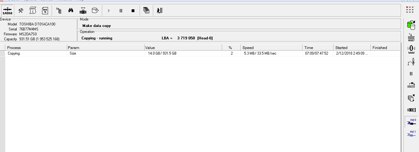

Yes Now
Same Case Solved Toshiba Hard Disk Toshiba Famliy Not Seleted Hitech Famliy Seleted Working Full Data Imaging Complied
TOSHIBA DT01ACA100.JPG (61.51 KiB) Viewed 18019 times
Because of DT**** toshiba drives are not Toshiba drives actually.
They are have Hitachi architecture, that's why for all DT*** drives need to use Hitachi ARM utility.
