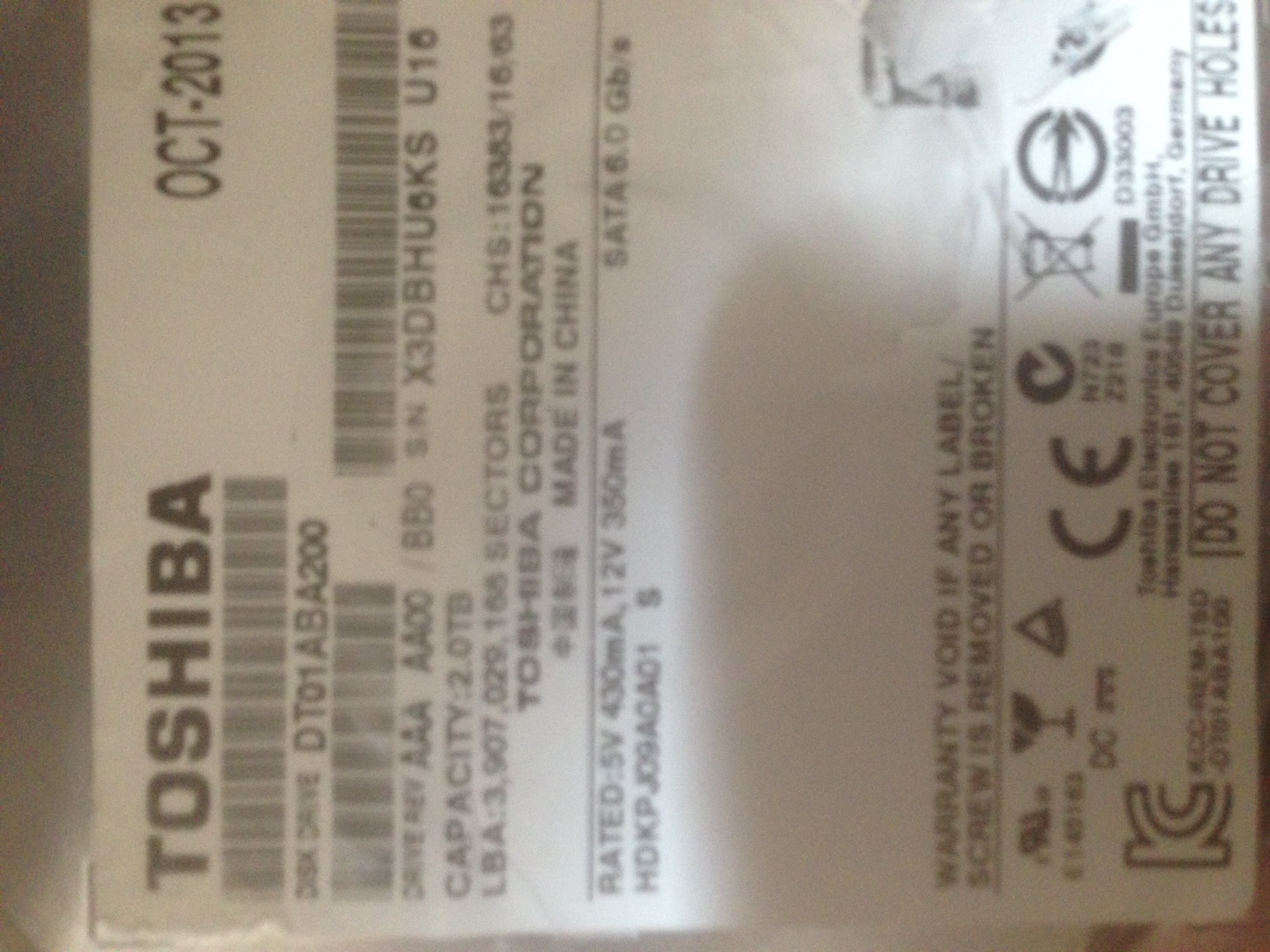

Please show a picture of the top label of the drive once
Computek
Posts: 5
Joined: 11.05.14
Reputation: 1 / (5)
Re: Which family I should choose for toshiba hdkpc09a0a01, or t01aca200
Postby Computek » 02.04.17, 15:22
Hi thankx for the reply... please see attached

Postby DataMedics » 02.04.17, 19:44
It's 7210DLE6 ARM Utility, however sometimes with this model you need to try loading a wrong utility first before it'll accept the tech key. You can see a video of how to load the utility for this one on this thread: https://www.data-medics.com/forum/hitac ... t1280.html
