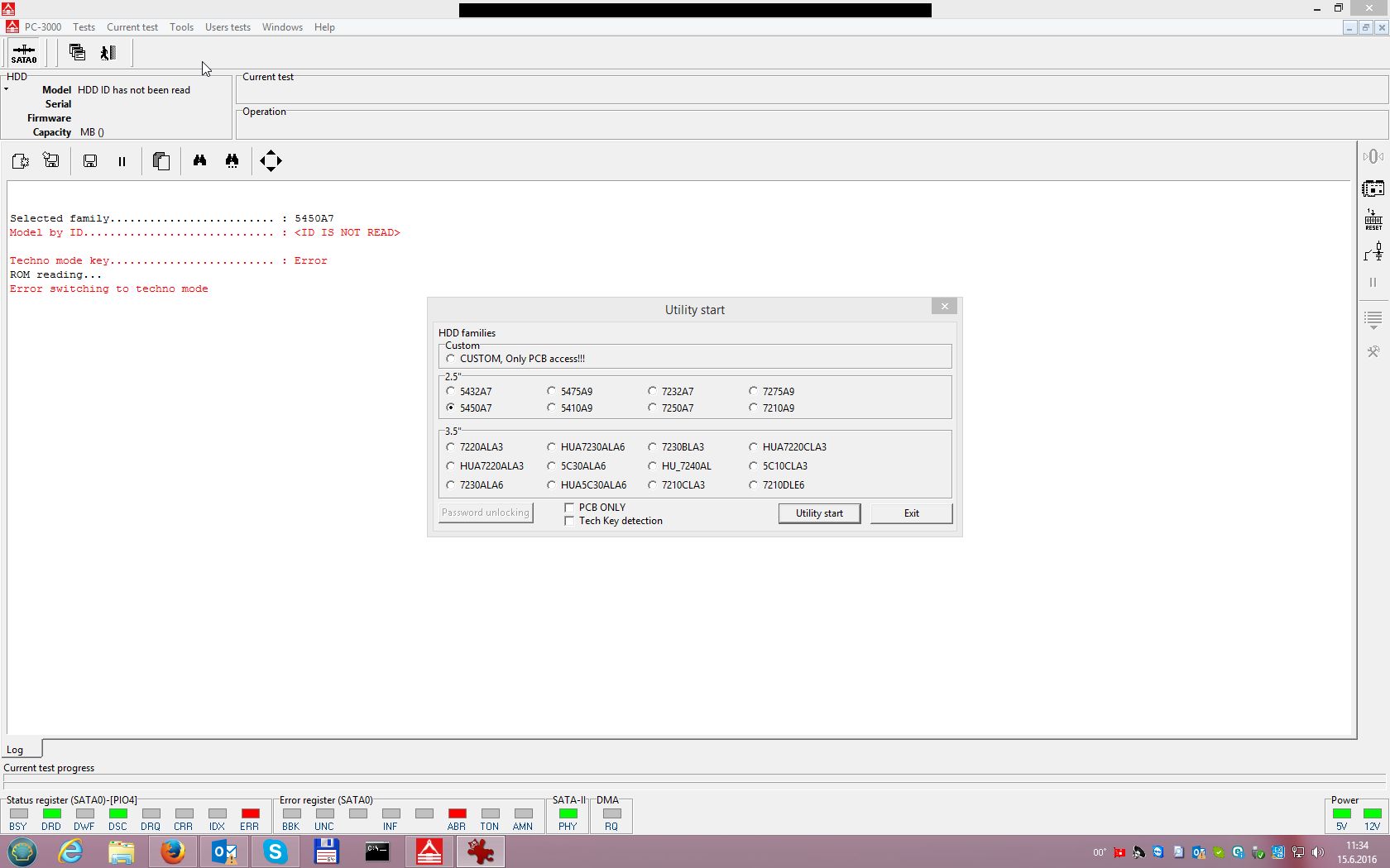

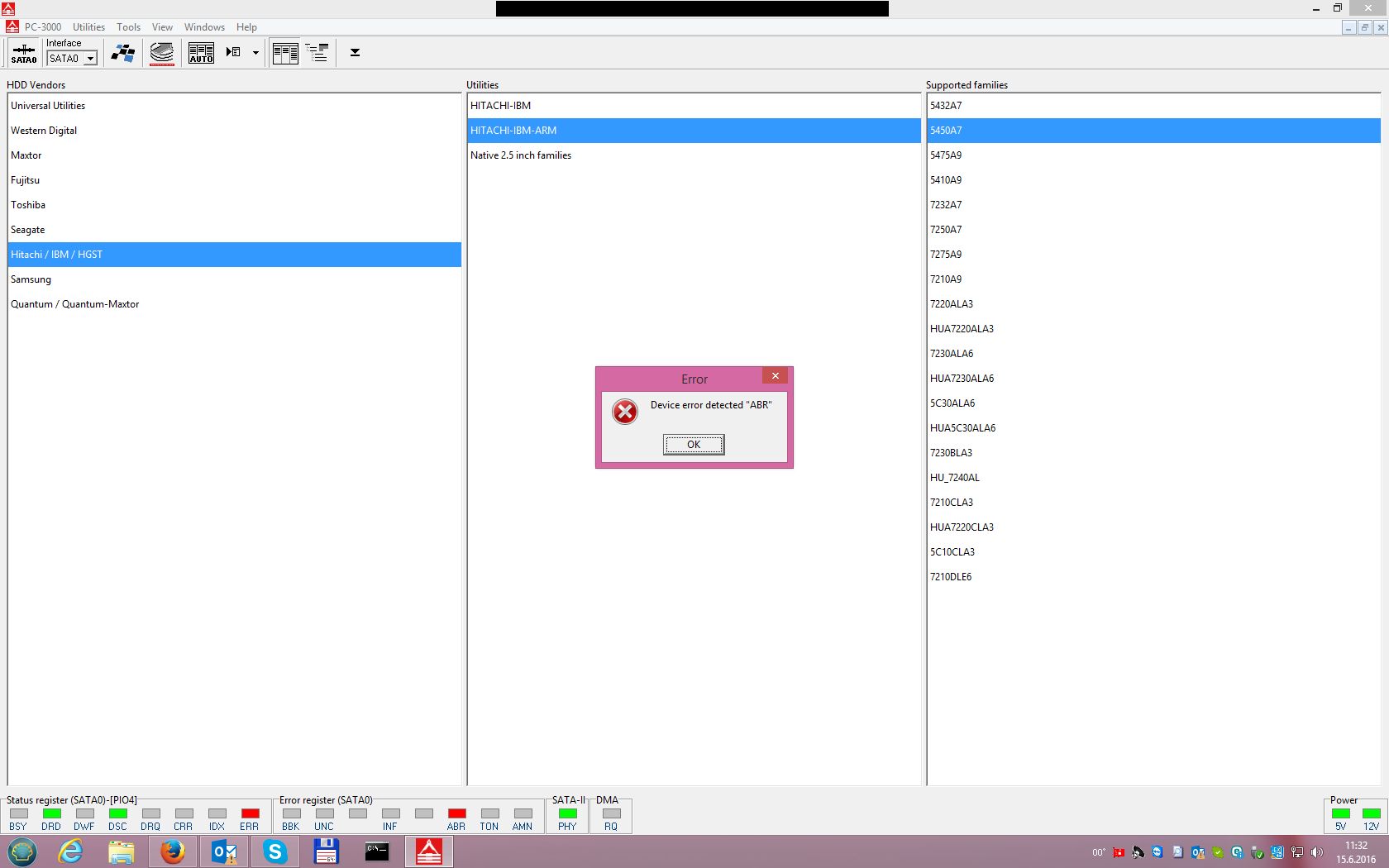

I have HTS545032B9A300 and when i start autodetect i get this info pic error1.
Also I have read the text from knowledge base of acelab web site but i cannot go to techno mode
Please help I am kind new in this bussiness.

You are using the wrong utility. This disk is supported in Hitachi/IBM utility under custom families.

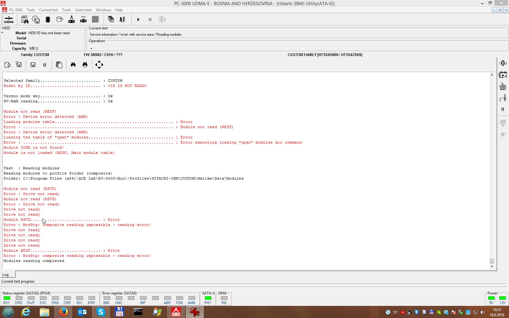

Here is new logo window with errors

Here is my log what I get when I tried HDD ID. Please can someone give me some instruction what i can try next.
******************** 21.6.2016 11:51:50 ********************
Loading data for correction of HDD family handling settings from section MEM_P
Loading data for correction of HDD family handling settings from section HTS5450B9
Selected family......................... : CUSTOM
Model by ID............................. : <ID IS NOT READ>
NV-RAM reading.......................... : Ok
Module not read (RESF)
Error : Device error detected (ABR)
Loading modules table................................................. : Error
Error : .............................................................. : Module not read (RESF)
Loading the table of "open" modules................................... : Error
Error : .............................................................. : Error executing loading "open" modules dir command
Module ZONE is not found!
Module is not loaded (RESF, Main module table)
Test : Reading NV-RAM
Reading NV-RAM to file ( C:\Program Files (x86)\ACE Lab\PC-3000\Bin\!Profiles\HITACHI-IBM\CUSTOM\Melika\Data\NV-RAM\NV-RAM.nvr )
Reading................................. : Ok
Saving.................................. : Ok
Test : NV-RAM adjustment (SA search)
To vary.................. : SA Top
from..................... : 0x28334
to....................... : 0x2EB34
Working folder........... : C:\Program Files (x86)\ACE Lab\PC-3000\Bin\!Profiles\HITACHI-IBM\CUSTOM\Melika\Data\NV-RAM adaptation
RAM reading............................. : Ok
Searching for SA Tops table image in RAM : Error
Test : Reading modules
Reading modules to profile folder (composite)
Folder: C:\Program Files (x86)\ACE Lab\PC-3000\Bin\!Profiles\HITACHI-IBM\CUSTOM\Melika\Data\Modules
Module not read (RSVD)
Error : Drive not ready
Drive not ready
Drive not ready
Module RSVD............................. : Error
Error : ModStg: composite reading impossible - reading error!
Drive not ready
Drive not ready
Drive not ready
Drive not ready
Module RESF............................. : Error
Modules reading completed
Test : HDD configuration changing
Module IDNT is not found!
Test : Clear S.M.A.R.T.
S.M.A.R.T. Enable Operations Error Device error detected "ABR"
Clear S.M.A.R.T....................................................... : Error
Device error detected "ABR" 51 / 04
Soft reset ...
Soft reset ...

More than likely the heads are the problem here.
Re: Hitachi HTS545032B9A300 INIT prob
Postby DataMedics » 11.10.16, 22:13
I just had a HTS725032A9A364 come in today returning this exact same error message. No clicking, got ready really quickly, but no SA access, can't read modules directory, etc.
Changed heads, and am now imaging at 104Mb/s.
Filipp_TS
Joined: 15.04.13
Reputation: 9 / (93)
Postby Filipp_TS » 09.11.16, 16:24
msurgeon wrote:Source of the post More than likely the heads are the problem here.
DataMedics wrote:Source of the post I just had a HTS725032A9A364 come in today returning this exact same error message. No clicking, got ready really quickly, but no SA access, can't read modules directory, etc.
Yes, basically it's a Heads issue.
But sometimes drive has been in other DR lab (before your) and now it have a not original PCB...
So, one more little trick is check S/N in NVRAM editing window and compare it with S/N on the HDD label. :wink:
