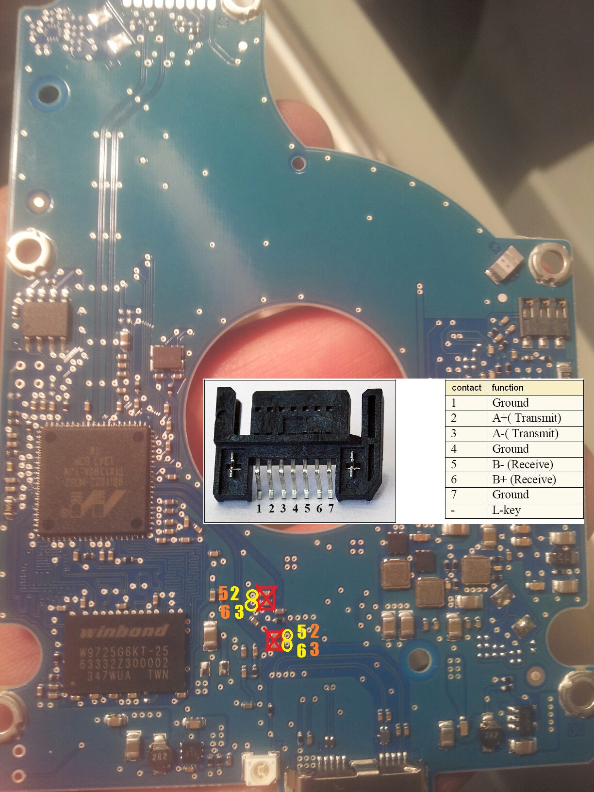

How Can I solder the SATA adapter on a SAMSUNG ST500LM016, HN-M500XBB
Best regards
Re: SAMSUNG ST500LM016
Postby AJ2008 » 01.10.15, 12:55
USE pcb from HN-M500MBB
geosou
Posts: 4
Joined: 30.01.14
Postby geosou » 18.10.15, 00:02
Thank you for your reply AJ2008 i will try that
Garry_TS
Posts: 34
Joined: 06.05.14
Reputation: 4 / (35)
Postby Garry_TS » 24.11.15, 21:48
You have to find two differential paired PCB traces that are comming from USB bridge to main IC and unsolder 4 capacitors.
Same way like in ST2000LM005.
As alternative you can use any SATA PCB from same family with same processor.
