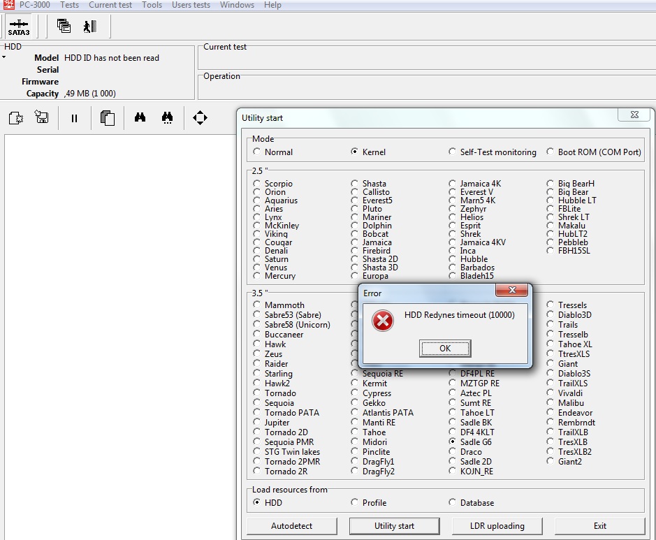

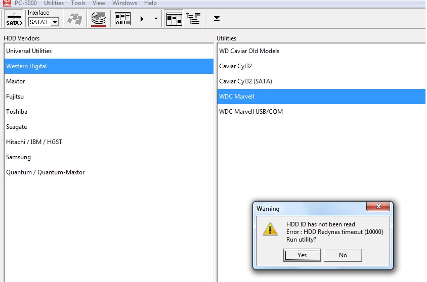

Would you please give me a piece of advice about a WD20EARX 00PASB0.
The drive seems to work well, it pass the BSY state and there is no strange sound, but when I try to open the WD utility, it doesn't recognise the Drive's ID (both normal and kernel mode)

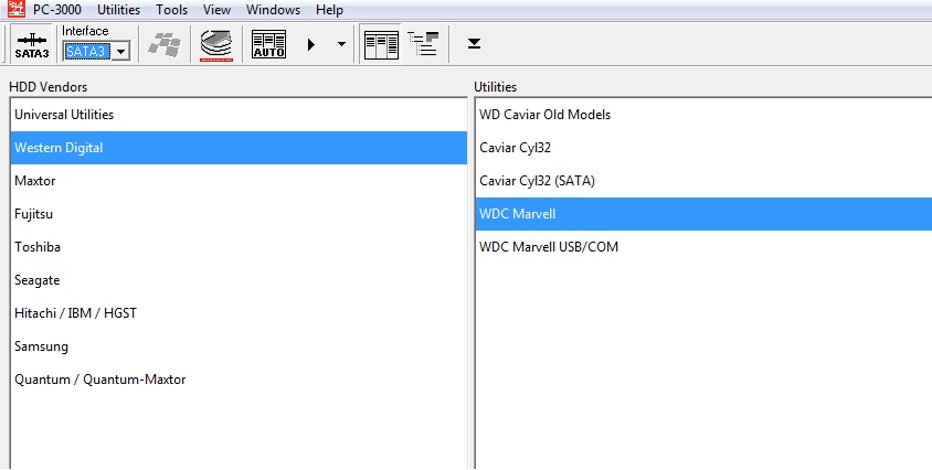

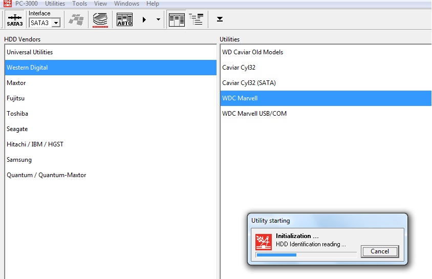

Navafigo, try to follow this instruction: http://blog.acelab.eu.com/pc-3000-h ... oblem.html
