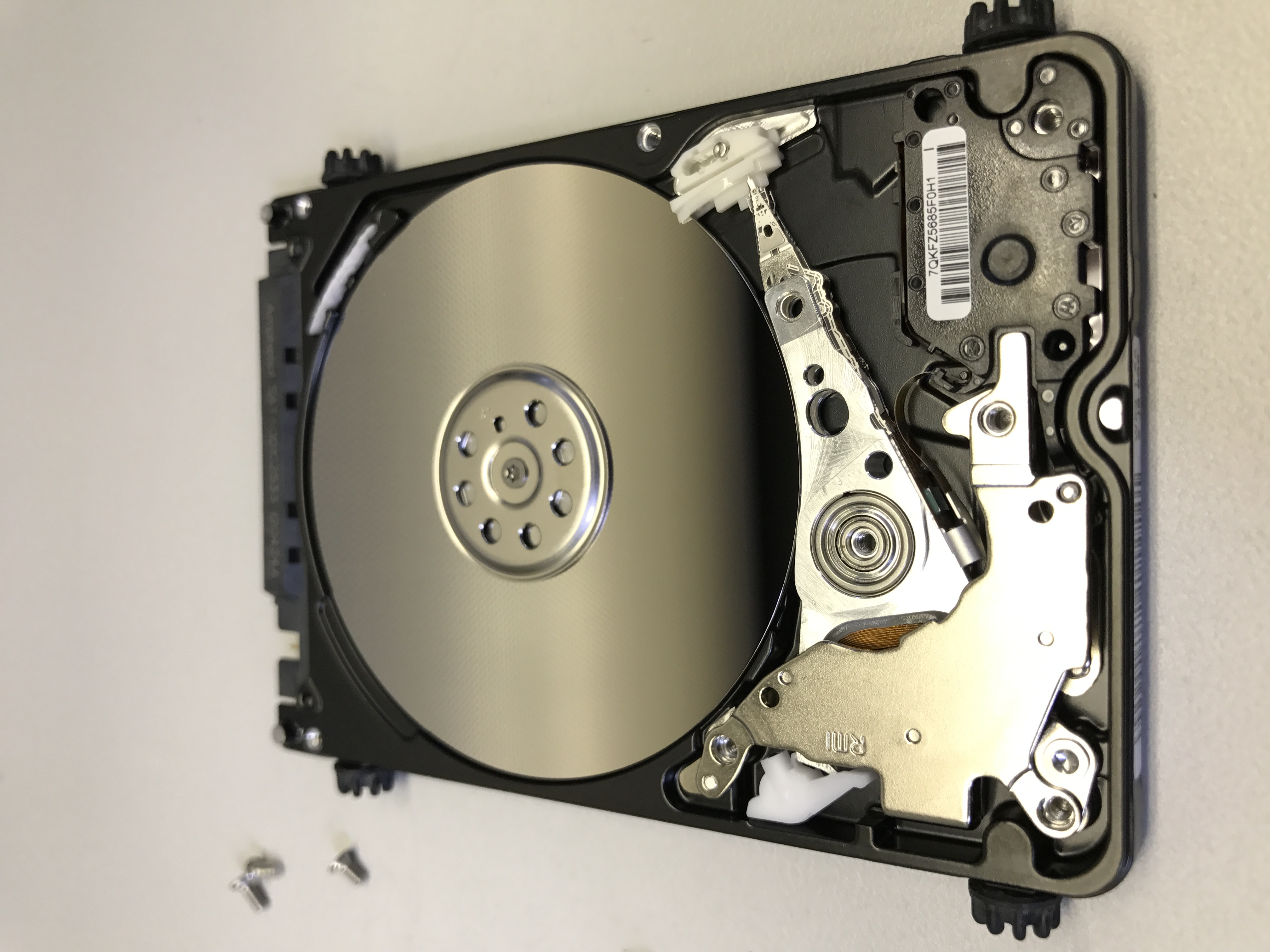

This is a Hubble WD5000LPVT-75G33T0

Wait! Is your WD5000LMVW a Hubble or Hubble LT?
WD5000LPVT-75G33T0 is Hubble
WD5000LPVX is Hubble LT.
The HSA fits between WD5000LPVX and WD5000LPVT but I have never tested heads between the 2 different Families.

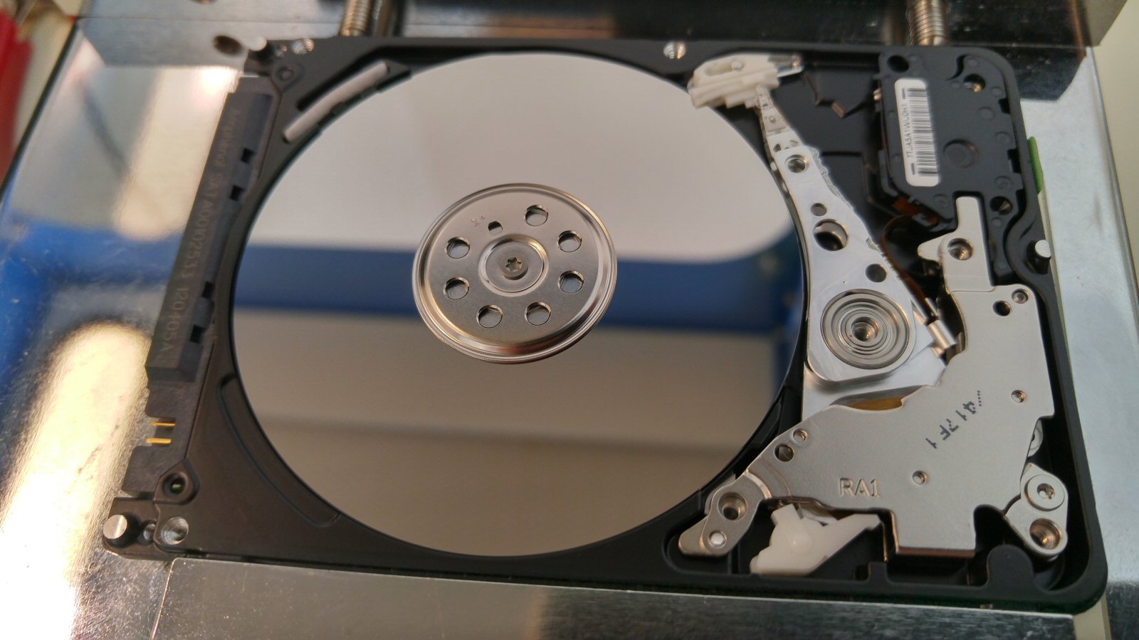

I know this is an old thread, but I can confirm;
Patient:
WD5000LMVW-11CKRS0 (Hubble)
Donor:
WD5000LPVX-28V0TT0 (Hubble LT)
With matching DCM and country are compatible.
