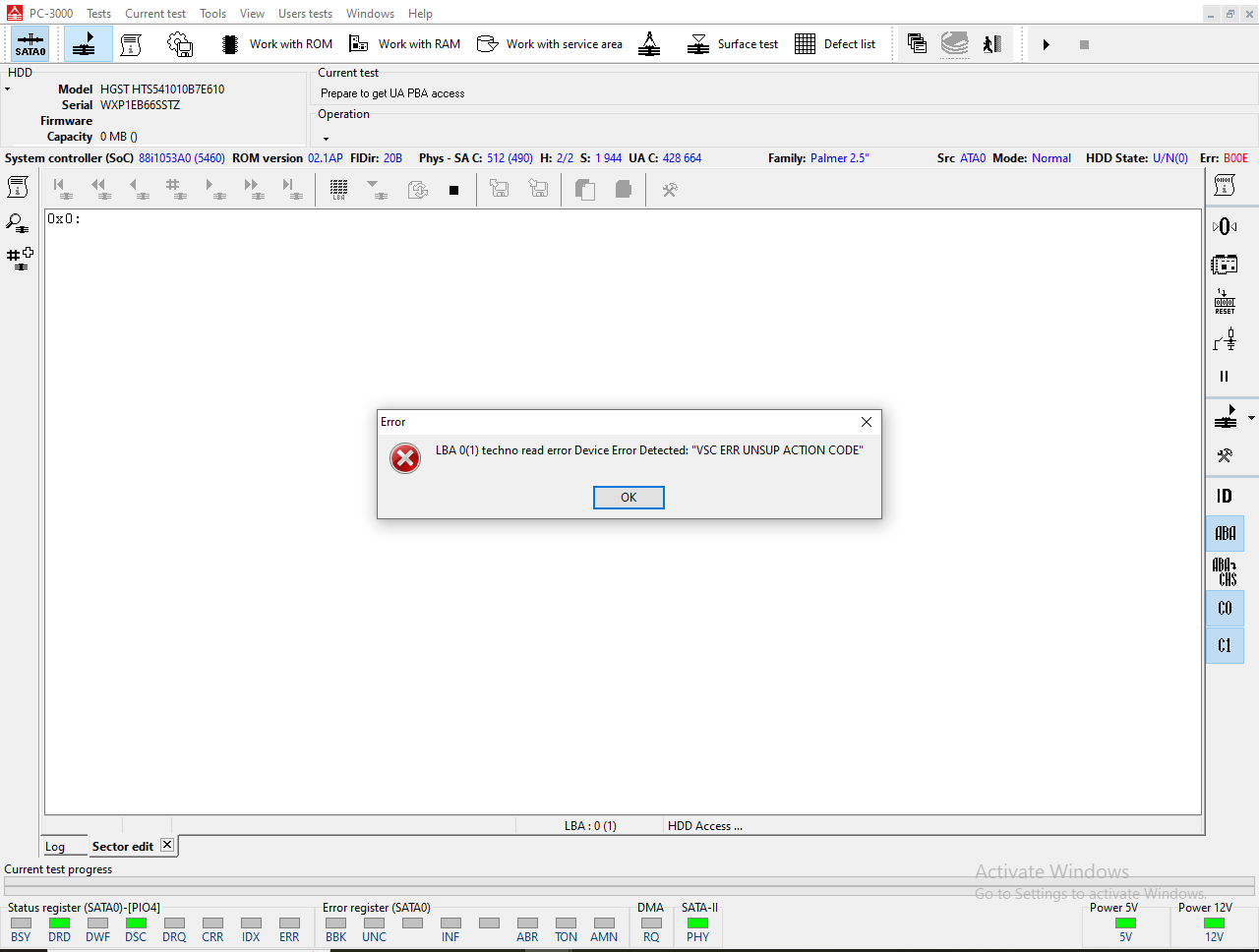

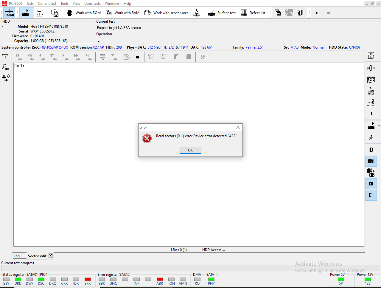

Hello everyone, I am working on a case involving an HGST HTS541010B7E610 drive, which is detected as part of the WD Palmer drive family. AT first sectors are readable; however, the drive slows down significantly when copying user files in the Data Extractor (DE). So I attempted to 'Solve Slow Responding Problems' procedure, locked UA writing, and applied T2 recovery. Shortly after, the sector editor stopped accessing the drive entirely, and even if i tried to get the sectors by utility mode and get access to the sectors I am unable to create tasks in the DE. Could someone please advise on how to proceed with this situation?

Slow respond solution should not run on this model. Also, I do not believe there was need to run T2 recovery
Second image shows overlays are not loaded. upload loader then upload DIR from SA then check modules directory to look for any modules with errors and proceed from there
