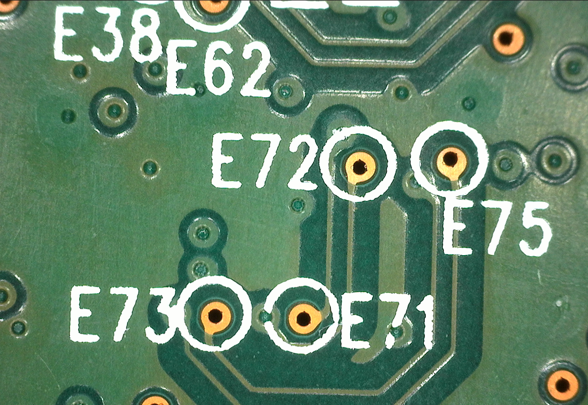

Postby digitalsupport » 06.11.23, 08:51
If you mean how to connect SATA connections to 2060-800067-001 USB PCB it´s like all others, usual pins E71, E72, E73 and E75 is even marked.
Remember to remove capacitors in the SATA line. I also recommend to shot USB bridge crystal.

digitalsupport wrote:Source of the post If you mean how to connect SATA connections to 2060-800067-001 USB PCB it´s like all others, usual pins E71, E72, E73 and E75 is even marked.
Yeah i mean which capacitors and crystal?? Can you show me please!

Postby DCDL » 08.11.23, 15:22
Re: Charger Unlocked PCB encryption issues
Postby digitalsupport » 10.11.23, 09:10
DCDL beat me :)
Postby gameboybin » 15.11.23, 09:56
DCDL wrote:Source of the post Image
Sorry, One more question. How do you send in the 5V. Can i just plug USB 3.0 in like normal to get the voltage. Or i need to solder the wire an send the 5V into that spot seperatelly??
Postby digitalsupport » 15.11.23, 14:04
I solder 5v and gnd to a probe board for easy connection to PC-3000
