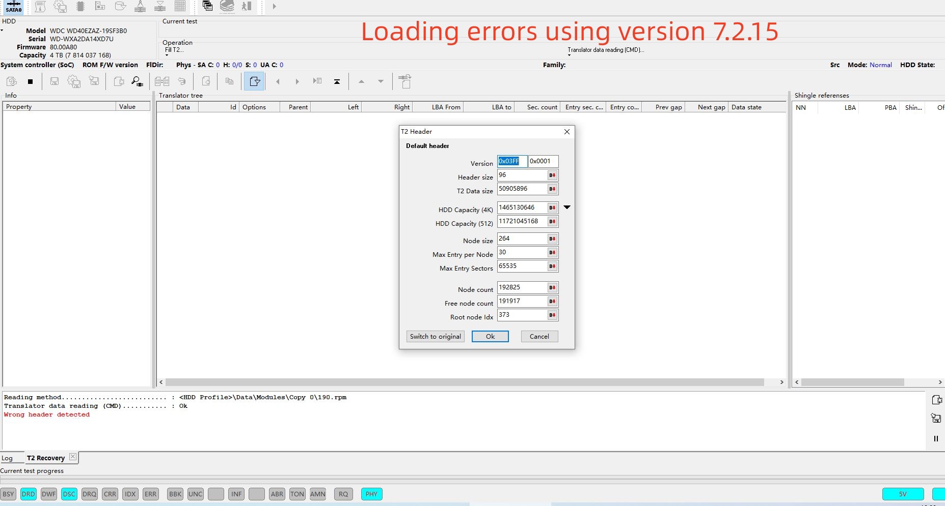

MODEL:WD40EZAZ-19SF3B0
Family: Venice
PCB:810011

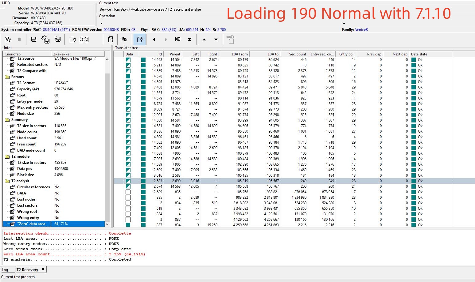

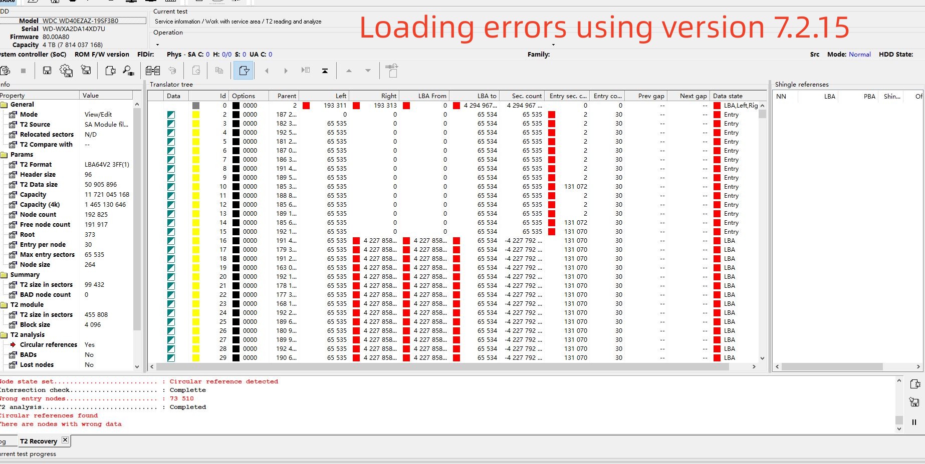

This is a good hard disk. I used the PC3000-UDMAE - 7.1.10 version to load and parse the 190 module, and everything was OK. However, if I used the latest version of 7.2.15, the following errors occurred during loading. The attachment contains the 190 module and logs.
thank you

Re: WD40EZAZ-19SF3B0 loading 190 error using 7.2.15
Postby ANURAG TIWARI » 19.03.23, 16:46
Yes I face same problem this version is bug
huangmiaofang
Posts: 23
Joined: 18.07.15
Reputation: 1 / (10)
Postby huangmiaofang » 06.04.23, 10:20
ANURAG TIWARI wrote:Source of the post Yes I face same problem this version is bug
This bug has been submitted for 4 months and has not been fixed. It will probably need to wait for version 7.3
