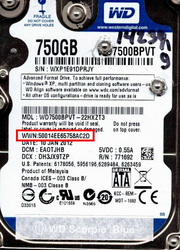

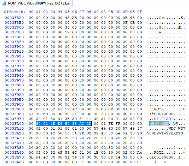

Hello guys. I have a question. Where i can see WD serial number if drive is not detecting? like as seagate you can check it and see on ROM to be sure that ROM is correct and not chancged by someone.

Search for the WWN (in hex) to verify it's the ROM for that drive.

LarrySabo wrote:Search for the WWN (in hex) to verify it's the ROM for that drive.
Thx. But where i can find this WWN? is it file or module?
LarrySabo
Posts: 37
Joined: 20.07.15
Re: WD
Postby LarrySabo » 20.02.19, 12:59
It's printed on the label.

sorry. i know where serial number on label. i mean if hard drive is not detecting how to compare whats on label and whats in SA. for example seagate you can compare the serial number what is on label and if you opening ROM in utility and there is the have button ID and it is shows you Model and serial number and capacity. have any options for WD hard drives?

Sorry, I don't understand what you don't understand. The label shows WWN (as well as serial, but the serial is not what I was talking about). I suggested you search ROM for that WWN number (in Hex). If you find it, that ROM belongs to that drive. That is what you asked in the OP.

LarrySabo wrote:Source of the post Sorry, I don't understand what you don't understand. The label shows WWN (as well as serial, but the serial is not what I was talking about). I suggested you search ROM for that WWN number (in Hex). If you find it, that ROM belongs to that drive. That is what you asked in the OP.
:D :D :D :D
can you show it for example in rom on picture?

Postby LarrySabo » 21.02.19, 13:25
Yes, I'll do that later today. Still having my morning coffee right now.

Postby LarrySabo » 21.02.19, 16:37
Here is a screenshot of the WWN in the ROM, which WWN also appears on the label of the WD drive from which the ROM was read.
WWN in ROM.jpg (17.36 KiB) Viewed 28685 times
#14239 label.jpg (16.4 KiB) Viewed 28685 times
