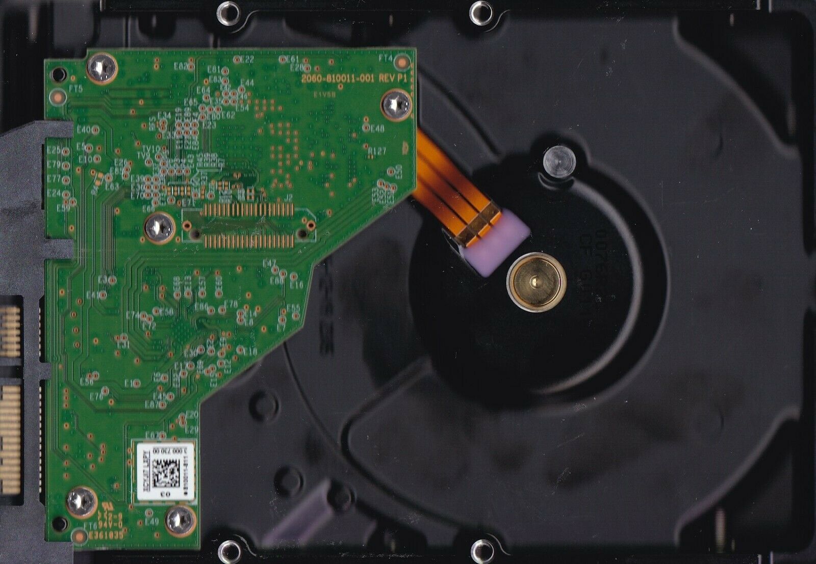

Which family should I choose for the new drive
WD80EZAZ-11TDBA0?
It is from bestbuy easystore 8TB, look like a Hitachi drive.
Thanks.

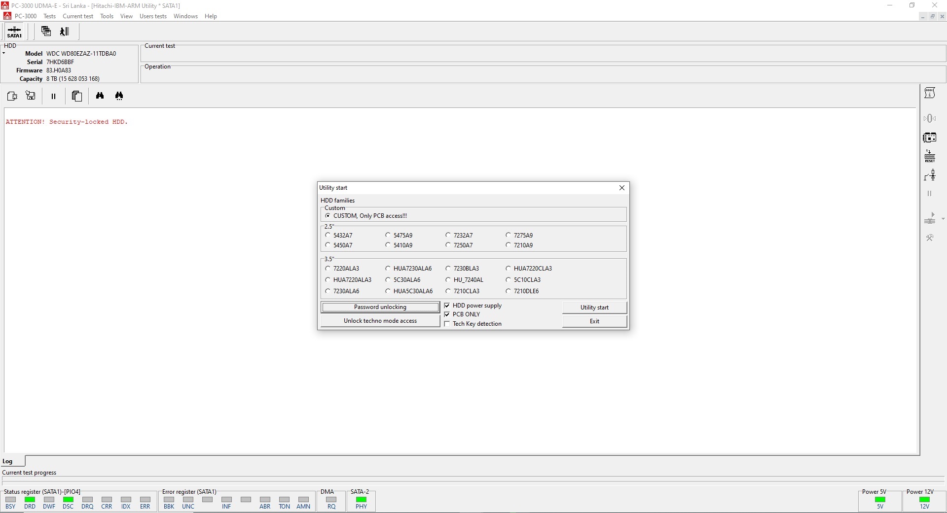

Hello Everyone,
I have same HDD,
Hitachi utility showing " security-locked hdd "
having any solution for this ?

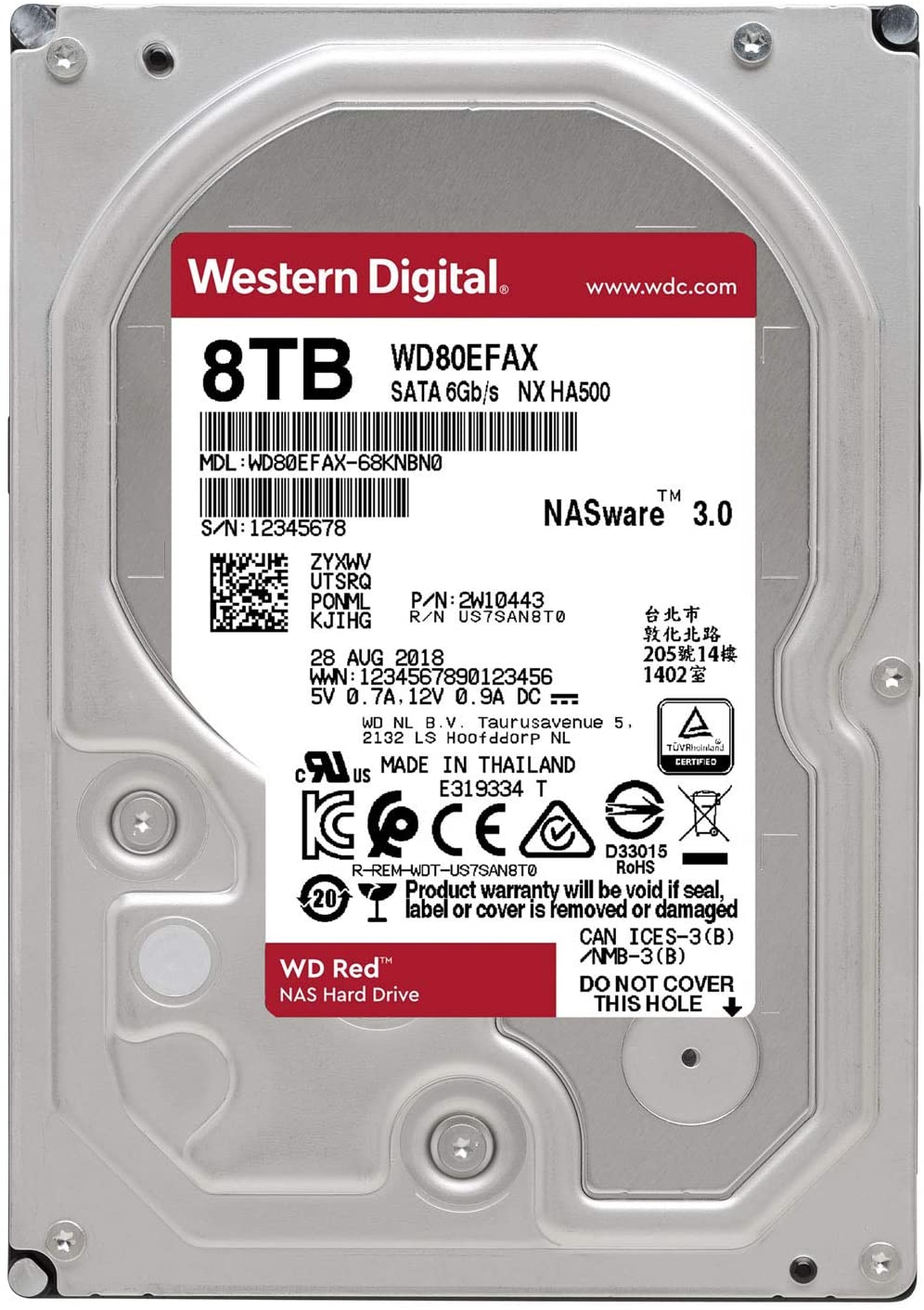

How about this one, WD80EFAX?
It looks like a Hitachi, too, with similar cover, but manufactured early in 2018.
Thank.
Phil
northwind
Posts: 147
Joined: 14.06.11
Re: Which family should I choose for the new WD drive wd80edaz?
Postby northwind » 14.12.20, 09:32
That's a Hitachi as well.
