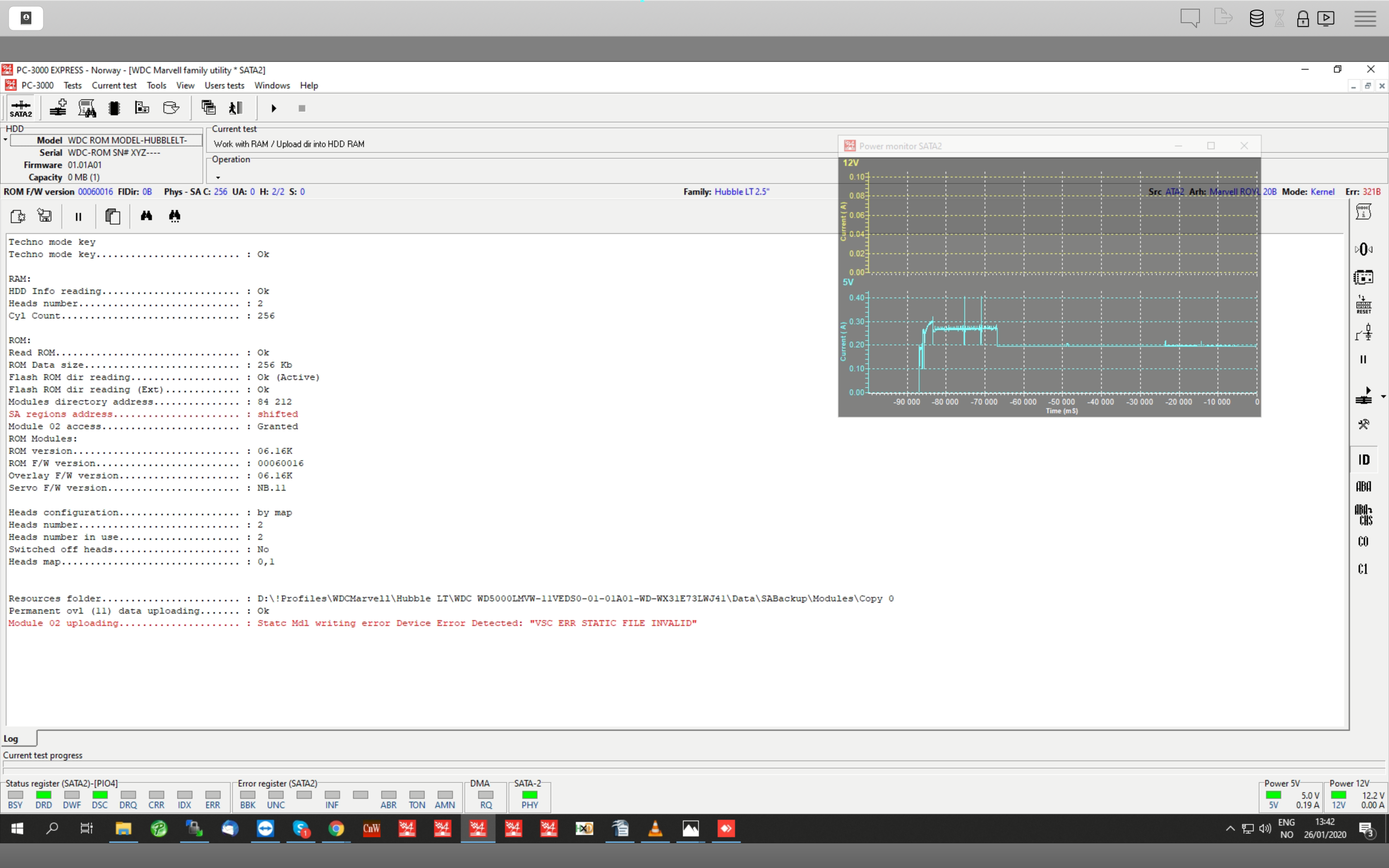

Hello. im working on a WD wd5000lmvw and when im trying to upload dir into ram i got error on modul 2
Pictures attatch.
Any advice for moving on..
Skjermbilde 2020-01-26 kl. 13.42.41.png (14.12 KiB) Viewed 6701 times

I presume you are trying to upload it from the drive?
If so, you need to find a donor, the original loader will not work.

d_d_recovery wrote:Source of the post I presume you are trying to upload it from the drive?
It is from the "load from file" from the hard drive when the hard drive was alive. I took a backup of SA. When I worked on it yesterday it works when I upload module 2 from file. But when i make imag of the hard drive it died, so today I cleaned my head. It starts up, but as mentioned, will not upload module 2.

Did you try a matching loader from a donor? ie not the original.

d_d_recovery wrote:Source of the post Did you try a matching loader from a donor? ie not the original.
Yes with same result.

Did you load the directory?
Re: WDC WD5000LMVW-11VEDS0 module 2 error
Postby AJ2008 » 27.01.20, 08:39
Upload DIR and LDR without 02, restart in normal and check SA - maybe module 02 is damaged

Freakazoid wrote:Source of the post But when i make imag of the hard drive it died, so today I cleaned my head. It starts up, but as mentioned, will not upload module 2.
So the heads failed while imaging the drive?
So you just cleaned them and put them back in?
Have you tried donor heads?
I will see if i have any more donor drive for swap head and see what happen.
