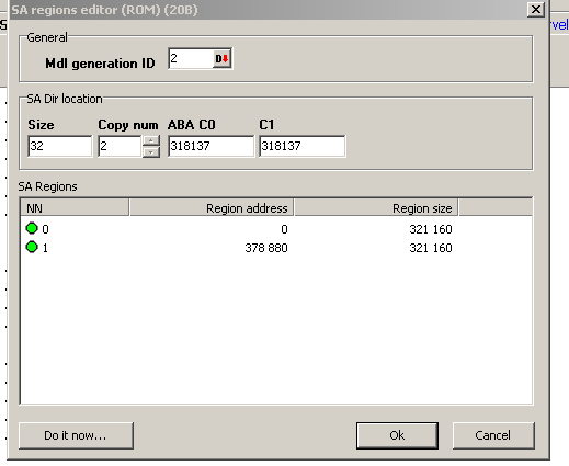

at step No. 2 i notice my WD 2.5" 2TB drive should have 8 heads,
but my PC3000 screen shows only 2 rows of address.

Try to set the region 1 address instead of 0 in region 0 address first in ROM. Restart the drive.
Then try to upload the loader into RAM, get SA access, and solve the Slow Responding problem once again.
