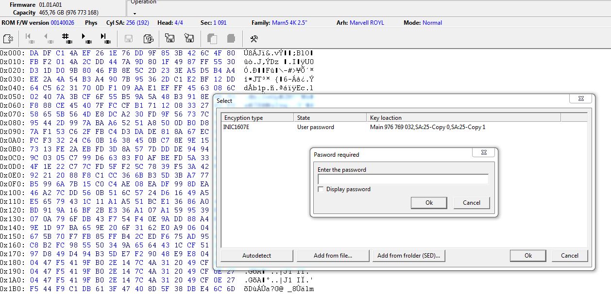

who can help me to solve this Password Problem??

Easy...ask the client for the password.

never set any Password...

Are you able to fully clone the drive without read errors?

I think what Luke's suggesting is that the key sector near the end might not have been read properly. I've had at least one case where that sector was bad.

goooz, try to solve the Slow Responding, then connect the original USB PCB. If it also requires the password, it's the bug of INIC1607E and it can not be solved.
Such bug puts some LBA from user area to key module.

Dear Maxim, i have to disagree with you here, but IT IS POSSIBLE and CAN BE SOLVED.

Dear einstein9, I've heard about the donor modules for such cases, but never tried this method since I have no such cases here last month.
As soon I try it, I will let you know.
