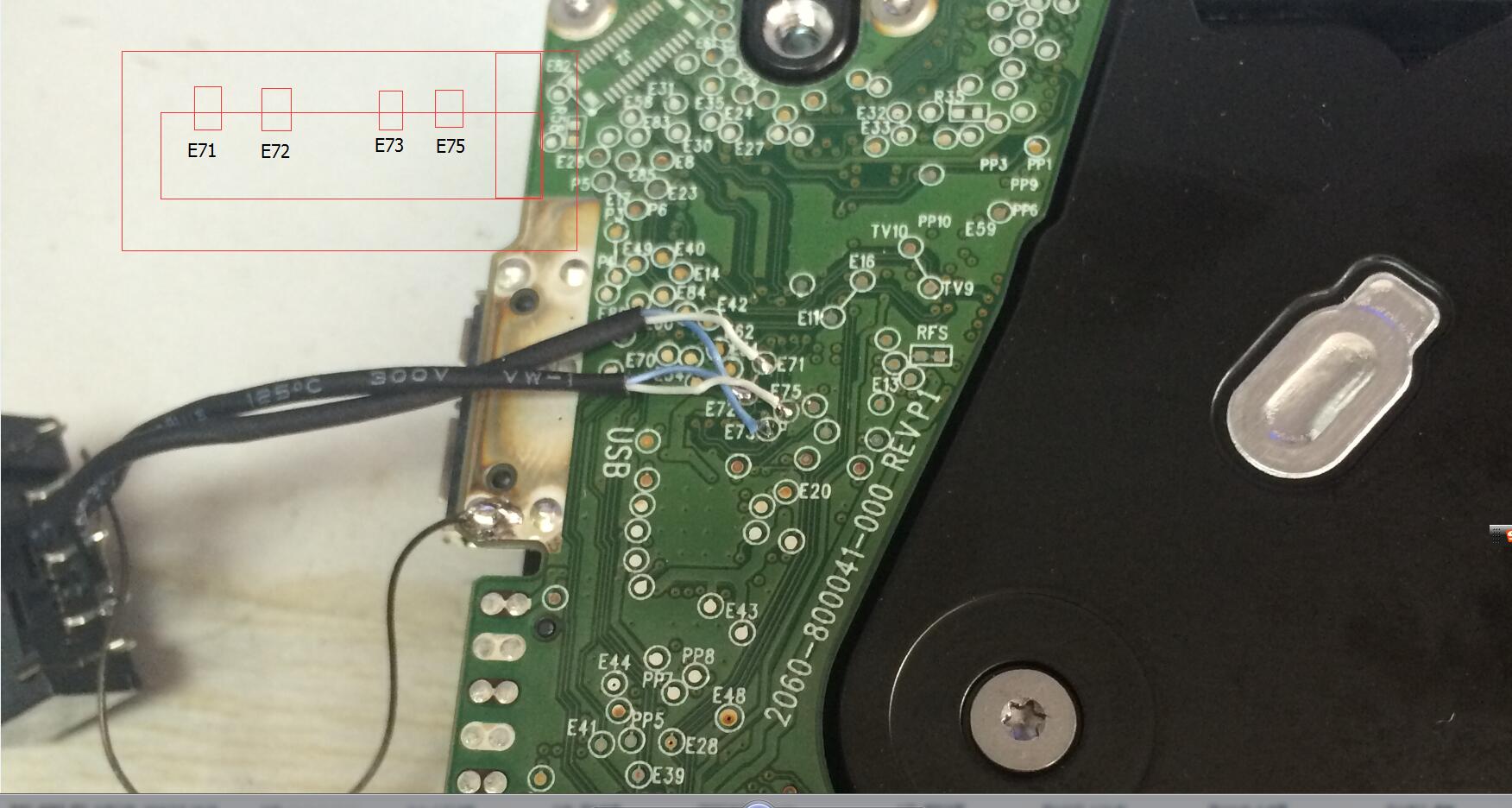

Hello everyone
I have encountered a similar case, has passed USB TO SATA success, the following is a modified schematic reference!
