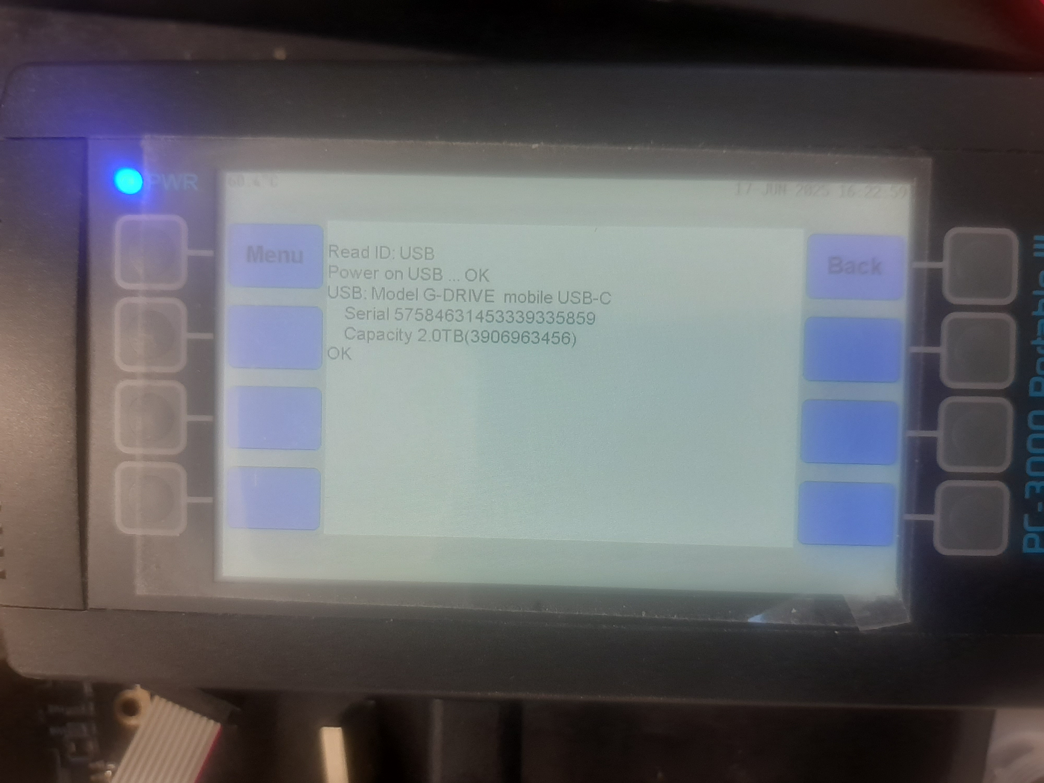

hello suddenly i got this error on the pc-3000 III portable
i reinstalled ,restarted the pc,updated the usb driver . but same! it wont recognize any USB HDD of western digital ...... windows sees the hdd and the hdd is recognized in diagnostic mode! please help

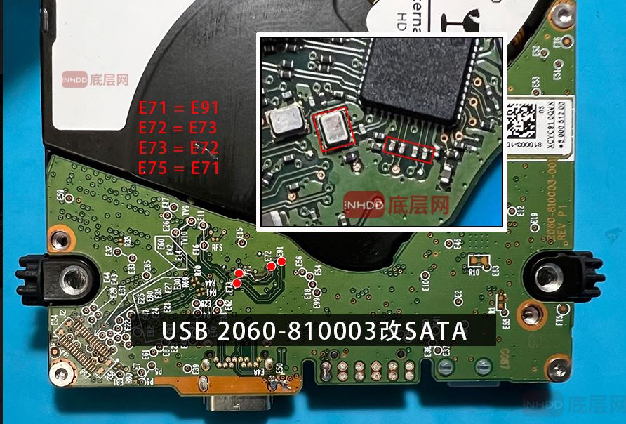

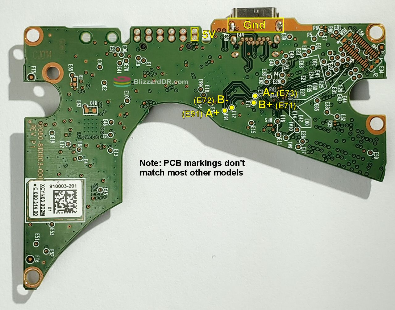

thank you for the answer Sir. i dont know which wiring is the correct for my PCB
i found two different wiring on the web but im confused...can you tell me which one is the correct?
Re: ERROR 'PCWDCM~1.DLL help me please
Postby digitalsupport » 20.06.25, 12:34
Both pictures shows the same
