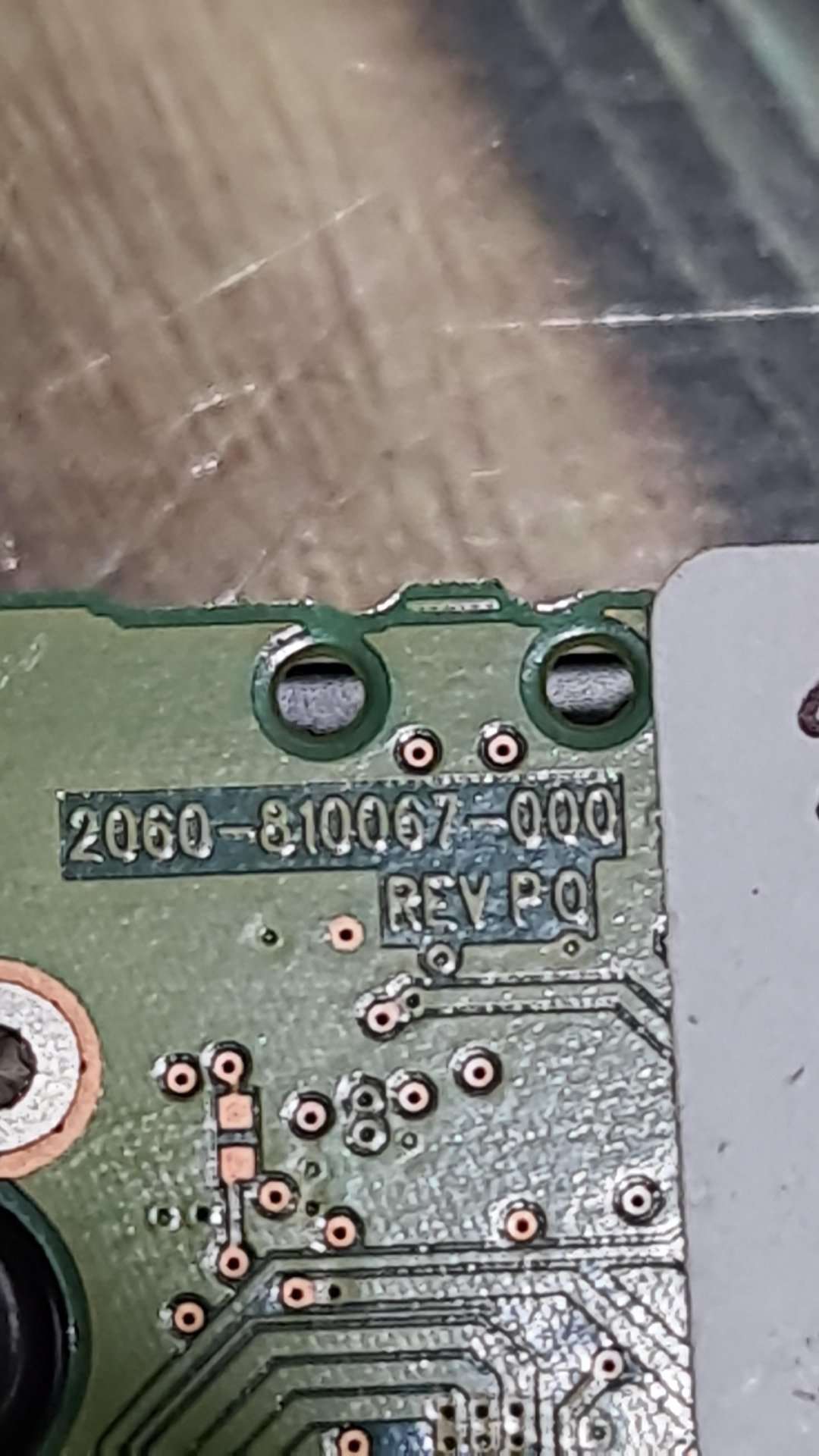

Does the PC-3000 support 810067 without changing the SATA unlock pcb?
Postby jinarto » 08.03.23, 08:54
Hello, anyone know about :
Does the 3000 PC software support 810067 without changing the SATA unlock pcb?

Re: Does the PC-3000 support 810067 without changing the SATA unlock pcb?
Postby anekakeck » 09.03.23, 16:17
HI
Yes, Sypglass 3 is supported f you have the version update 7 onwards.. read ROM, then patch ROM (Unlock SED HDD) in utility. Save unlocked ROM and write back with the Pogo pins.
Postby gterry » 27.06.23, 18:45
Does anyone know what the compatible SATA PCB is for this one? Thanks, Glen
Postby digitalsupport » 05.07.23, 16:11
gterry wrote:Source of the post Does anyone know what the compatible SATA PCB is for this one? Thanks, Glen
SpyGlass 3 uses MCU encryption, you need to connect SATA to original USB pcb.
Postby fastec » 22.10.23, 11:38
The correct reply is:
SATA compatible board is the 810030, this is handy to working with the SA without using the soldered wires on the original USB board
in either the cases you need to read the USB board's original ROM, obviously is faster to read the ROM and write it through PC-3000 utilities facilitation
then again with PC-3000 utilities you will create the unlocked version of the ROM
and because of MCU encryption you must then use the unlocked version of the ROM to write it in the original USB board
and solder the wires to have 100% control of the drive and get the decrypted content
Well, it all depends on how fast is for you in the operation of soldering the wires and how handy is for you to read/write the ROM with the aid of those gigs that allows to read/write the ROM without unsolder it
