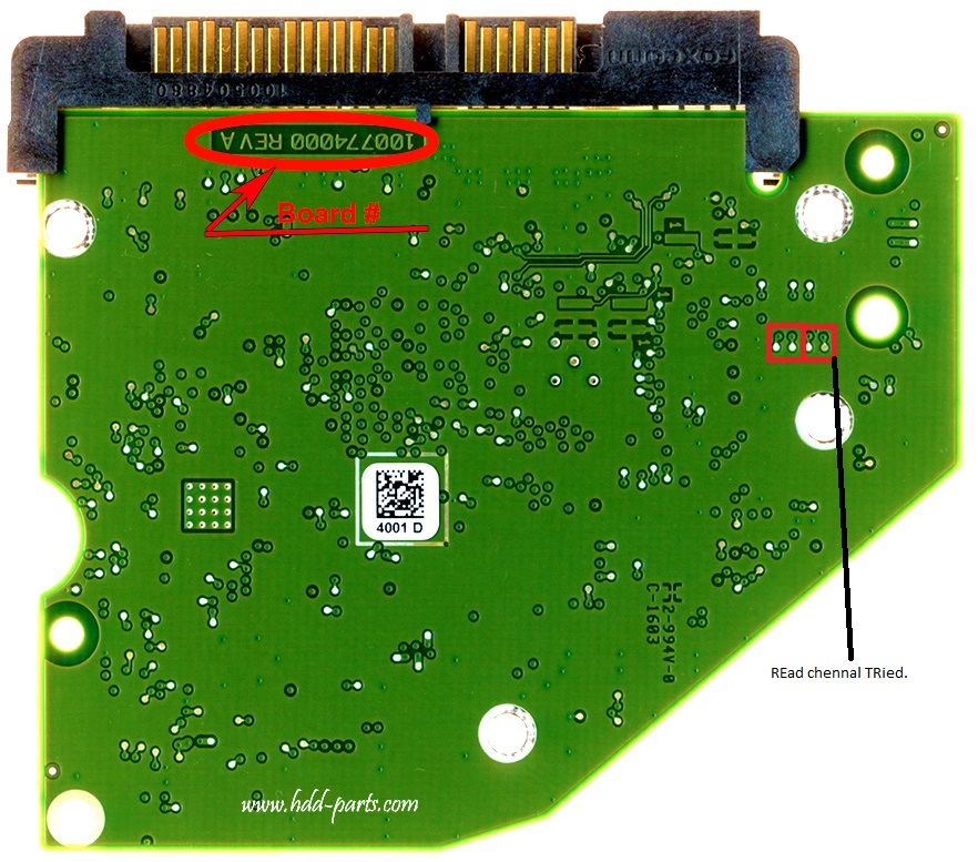

Re: Seagate Pharoah_oasis st500dm009 error LED:0x000000EE FAddr:0x003211FC
Postby Hemendra » 06.07.18, 09:18
I have attached the Images of pcb.
I have assume two point for the read channel. and tried both the points but can not success to get Terminal Port T>.
is any suggestion? How to get the T>?

SGdata
Posts: 108
Joined: 24.11.16
Reputation: 4 / (35)
Postby SGdata » 06.07.18, 10:28
Did you unlock it? If i remember corectly they have locked terminal.
Hemendra
Posts: 44
Joined: 20.01.15
Reputation: 2 / (15)
Postby Hemendra » 11.07.18, 06:36
SGdata wrote:Source of the post Did you unlock it? If i remember corectly they have locked terminal.
Yes I have tried with unlock also.
Generally The locked hdd gets the Terminal prompt T>. After that if you send any command it gives error like "diagnostic port is locked"
In My case I can't get the Terminal prompt T>. The LED Error coming continuously.
