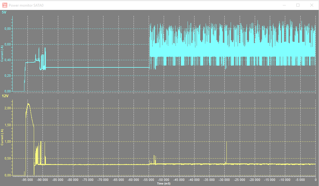

But I noticed the following when looking at the power monitor:
Looks very similar to the "3.5? ST2000DM001 (Grenada). With Voltage Graph. Weak head" in this article: http://blog.acelab.eu.com/pc-3000-p ... ision.html
