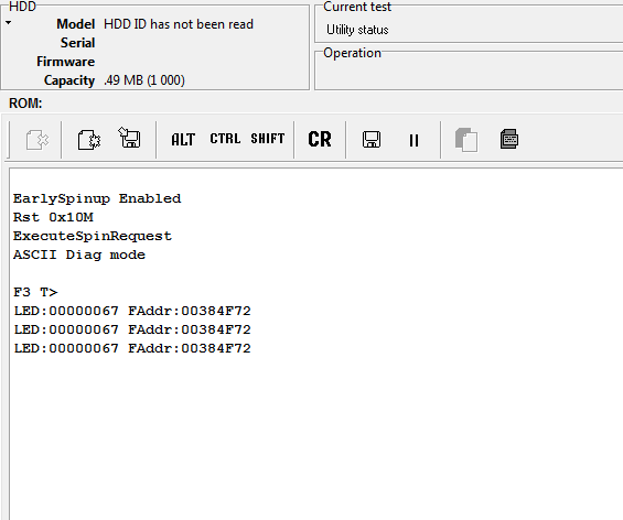

with loader or without when terminal start
it just show
Rst 0x10M
then
LED:00000067 FAddr:00384F72
try loader and without
and try with pcb only
shorting tweezers or not
try to apply this topic http://blog.acelab.eu.com/pc-3000-h ... #more-1912
but no new
will wait reply

Hi ,
How is the drive behaving keeps spinning ,knocking spin down at least give some details please

yes keeps spinning and tried to spin down with no result

Sir ,
What you mean by " tried to spin down " .You are contradicting yourself

I think he means that he tried to issue a spindown command, and it didn't take.
