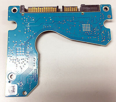

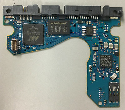

ST2000LM007 (100790701) PCB SHORTENING POINTS
ddcywf
Posts: 25
Joined: 23.08.16
Postby ddcywf » 18.09.19, 09:21
Kindly help in finding the ST2000LM007 (100790701) PCB shortening points.. thanks
