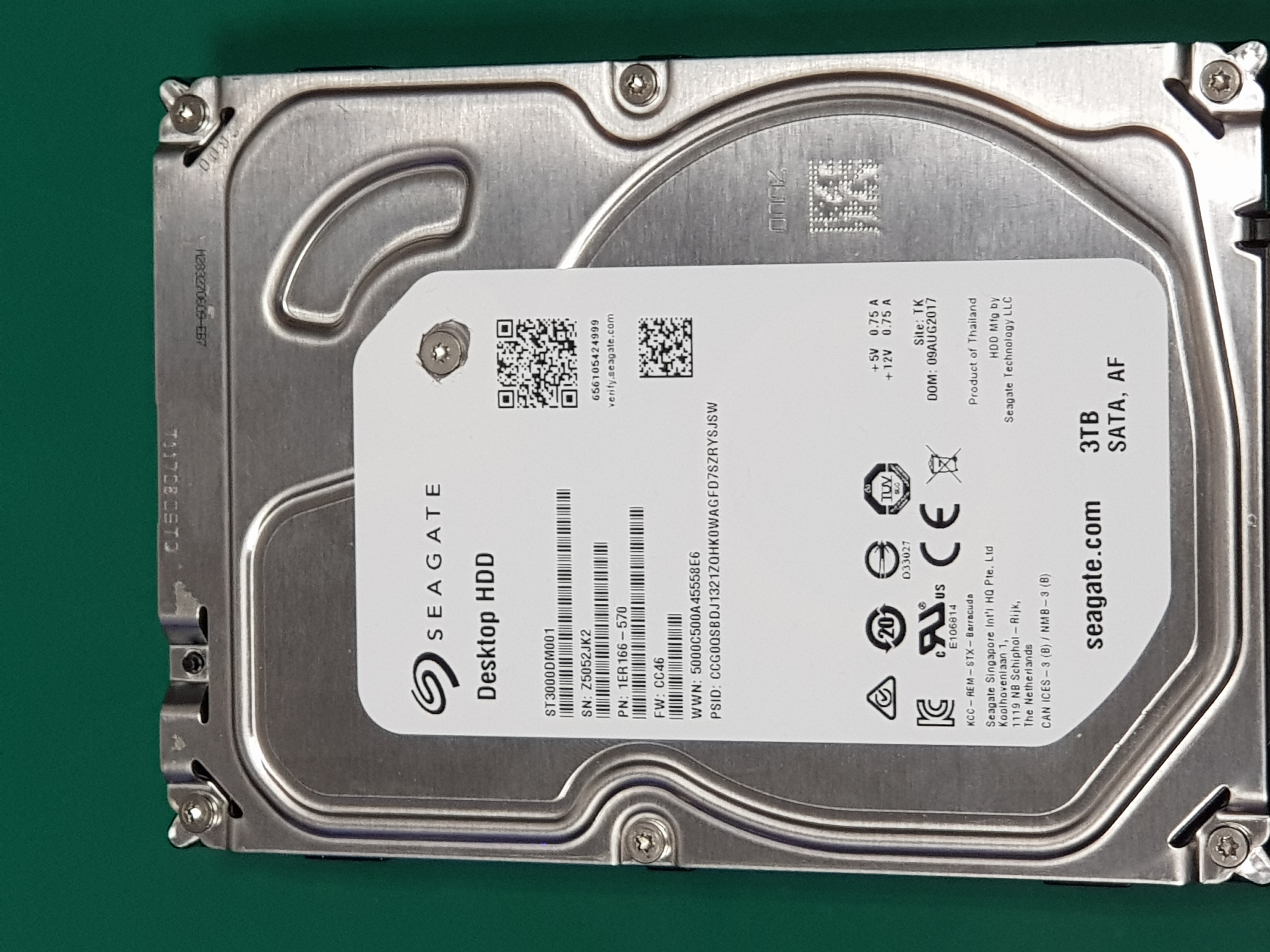

Got a picture of the top cover?

lcoughey wrote:Source of the post Got a picture of the top cover?
This is the HDD
Thanks for your help

Matching the model and first 3 digits of SN, I have 2 listed here:
