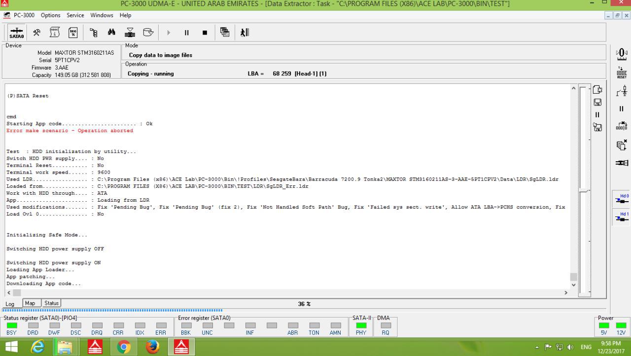

hi
i have a h.d.d
Model : MAXTOR STM3160211AS
Serial : 5PT1CPV2
Firmware : 3.AAE
Capacity : 149.05 GB (312 581 808)
this h.d.d id ok
but when in DE very very slow sector read
and output terminal is :
Failed sys sect. write! Nwt Er 7b RdWriwot: 97f29ff7 b6 97f29ff7.0.88f 0000 005f 0000 006a
DiskAccess ReadSector EC=43 at 001696.00.0482
CE Log ErrCode=43 LBA=f5484a Type=5Failed sys sect. write! Nwt Er 7b RdWr 1614d.01.0059
and read any sector output terminal :
CE Log ErrCode=43 LBA=f5484b Type=6aFailed sys sect. write! Nwt Er 7b RdWr 1614d.01.0059
AT Er 00 Nwt Er 43 RdWr 01697.00.03ab
ATA St 50 Er 00 Op 24 e, 0000000,0100 0000 0000
Niwot: 97f29ff7 b6 97f29ff7.0.97c 0000 005f 0000 0000
DiskAccess ReadSector EC=43 at 001697.00.03ab
CE Log ErrCode=43 LBA=f54ce4 Type=5Failed sys sect. write! Nwt Er 7b RdWr 1614d.01.0059
CE Log ErrCode=43 LBA=f54939 Type=6aFailed sys sect. write! Nwt Er 7b RdWr 1614d.01.0059
AT Er 00 Nwt Er 43 RdWr 01698.00.02d3
Niwot: 97f29ff7 b6 97f29ff7.0.97c 0000 005f 0000 006a
DiskAccess ReadSector EC=43 at 001698.00.02d3
thanks :roll:

Please Follow The Guide Here -> http://blog.acelab.eu.com/how-to-fi ... rives.html

Postby sepid » 21.12.17, 16:59
I've done all the steps
Unfortunately, it does not answer
Nick_TS
Posts: 300
Joined: 01.04.13
Reputation: 8 / (78)
Re: not sector read
Postby Nick_TS » 22.12.17, 20:44
Did you create a loader with full SA set or App code only?
sepid
Posts: 80
Joined: 29.10.13
Reputation: 2 / (22)
Re: not sector read
Postby sepid » 22.12.17, 21:28
hi dmitriy
I've done precisely the steps in the blog
any read sector h.d.d bsy and
Re: not sector read
Postby AJ2008 » 28.12.17, 14:06
sometimes HDD takes longer to reach ready than utility is expecting - does it eventually come DSC DRDY after a few minutes after any errors? what does terminal log look like once it has failed to complete?
also, baud rate you are using is very slow. You can often increase this to maximum with no poor consequences and this will allow you to work much faster.
