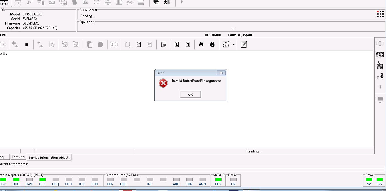

Though Solution is not in sight . Disk is still going very slow. I cant access system files as I am getting Invalid buffer from file error (while accessing SMP flags for clearing)
What this error indicates and how should I tackle it ?

I checked file 8F I have cleared SMP flags and saved file ,but that has not improves situation.
