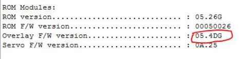

In kernel mode, look at overlay version of ROM as in picture I add here

I checked my database, all entries with 65000U ROM have Overlay F/W version 65.0UE.
One suggestion that could work is to back up patient ROM (always backup first) then write 65000U ROM from one of the resources listed here, then use 65000U loader to get SA access. From here you should be able to get native loader read from surface (hopefully), at the very least back up adaptive modules to reach data in other ways.
