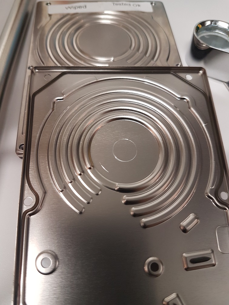

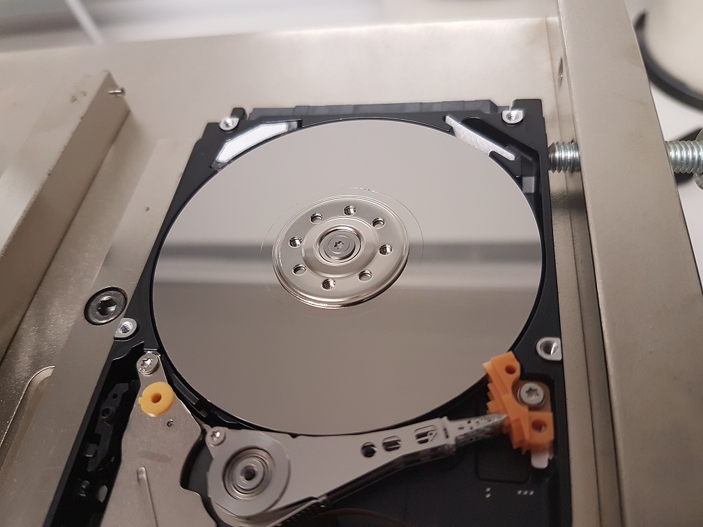

Also when the Surface is scratched only in the middle...? :?
See the pics...
Surface
HDD Cover
Re: Toshiba MK5072GSX scratched Surface
Postby AJ2008 » 08.10.18, 08:58
top surface is surface '0' and as far as I am aware you need this surface to be OK to initialize it. As most SA is stored in PCB, maybe you can place patient PCB on donor to init donor PCB, then hotswap it to your patient and try reading? Not sure this will work though but I do not think you have many options available...

AJ2008, but what about original P-list (DD)...? :?
I agree this is a problem... :?
