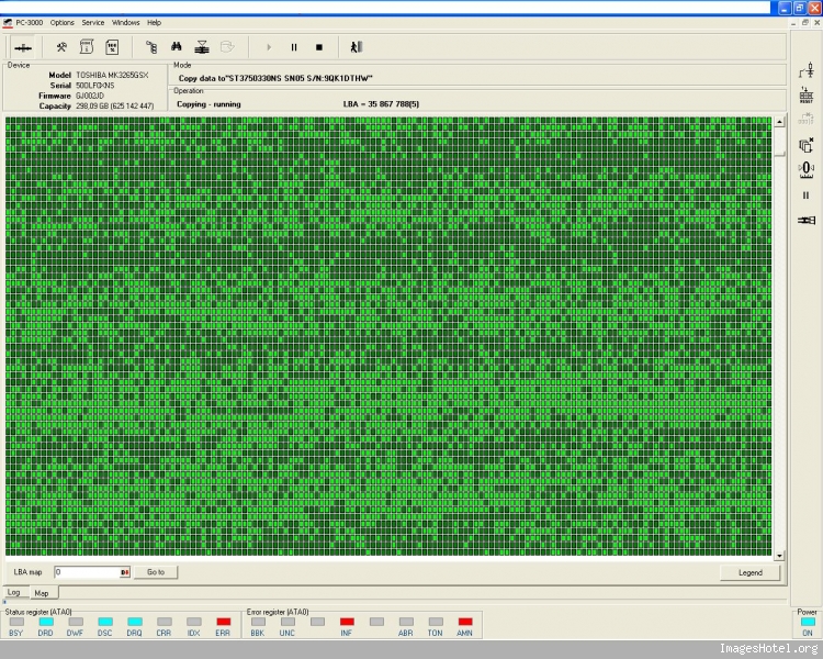

I have patient Toshiba MK3265GSX.
When power on the drive calibrate slowly, but good drive ID and I can build head map on DE.
When I try to copy data, I have read error (I try on many part of surface).
I changed head with same result
I changed PCBA + FW with same result
I clear Glist but same result
Anyone can help me?

I think it's not bearing problem, but I'll try later if no result soon.
Now I can read some sector.
I must start Toshiba Utility for that ("Other SATA")
I can read in all mode (UDMA33, 66 and HW retries) but with many many bad bloc (reading with CRC error) on full surface.
When I restart copy I can read more good sector (green status change)
For exemple I need 10 pass for have 256 good sector and reading slowly ...
I try with reading retries but need restart scan for good result.
I try with different timeout and delay but always the same result.
Any Idea

Thanks for your help !
I already try to increase timeout (and many other parameters) and clear Glist but never good result.
I realised map from alterate MFT and I can read some important file with many retries !
