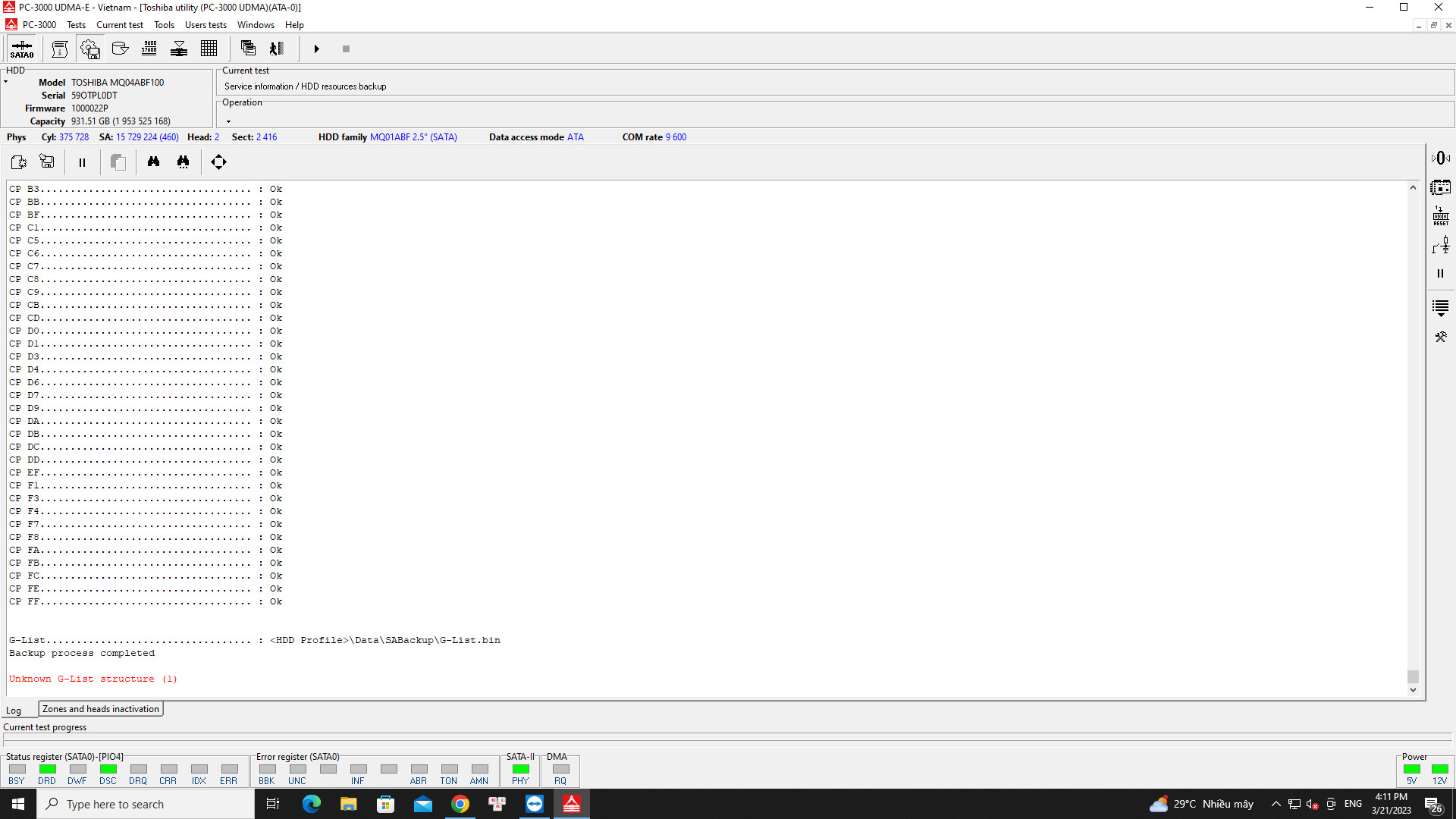

I have a Toshiba 2.5 Drive 1TB
The ID read normal
Got 9 Defects in G-list
All backups was run well

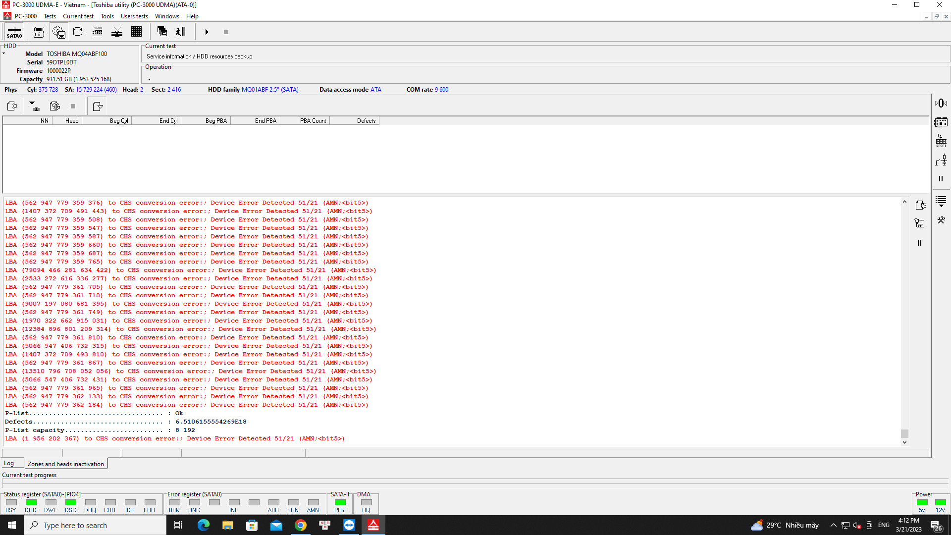

But i cannot get to Data Extract
In Data Extraction shows LBA errors
Can somebody help. Thanks!
