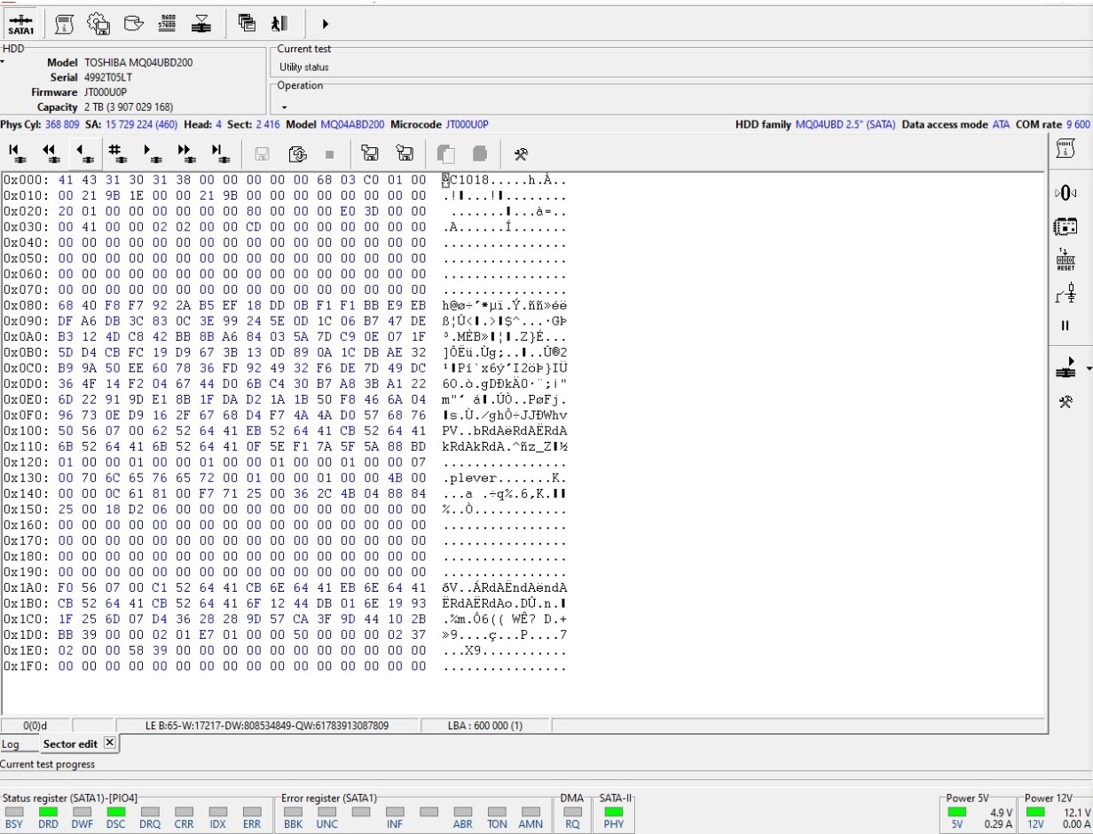

1. I received a drive Toshiba MQ04UBD200 (USB) clicking
2. Change heads with a donnor.
3. Change PCB with a compatible one G4311A and I program the chip with a ROM programmer.
4. Drive was not clicking and PC3000 detected and read fast.
5. Made a HDD Resources Backup.
6. With Sector edit I could read the LBA 600.000 (Image 1): (https://drive.google.com/file/d/16QvtmC ... sp=sharing)
7. I could see the structure folder.
8. Turn off drive.

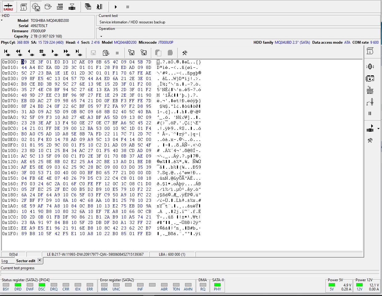

PROBLEM: :shockable:
9. I disconnected the drive and after a while I connected again and now I cannot see the folder structure :cry:
10. Change heads again with a brand new donnor (though was heads damaged), but same behaivor, cannot see the folder structure.
PLEASE Help me to understand this :umnik: :
With sector edit I read the LBA 600.000 (as before) and now the information is different (image2 after): https://drive.google.com/file/d/1GJ6fVE ... sp=sharing
Why the information I read with the same sector edit is different?
Thank you :thumbup:
Image1 Before.jpg (285.33 KiB) Viewed 25899 times
Image2 After.jpg (10.52 KiB) Viewed 25899 times

Postby AJ2008 » 22.03.21, 10:08
Are you reading sectors normally or using utility read option?

AJ2008 wrote:Source of the post Are you reading sectors normally or using utility read option?
Yes both times, after turn on and detected by pc3000 the Toshiba got AMN error, so read with utility in sector edit. Same procedure.
Maybe do you know why the information is different? (same drive, same procedure, same LBA), I cannot understand what I am not looking :shockable:
