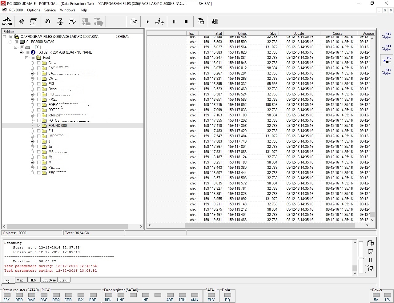

I'm working on a Toshiba 2,5" that needed to swap heads.
Heads were swapped, could read all from heads 0,1 and 3 and head 2 struggled a lot to read.
But my problem is that a folder called FOUND.000 have many CHK files inside as you can see in the picture.
From this 2 things troubles me:
1º why do I have these CHK files with this date (09-12-2016), if I started imaging some days before the date of the files?
2º I made a disk to disk image. This shouldn't let the drive write files on patient, right? So why are they there??

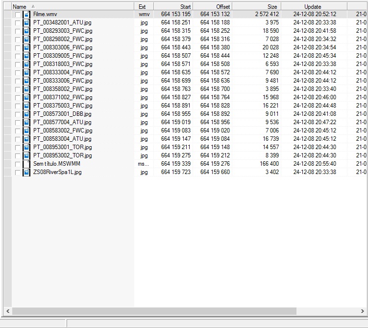

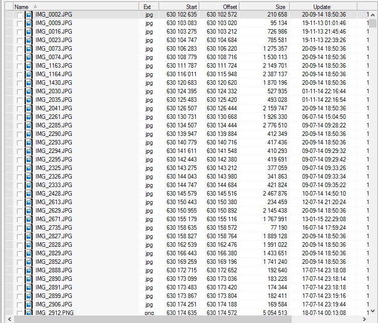

Here are another 2 PS...
On these you can see the date is day-month-year. So the other folder also should be the same, right?

Hi, pclab
Folder called FOUND.000 are created after running CHKDSK. Each *.chk file contains recovered lost cluster chains which might get lost when file operations are interrupted abnormally.
For example, in the case of an USB flash drive, that might happen when you physically unplug the device before "Safely Removing Hardware" (actually, before the OS has finished writing cached data to the medium).
A single .CHK file may contain
So if customer didn't say that something important is missed you can forgot about *.chk files.
If some files are missed you can try to build a map of all *.chk files and run RAW recovery or GREP at this map.
As for dates, PC-3000 Data Extractor uses Day-Month-Year format. So 09-12-2016 is December 9th.
By default Data Extractor is definetely not writing any information on the destination drive and of course not running CHKDSK itself

Re: CHK Files
Actually, there are some missing photos.
I might try a RAW on that folder (is it possible??)
As the data, it's not possible to be on th 9th. The drive was imaging during that day. So, how can it make "changes" to the date?
Re: CHK Files
Perhaps the customer's clock was set incorrectly, and used that date when it created the files.

Hello ,
Rename All .chk File As JPG and see if you find something
Re: CHK Files
LarrySabo wrote:Source of the post Perhaps the customer's clock was set incorrectly, and used that date when it created the files.
Larry is right, there could be simply wrong date at customer's clock

Re: CHK Files
Thanks 300ddr.
I have done what Pavel suggested and went great.
Got about 4.000 Jpegs extra.
