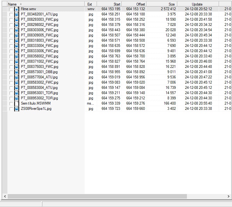

I'm working on a Toshiba 2,5" that needed to swap heads.
Heads were swapped, could read all from heads 0,1 and 3 and head 2 struggled a lot to read.
But my problem is that a folder called FOUND.000 have many CHK files inside as you can see in the picture.
From this 2 things troubles me:
1º why do I have these CHK files with this date (09-12-2016), if I started imaging some days before the date of the files?
2º I made a disk to disk image. This shouldn't let the drive write files on patient, right? So why are they there??

pclab

Hi Guys
I don't think so, that is 9th December, but I will check the other folders.

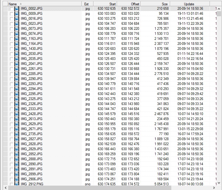

Re: CHK Files
Postby pclab » 13.12.16, 11:28
Here are another 2 PS...
On these you can see the date is day-month-year. So the other folder also should be the same, right?
