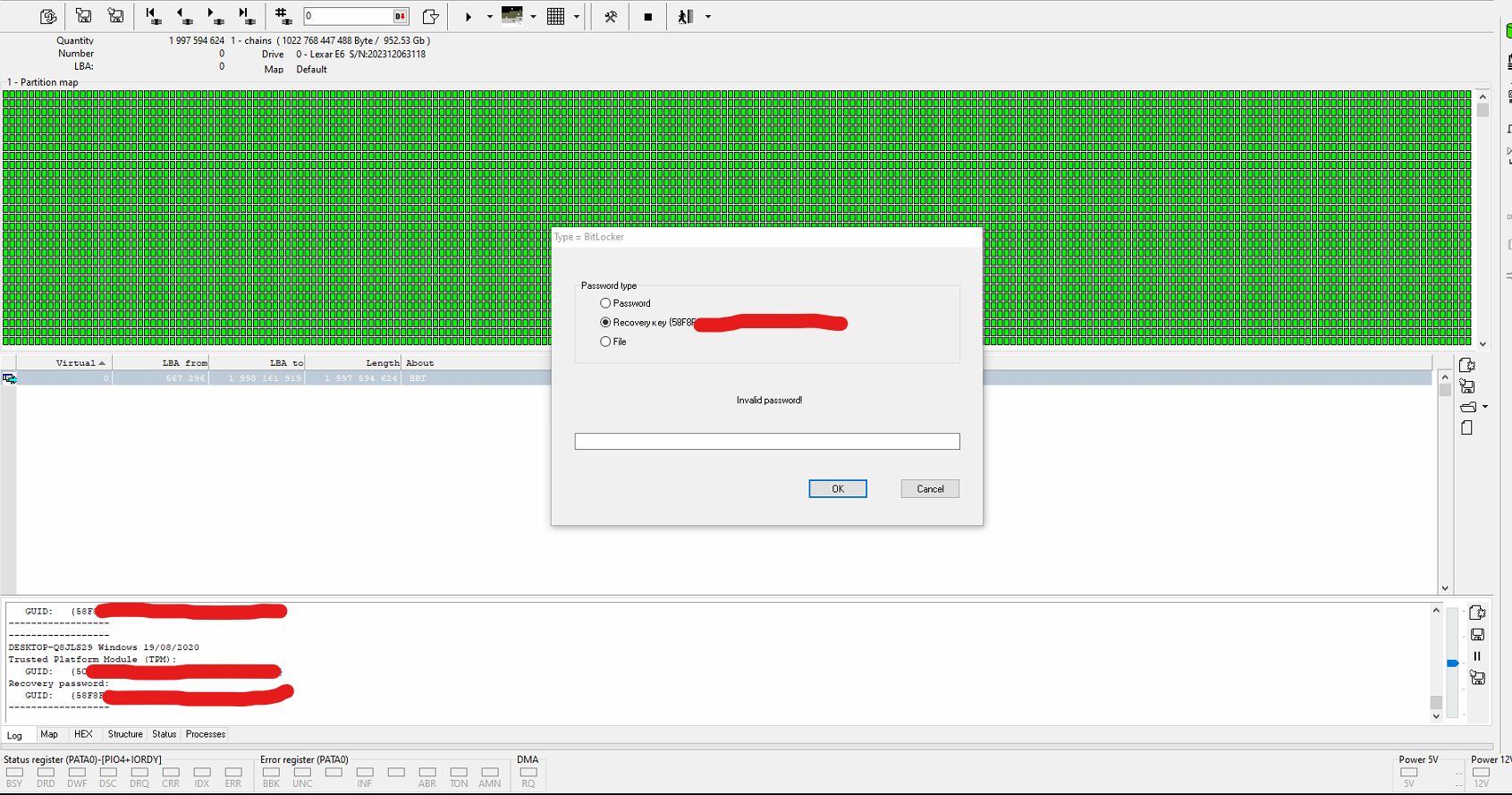

I have a strange case. I have an SSD drive that comes with bitlocker an i do have the Recovery Key. However i am unable to decrypt the Drive cause PC3K keeps saying it is invalid Password
however I tried mapping the drive and opening it in R-Studio the key fits perfectly and unlock like normal
Don't know what happened to PC3K decryption?
Screenshot 2025-04-02 084635.png (390.08 KiB) Viewed 5182 times

Following.
Had the same issue myself several times this week alone. PC3K saying invalid keys and password, but triple checked and is 100% the right keys and passwords. I did not have R-studio to try tho.

I have same problem with palmer drive .It shows bitlocker but has clear key .Like ufs strait away open drive but drive has bad sectors so i want to image it but de ask for keys .strange .

Just had another job, exact same issue, DE reporting key is invalid when it 100% is correct. Doesn't seem to matter what model of drive as I've had it with mechanicals and SSDs.
