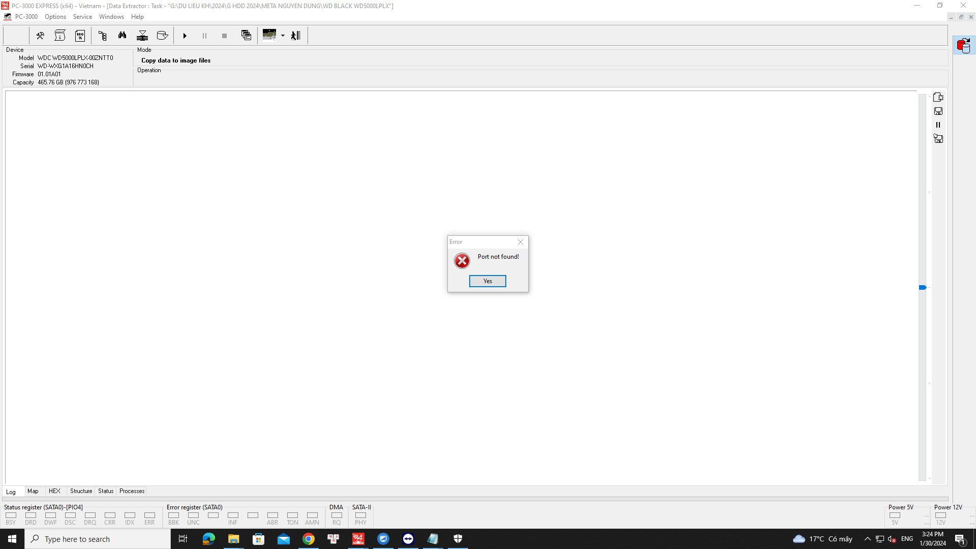

I have a case which I was working on PORT 1 of PC3000 Express.
Later that port got busy by another case
I changed the earlier case from PORT 1 to PORT 0 and got the error bellow
Port not found!
Is there any way that i can change the project to read data from other PORT???
Thank you!
Re: How to change Ports That the drive was working on??
Postby digitalsupport » 31.01.24, 14:28
Connect patient drive to the desired port.
When you open the task you can change port to current in the dialog
