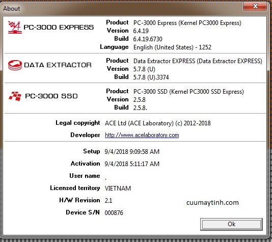

I have problems with DATA EXTRACTOR V 5.7.8
When I create the image. in the process of running a lot of times the process stops with the message.

Did you submit a support request with ACE to have them help troubleshoot?

I would recommend you to install the latest version of PC-3000 and repeat these steps on a new version.
