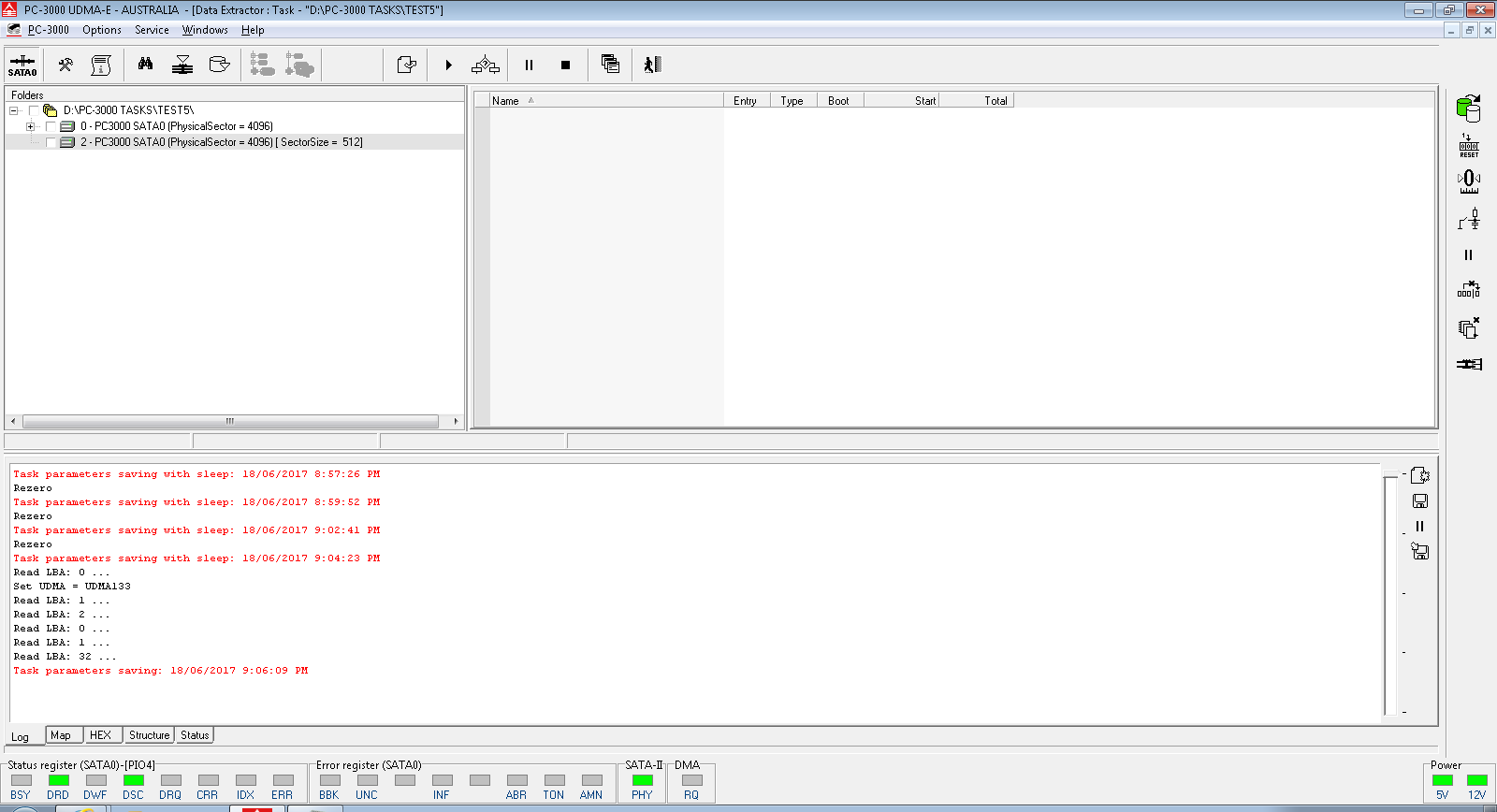

I noticed that sometimes the "Task parameters saving with sleep" stops working after performing certain actions, and only does "Task parameters saving" without putting the drive to sleep.
Example problem.png (40.84 KiB) Viewed 3744 times
For example (above), shows that "Task parameters saving with sleep" does not occur after clicking on the drive (2 - PC3000 SATA0 (PhysicalSector = 4096) [SectorSize = 512]).

I'm using PC-3000 UDMA (H/W Revision 2.1); however the problem went away when I upgraded to the following version:
Data Extractor Build: 5.6.8 (U).3359
So everything is working fine at the moment :)
